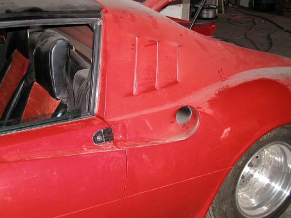

Mark did a fantastic job with the custom metal work. He welded (IMG:http://www.914world.com/bbs2/html/emoticons/welder.gif) on new front fenders and formed (IMG:http://www.914world.com/bbs2/html/emoticons/smash.gif) them ala John Kelly on-car technique. He (IMG:http://www.914world.com/bbs2/html/emoticons/sawzall-smiley.gif) and butt welded John's "big A$$" rear flares, yes pun. (IMG:http://www.914world.com/bbs2/html/emoticons/laugh.gif) He filled in all the DZUS , side marker and antenna holes. He extended the seal channel for the headlight delete hood. He also installed the Engman stiff kit and made the GT3 Recaro seat mount work. (IMG:http://www.914world.com/bbs2/html/emoticons/clap.gif)

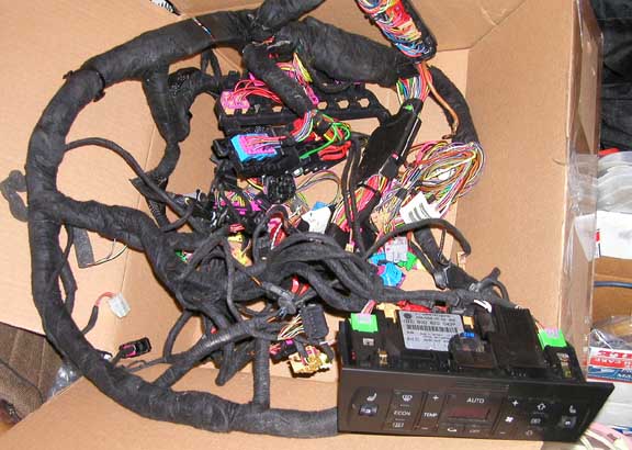

Got the internal wiring harness from one of Joao's wrecked A4's. The dash panel and climate control connect but I'll need to verify all of it with the wiring diagrams that I need to load on my laptop.
Got a climate module from the same car but turns out the housing is cracked. Dealer wants $600 for that plastic box. (IMG:http://www.914world.com/bbs2/html/emoticons/ohmy.gif) Another from a 99 A4 "should" fit as part numbers match. Thanks Craigslist

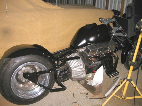

I found someone who can do some of my fiberglass work. Check out Mike's awesome V8 motorcycle. (IMG:http://www.914world.com/bbs2/html/emoticons/shocked[1].gif)
