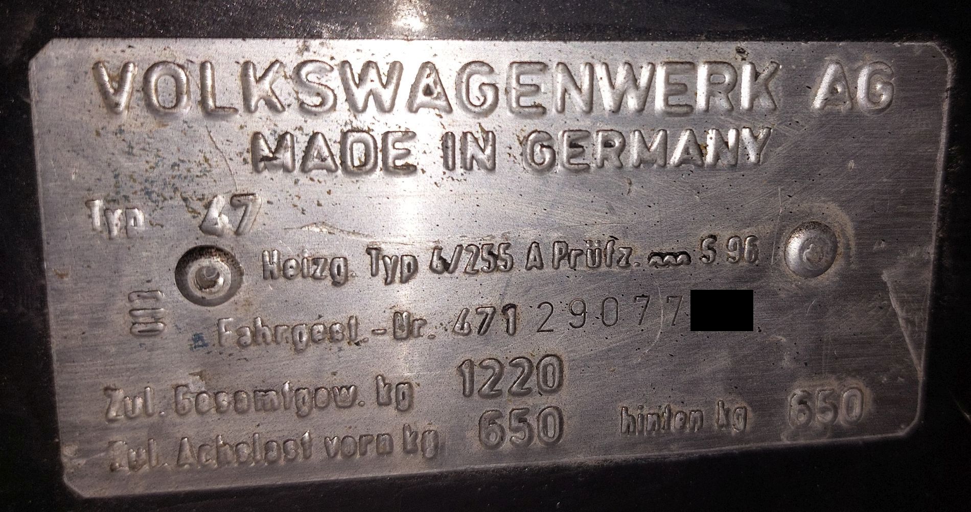

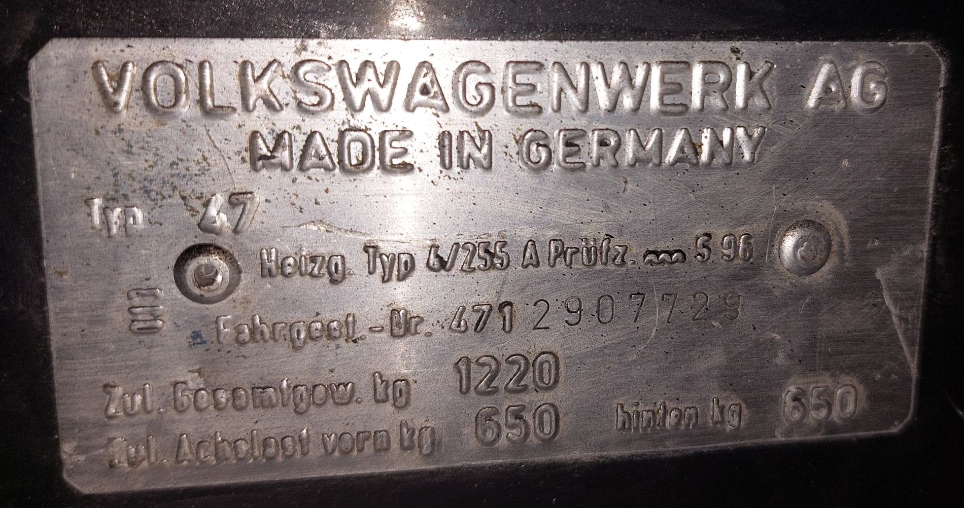

Gentlemen, can anyone give more information from my ID plate, please? I only know this is 1971 1.7L. There are no other plates or labels on my car and it´s repainted in black.
Thank you

It would be helpful to have the body number... Normally on a "Karmann" plate on the drivers side forward door jamb, which also has the original color number. If you say that plate is missing, you might also find the body number stamped into the sheet metal of the floor of the rear trunk under the carpet. It's not extremely visible, here's what mine looks like:
The body number can be decoded to find the date of maunfacture. Otherwise, with the complete VIN number (including the last numbers blacked out), maybe one of the historians can provide more info.

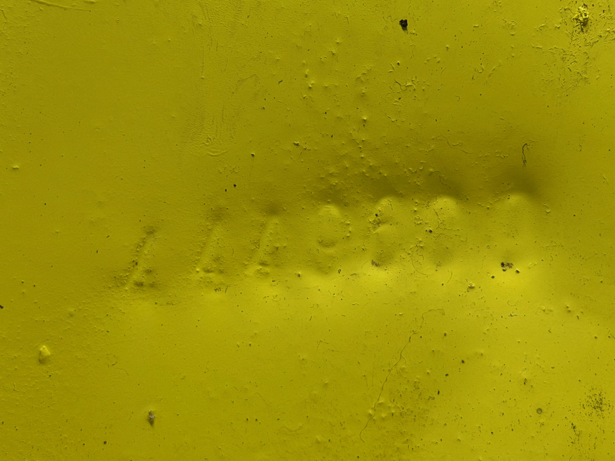

Fantastic! Thank you for your reply.
Yes. Unfortunately "Karmann" plate is gone. But I´ll try to locate the stamped body number.
I´m very sorry, wasn´t sure if posting full VIN number is a good practice here.
Here´s my full VIN if "historians" can do their magic.
