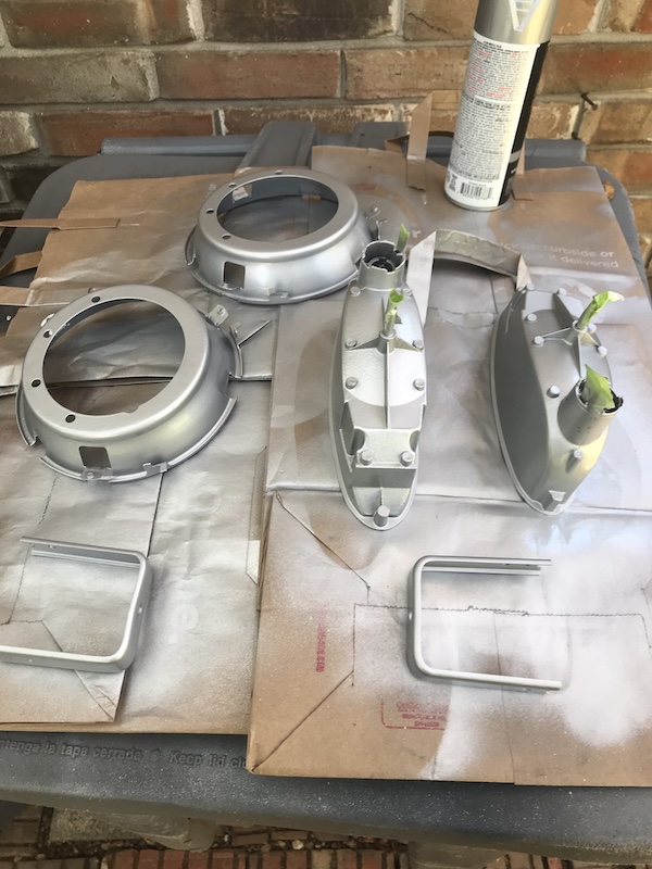

QUOTE(Geezer914 @ Dec 29 2025, 03:47 PM) *
I used chrome paint with good results.
Worked for me, too. Looks fine with the lens on it, light is excellent.

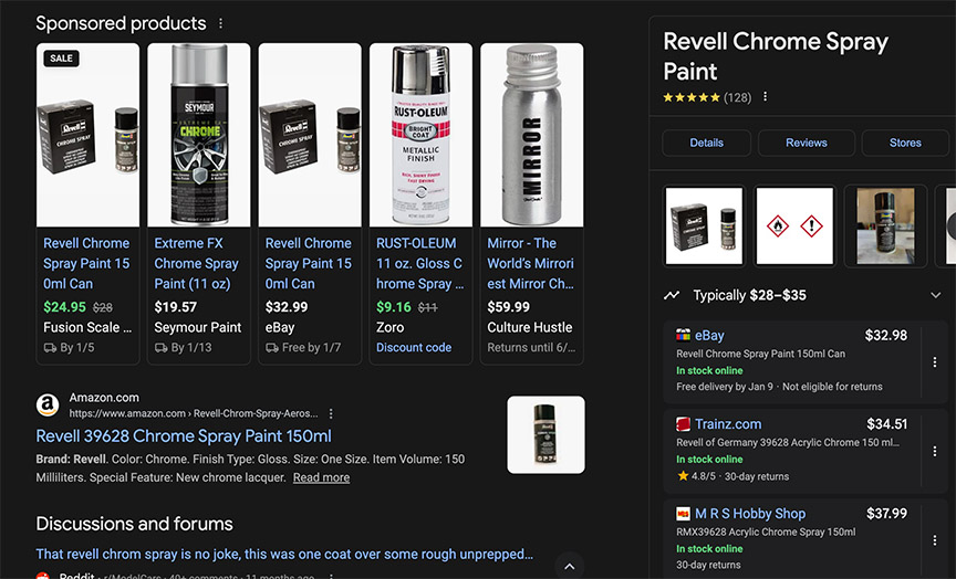

Revell Chrom Spray
Someone is using it on their 911 housings and it looks quite impressive.
Look over at early911sregistry under liquid chrome for pics. would post a link but don't know what i'm doing

I used silver spray paint with excellent results. I did it close to 15 years ago and the lights are bright and uniform.

Another vote for "chrome" spray paint. Not quite a mirror finish but very reflective, and enough to bounce light out through the red lens.

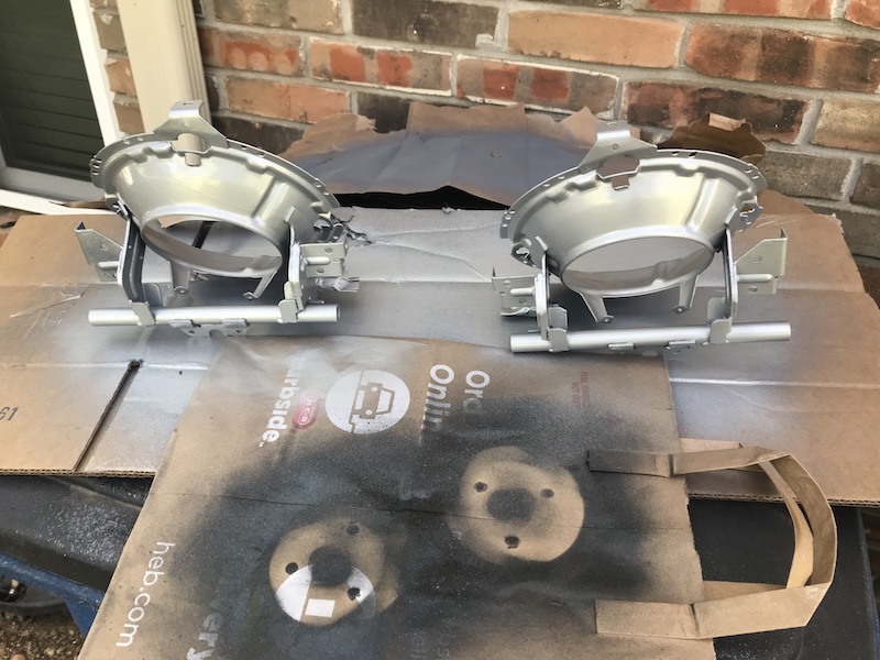

QUOTE(bajafreaks @ Dec 30 2025, 09:12 AM) *
Thanks for all the input, I'll give the chrome spray paint a try.
I think you'll be happy with the chrome metal spray. I used it on my tail light reflector assembly, my headlights, and other items, as well. Nice look IMO. You could hit with some clear to give even more gloss. Best of luck!

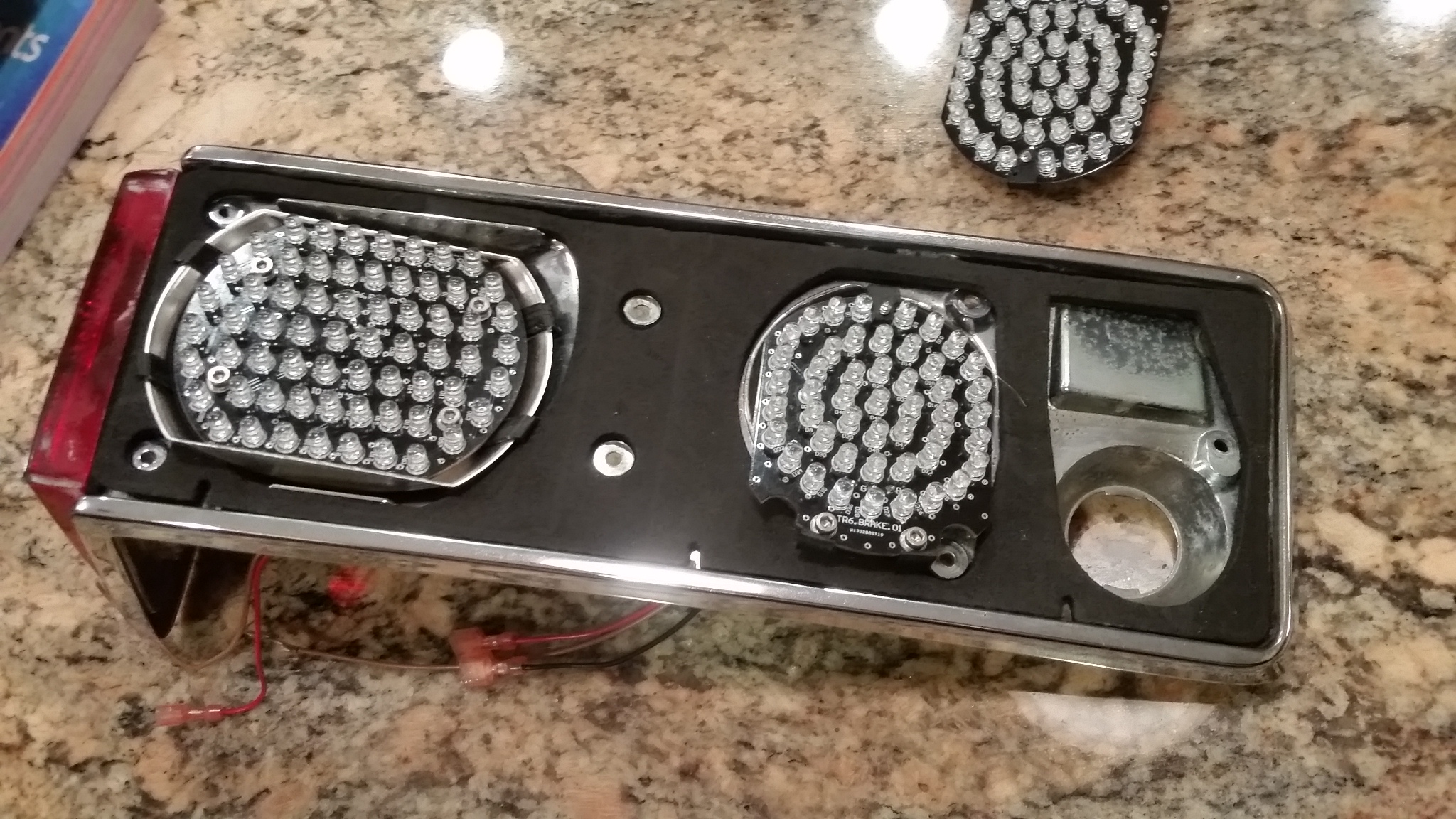

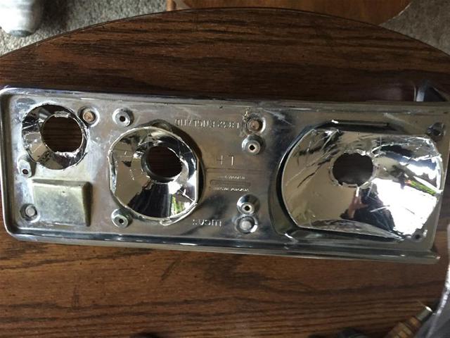

Here is a TR6 rear light housing with reflective tape. Looks very good and much better at reflecting than paint.
Here's the Spokeworks TR6 rear light solution. Our LEDs do not use the reflector for anything except mounting the LEDs.
