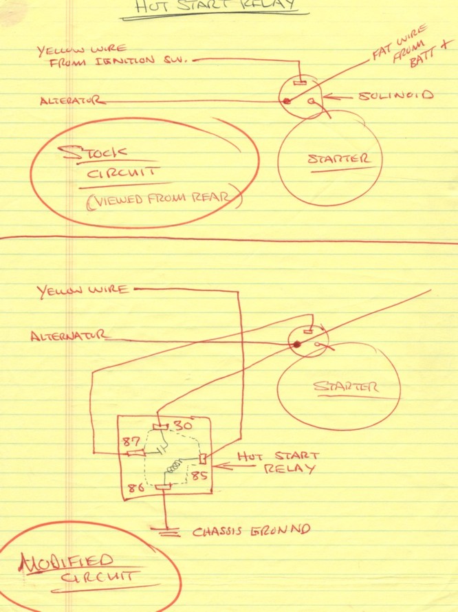

I have installed a hot start relay on all of my 914 cars and have never had
a hot start problem with any of the cars since.
You only relay need a little relay with 10 amp contacts to do the trick. The
Ford relay is heavy duty over kill.
A diagram:
black914
post Sep 5 2005, 06:02 PM
Posts: 23
Joined: 12-November 04
From: King, NC
Member No.: 3,100
Thanks, 94teener...
