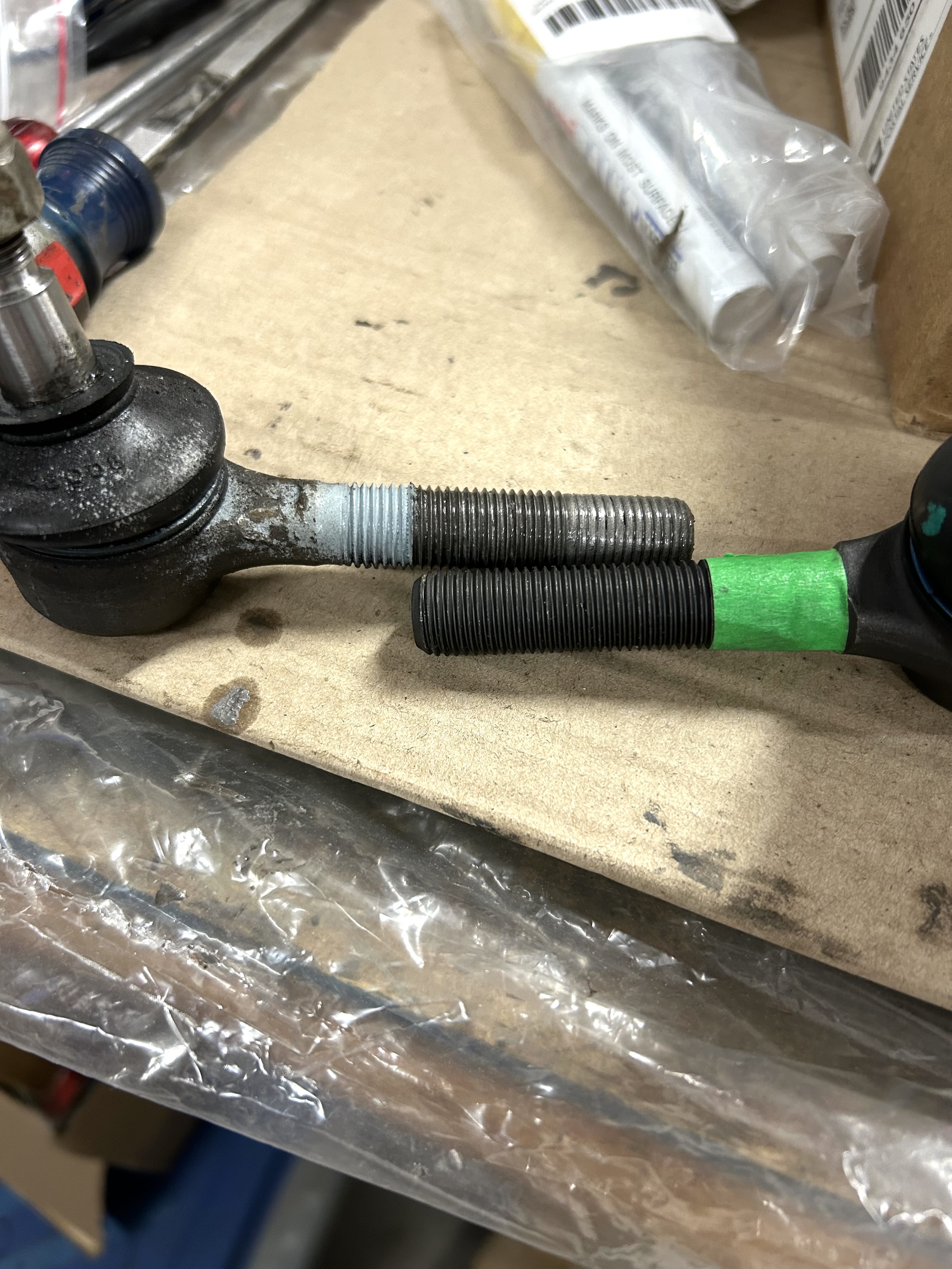

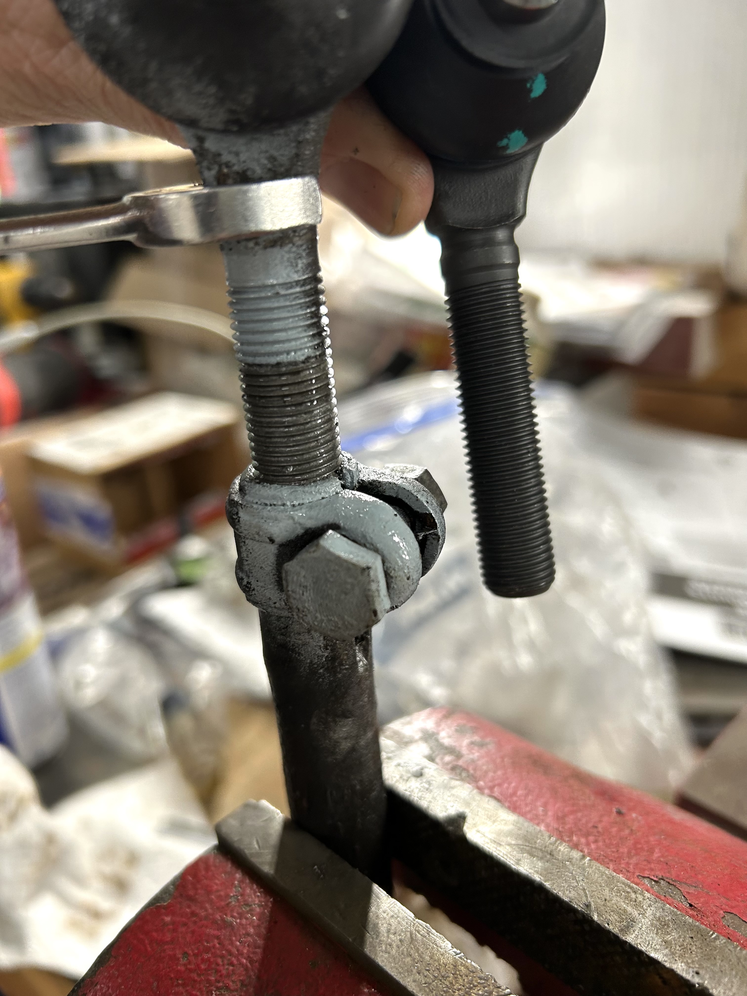

Measuring tie rod ends.Attached Image

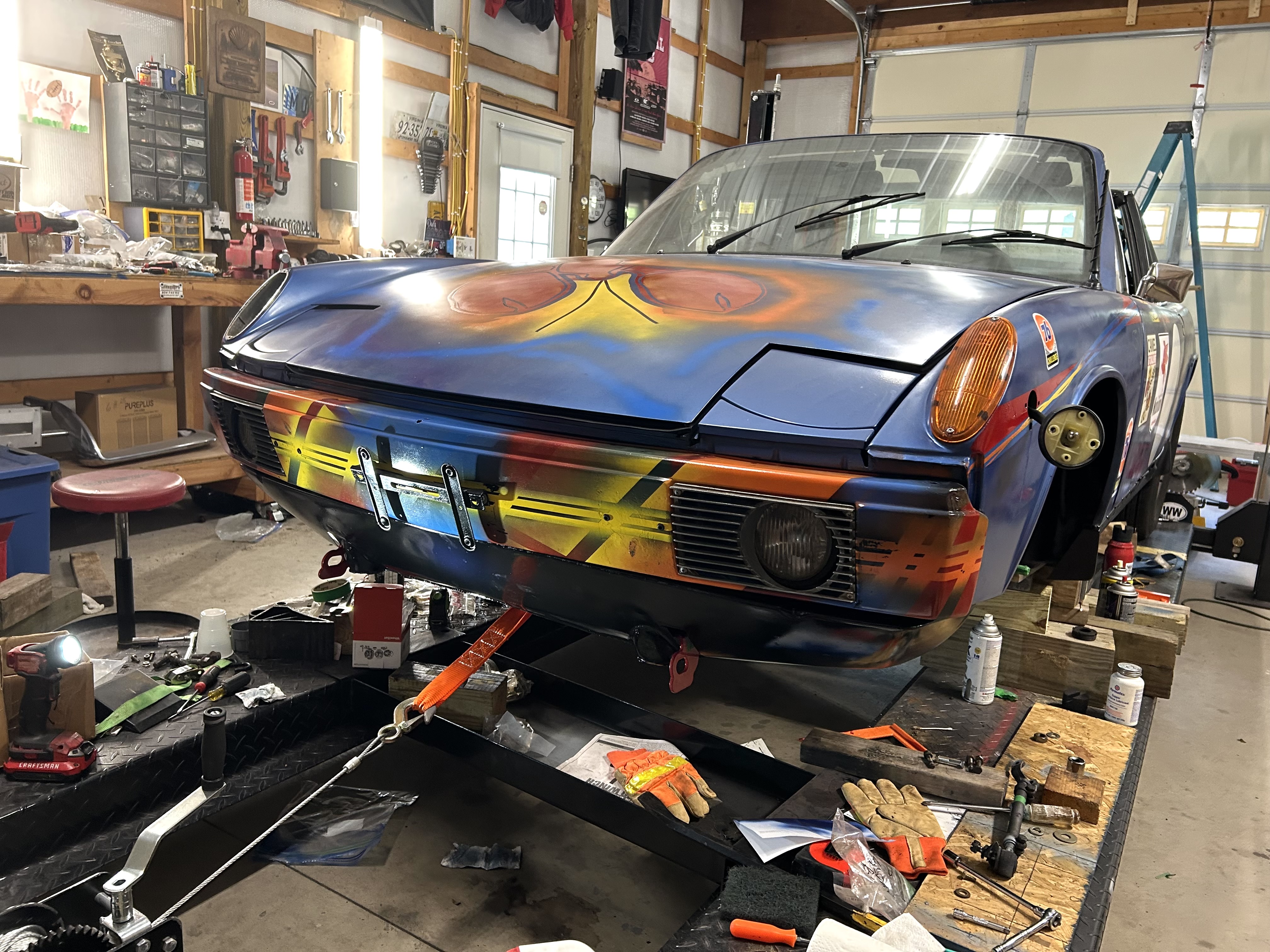

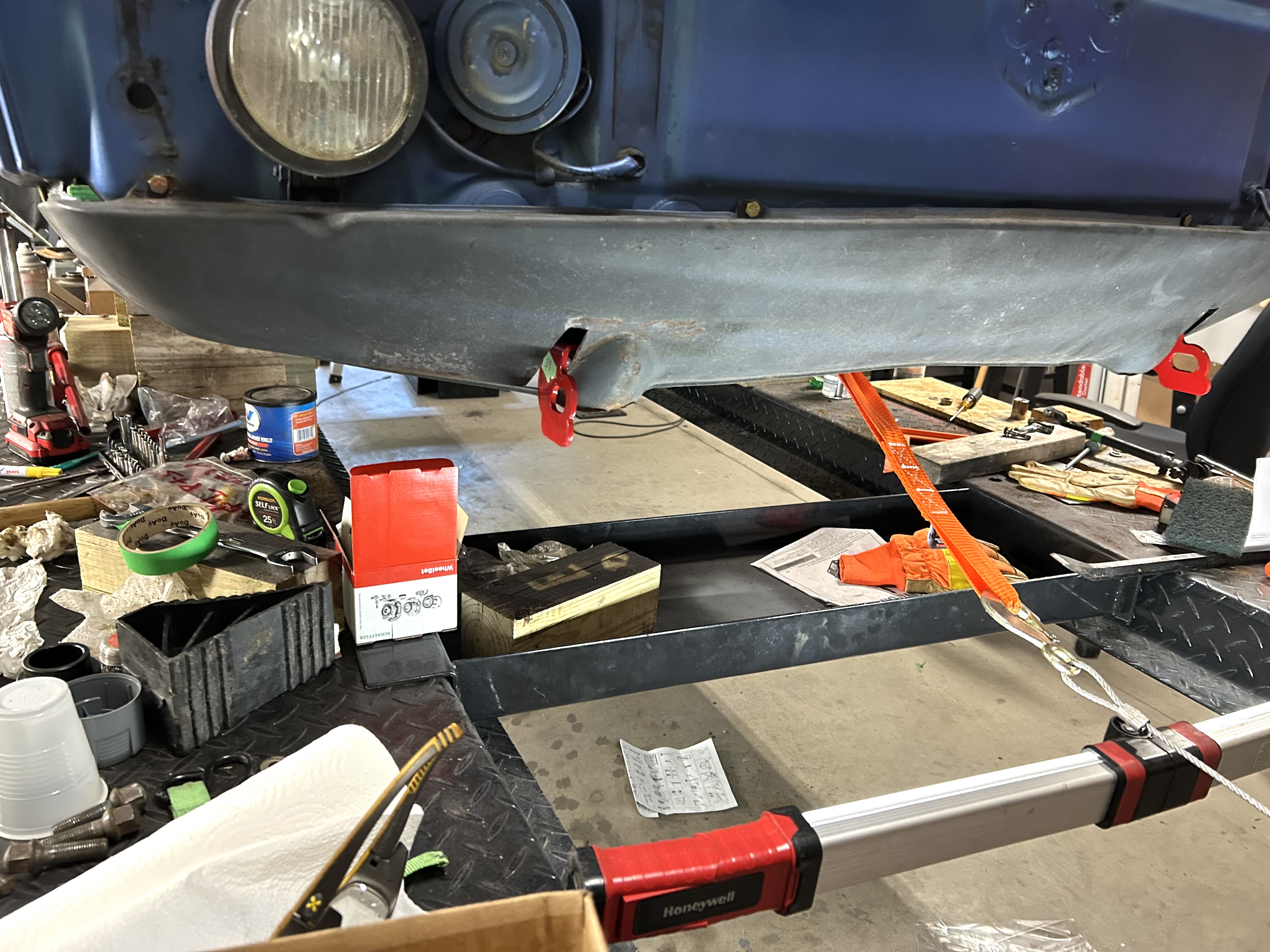

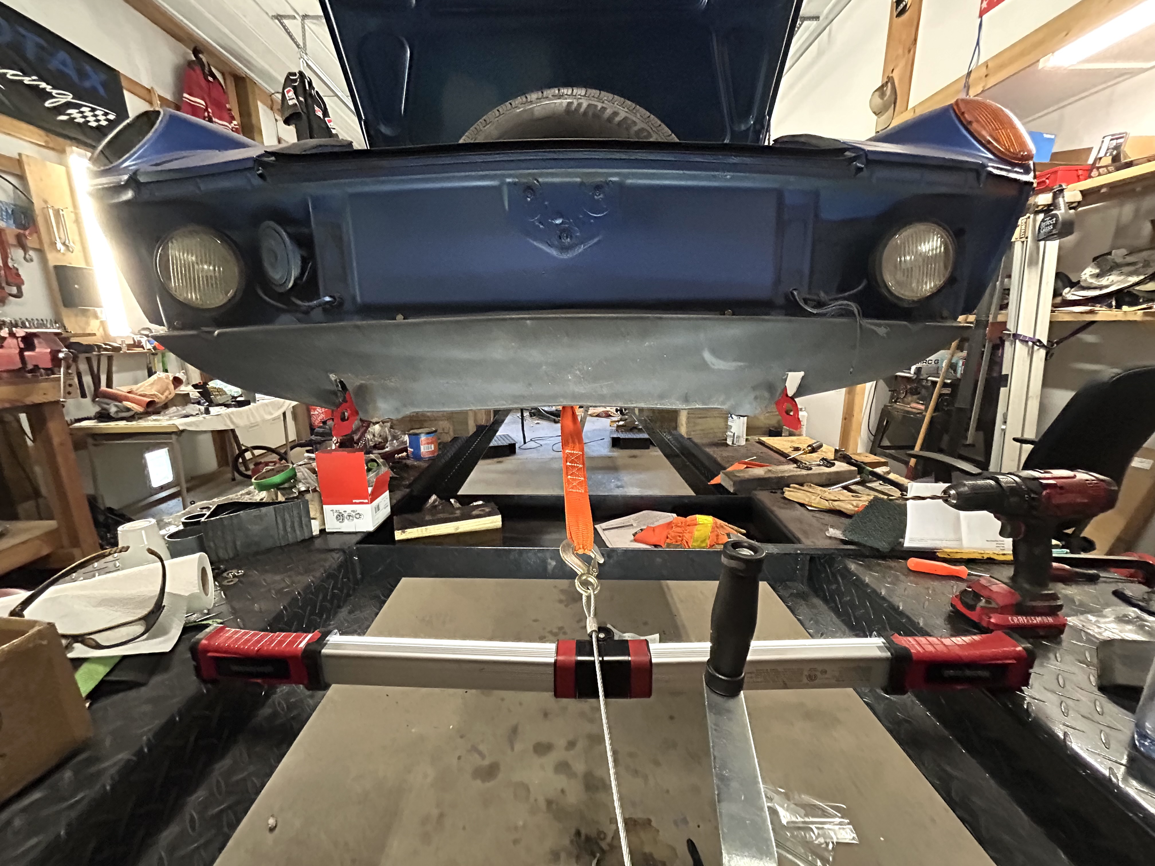

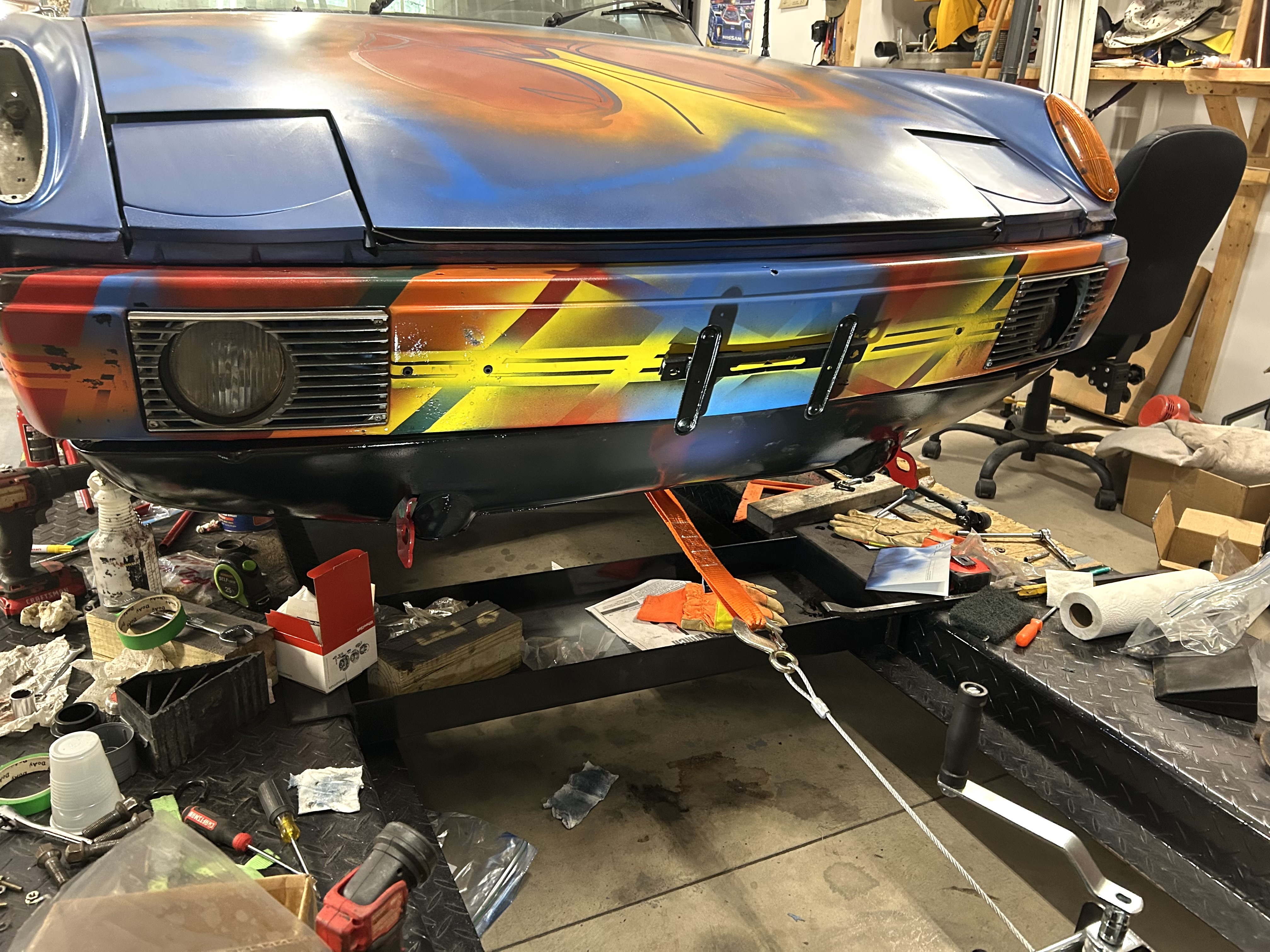

Had to modify the front valance panel to accommodate the front tow hooks.Attached Image

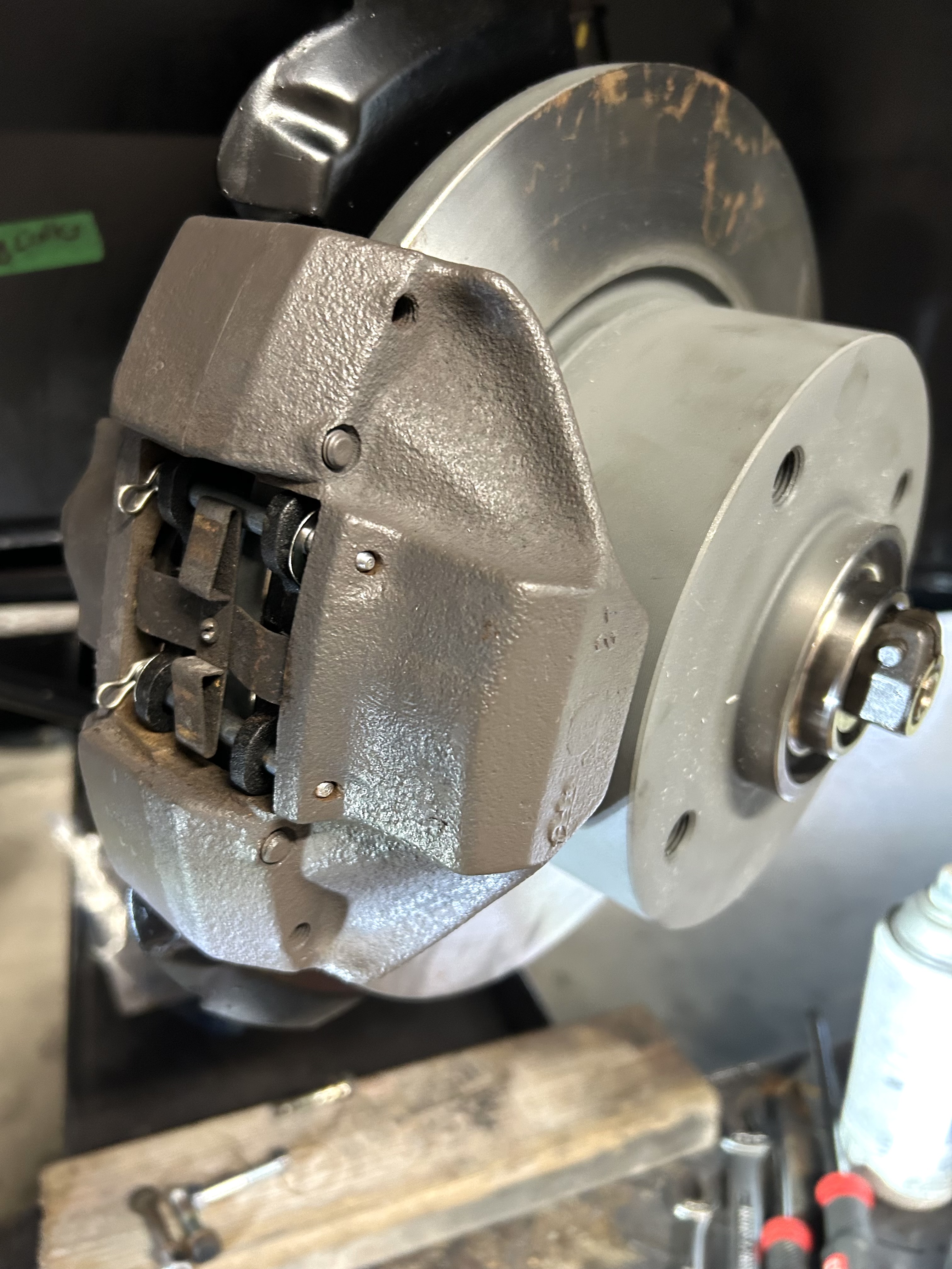

Member No.: 29,151

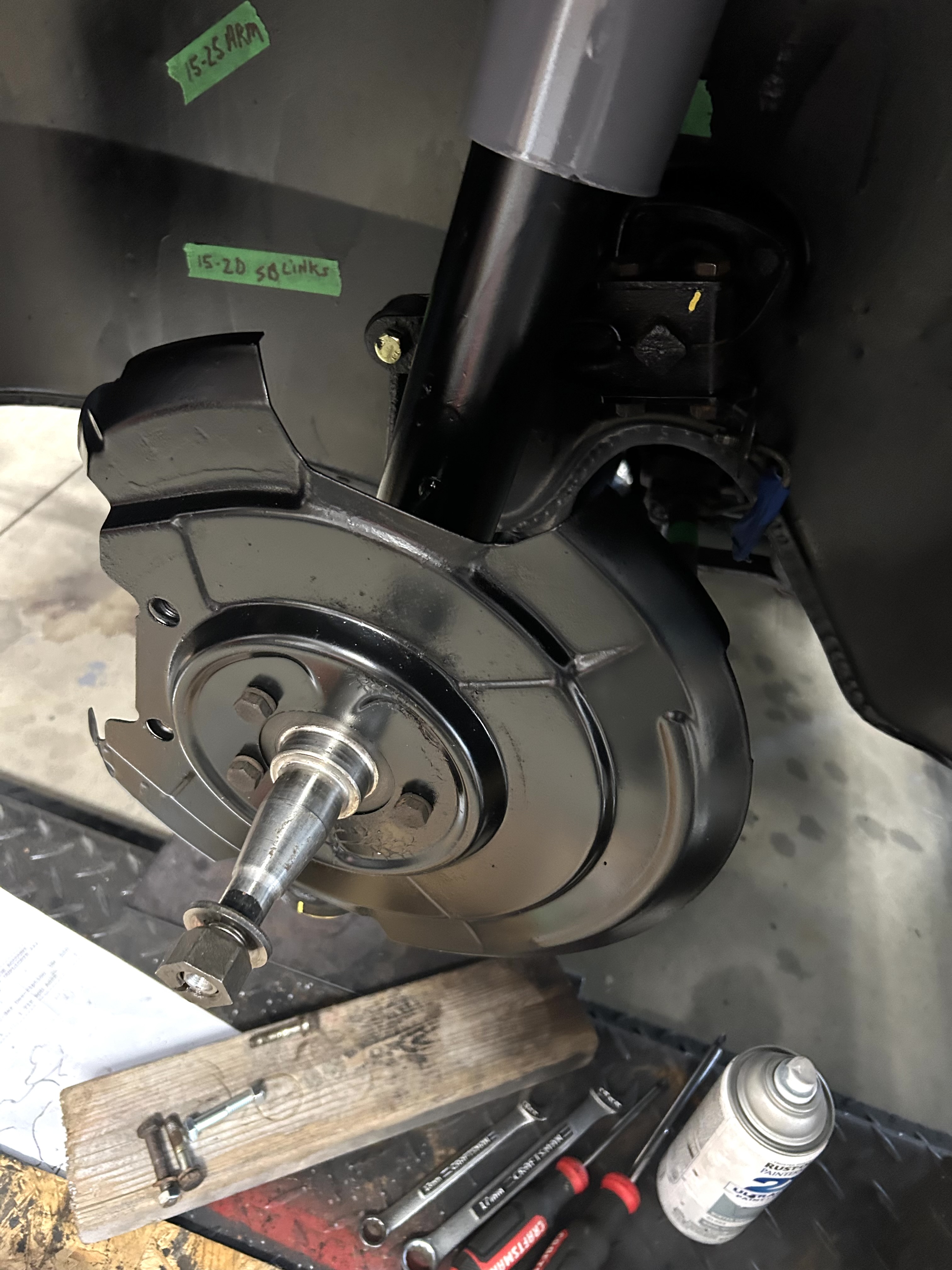

New rotors, bearings, rebuilt calipers.
Front suspension is now pretty much complete and new. I guess the engine and transmission are next.Attached Image

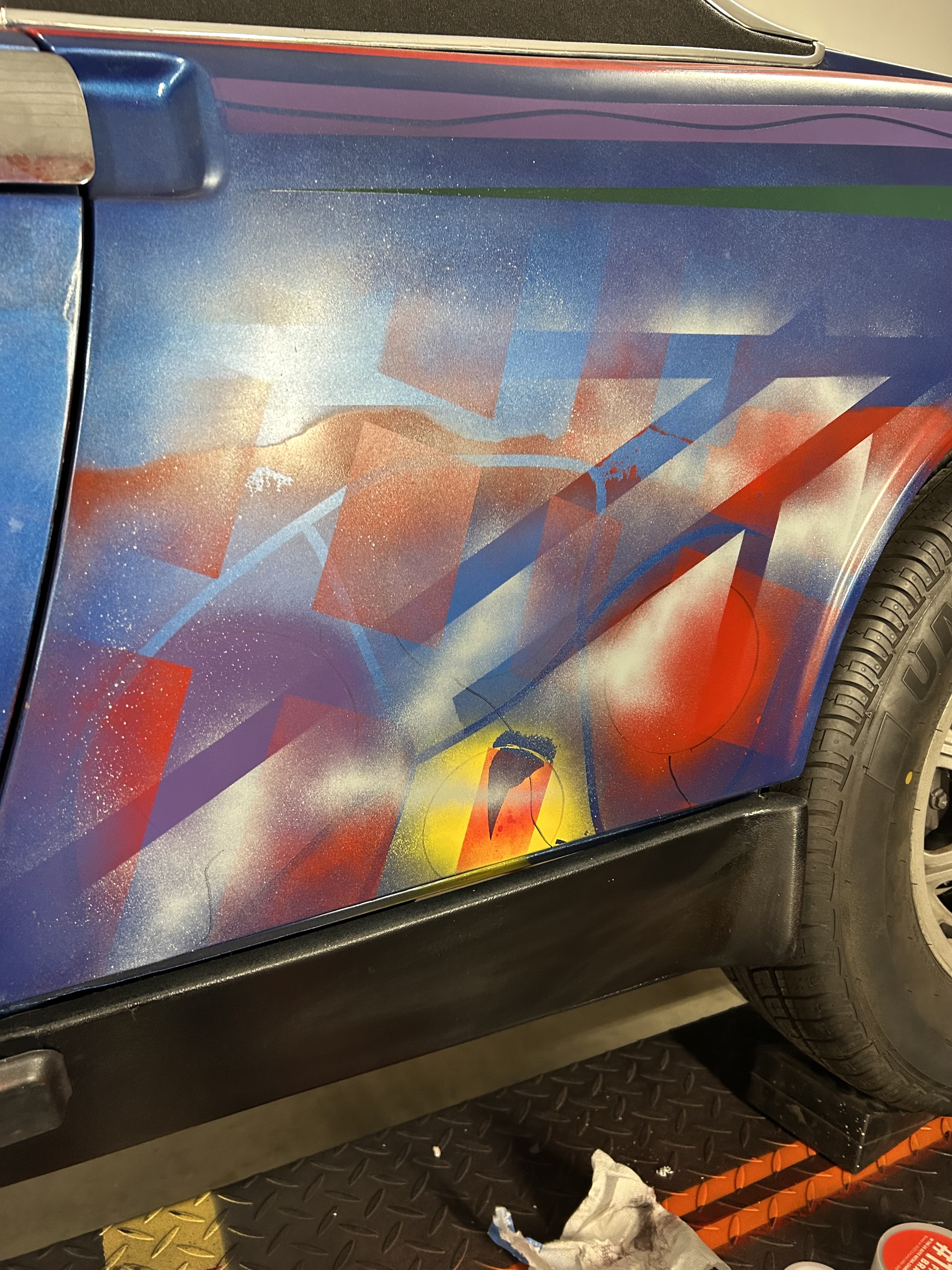

No more blank canvas.

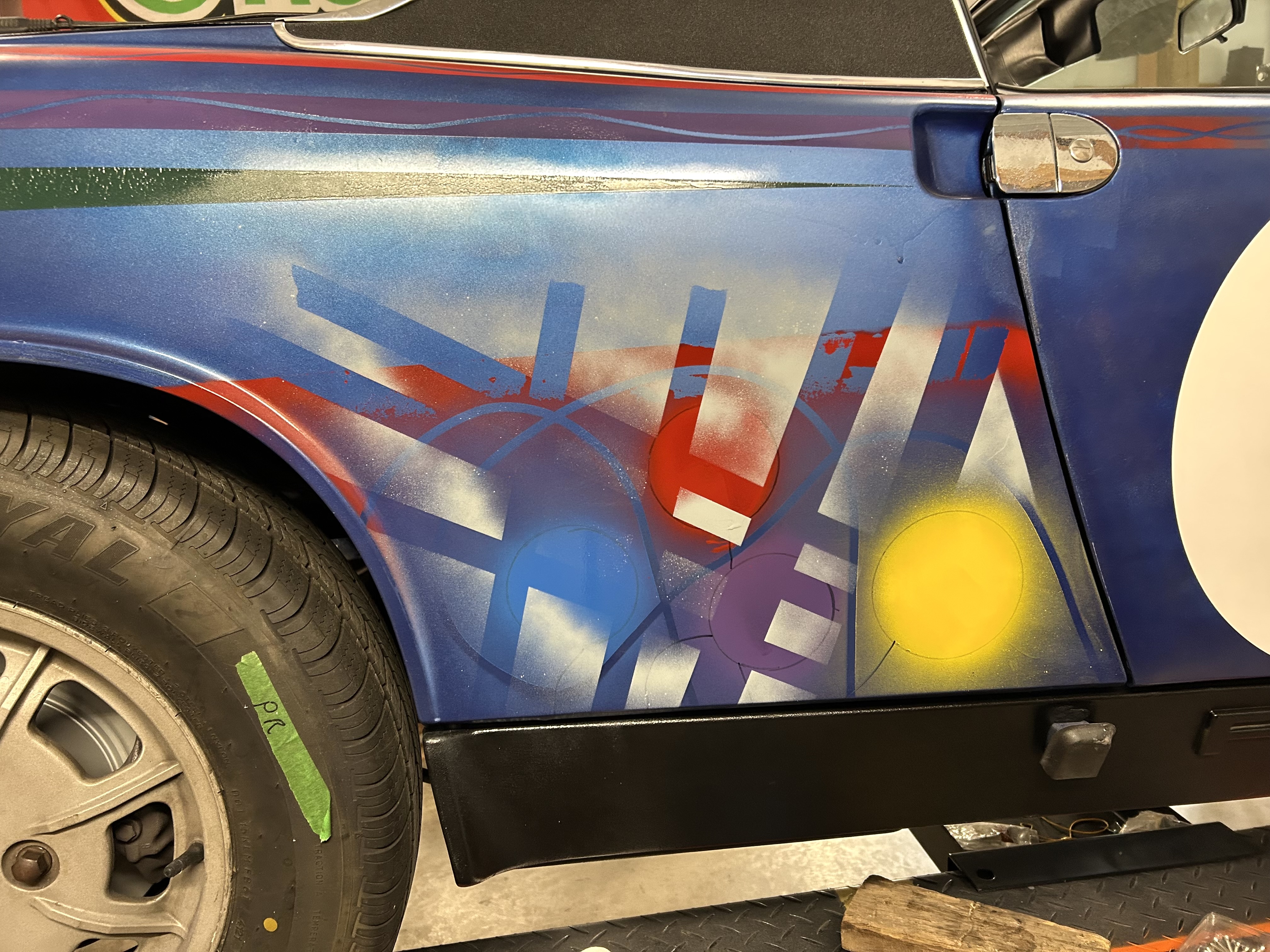

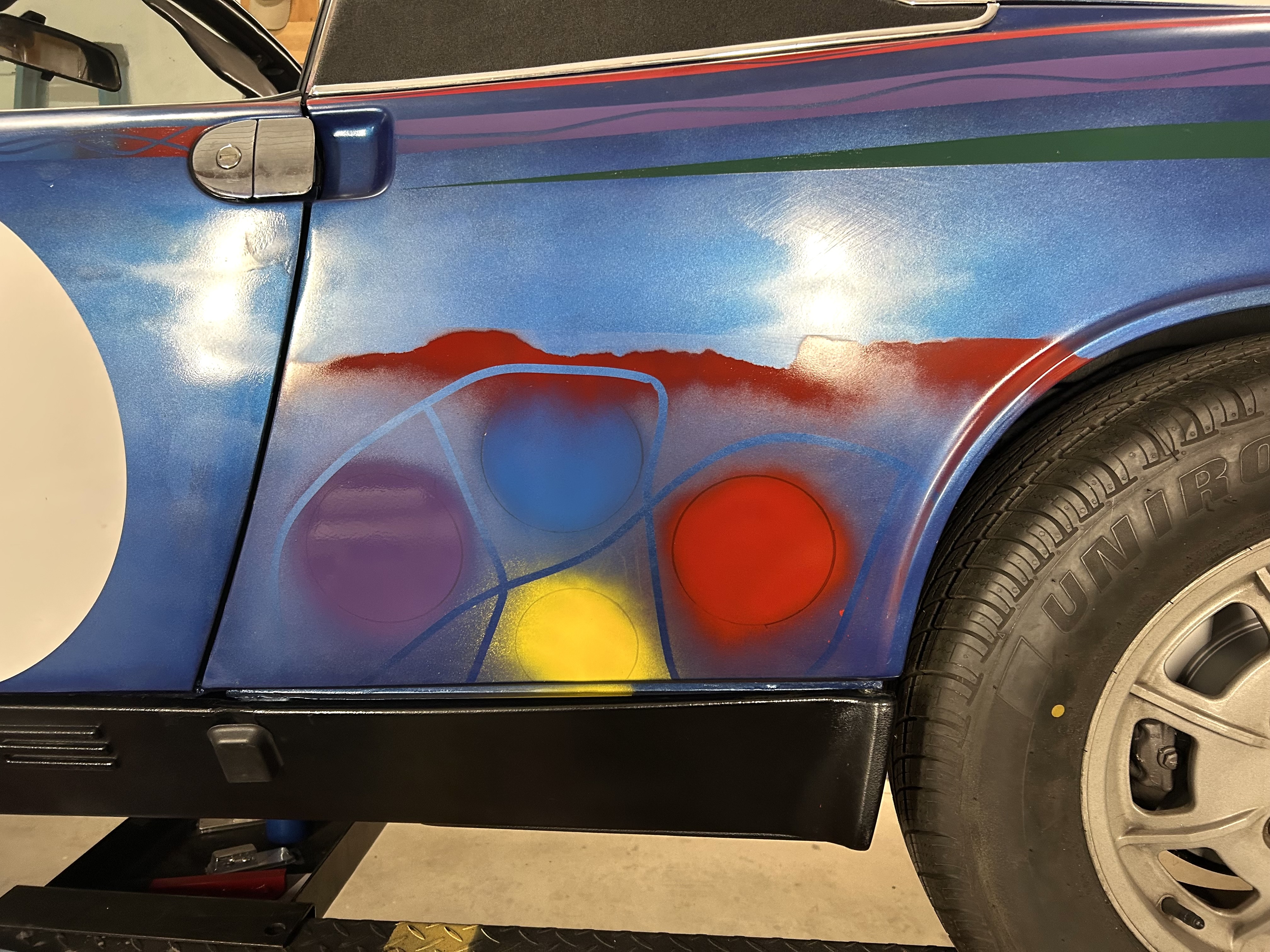

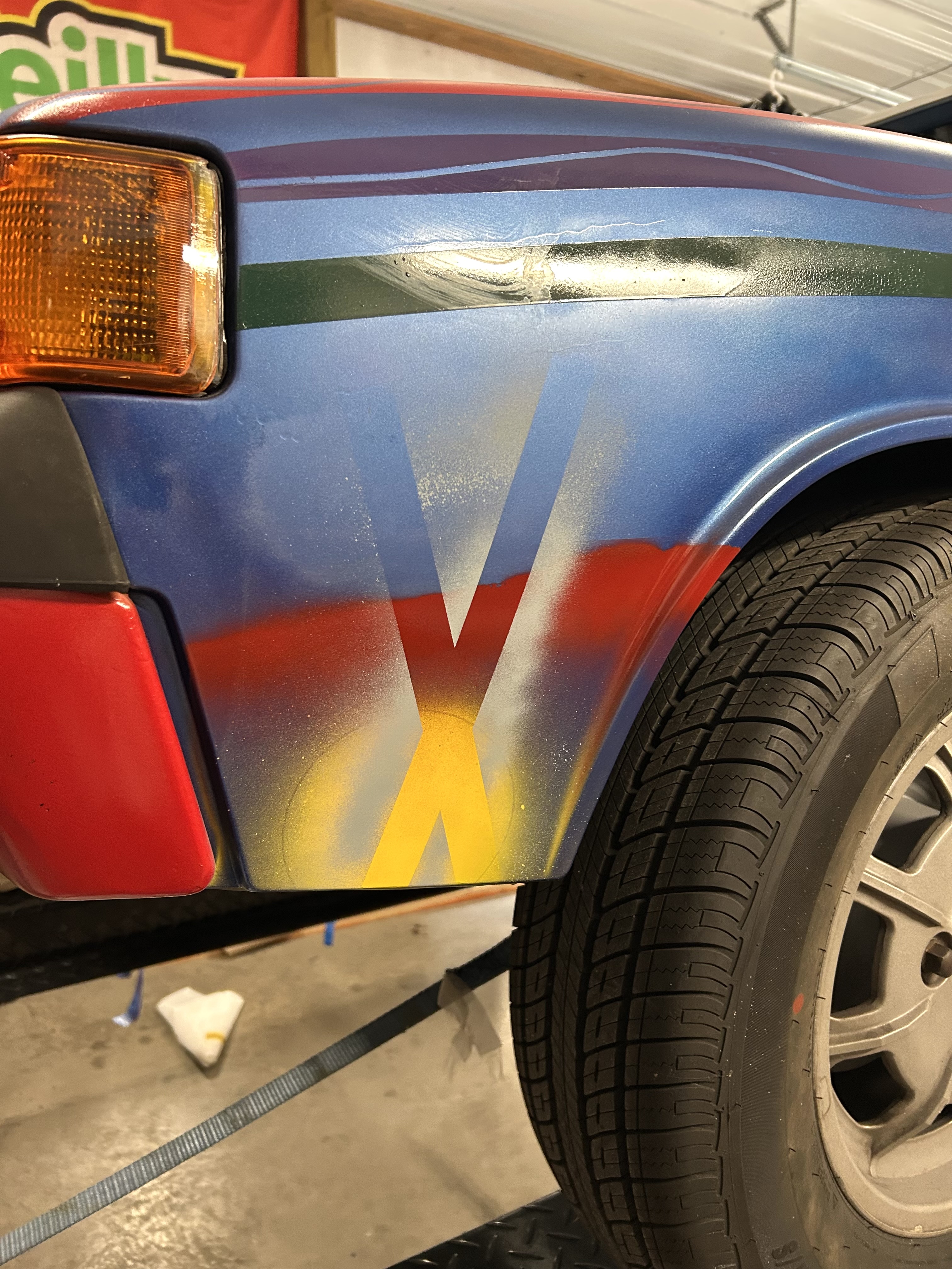

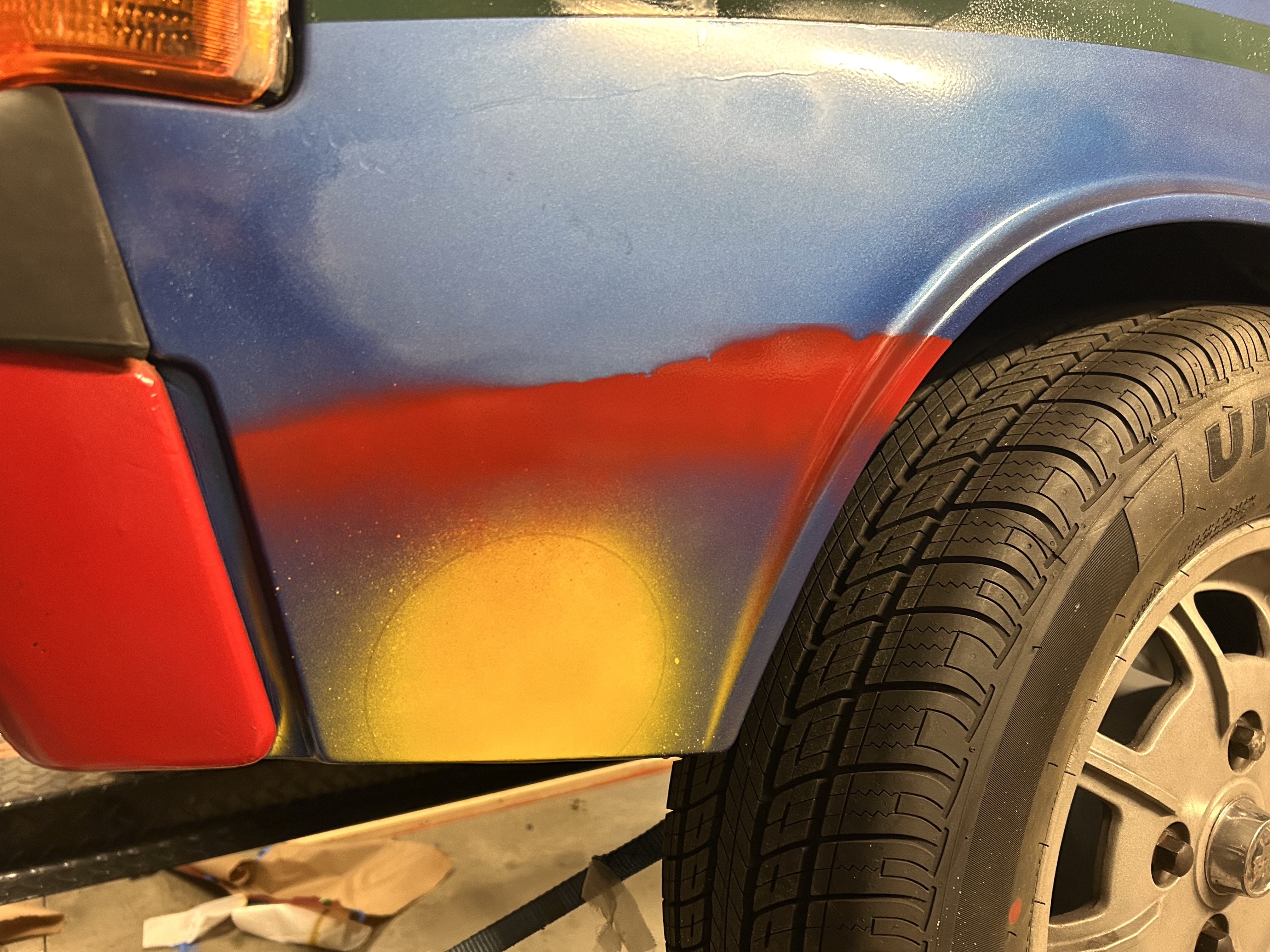

Had to let it dry between paint.

I have an hour to clear coat or wait 24 hrs.

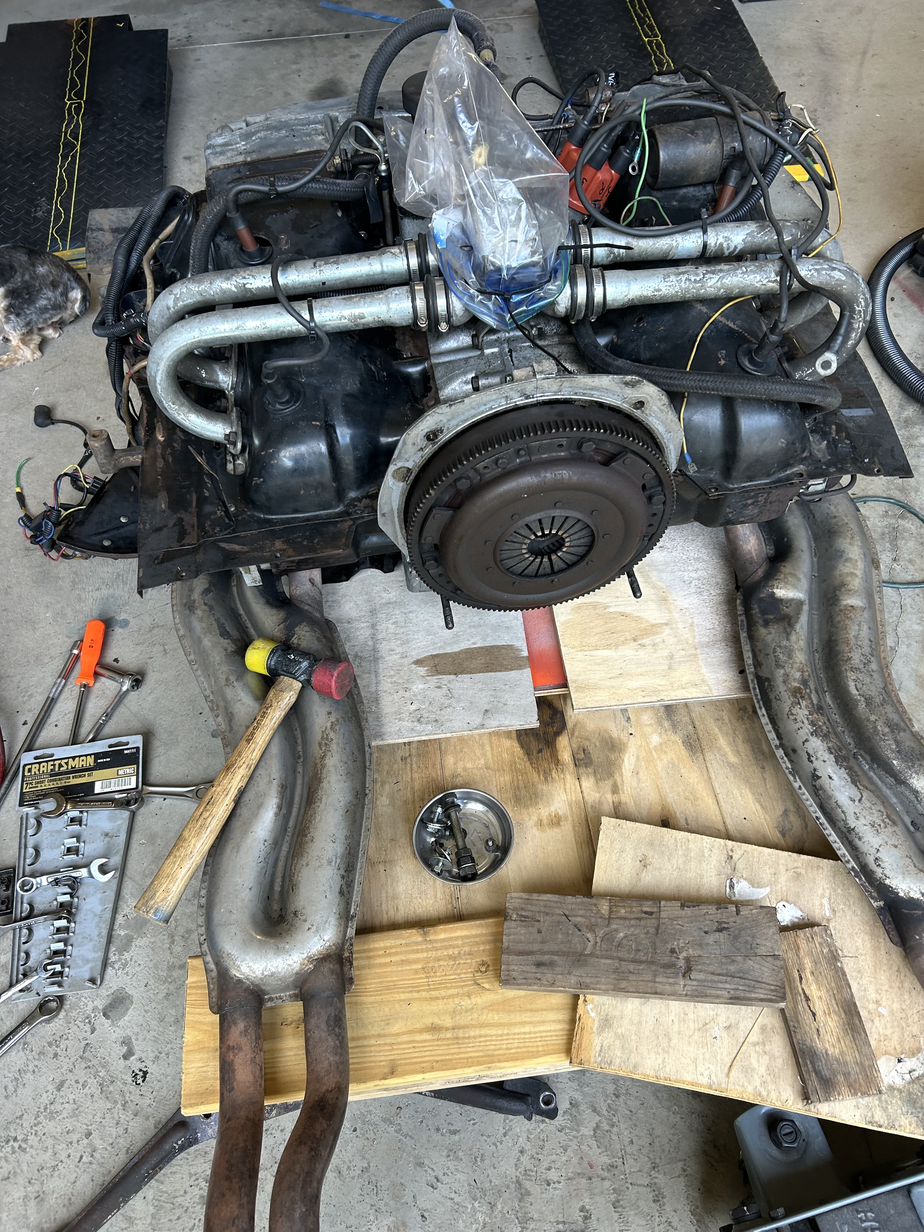

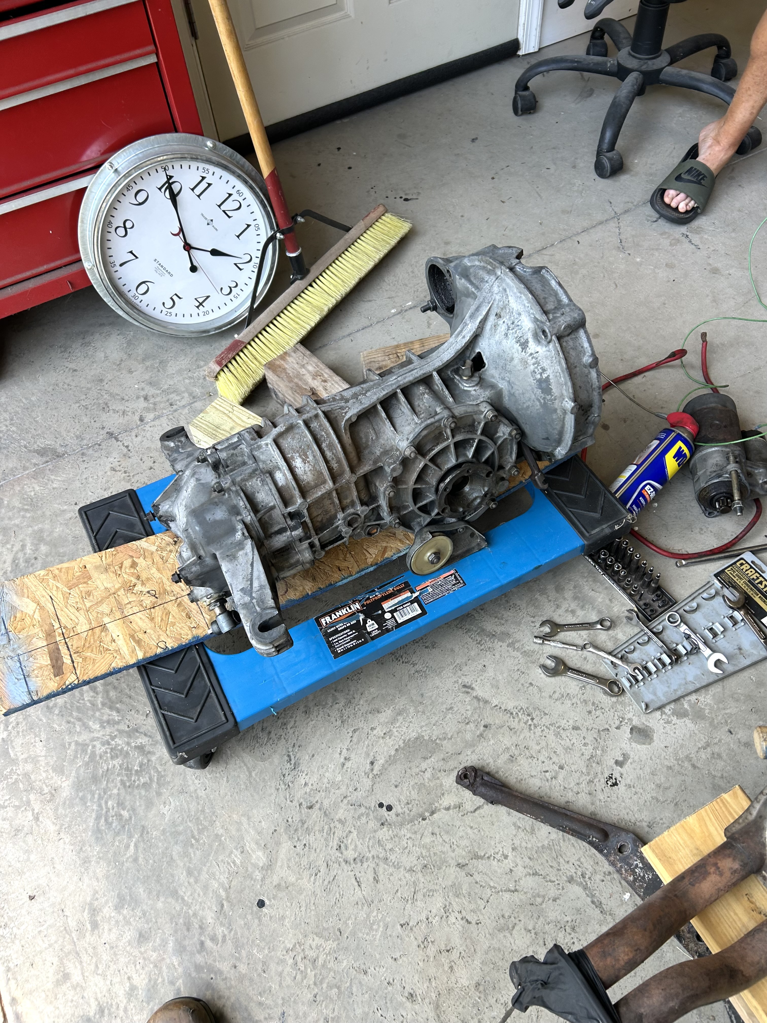

Engine and transmission were degreased and power washed. Today they were separated.Attached Image

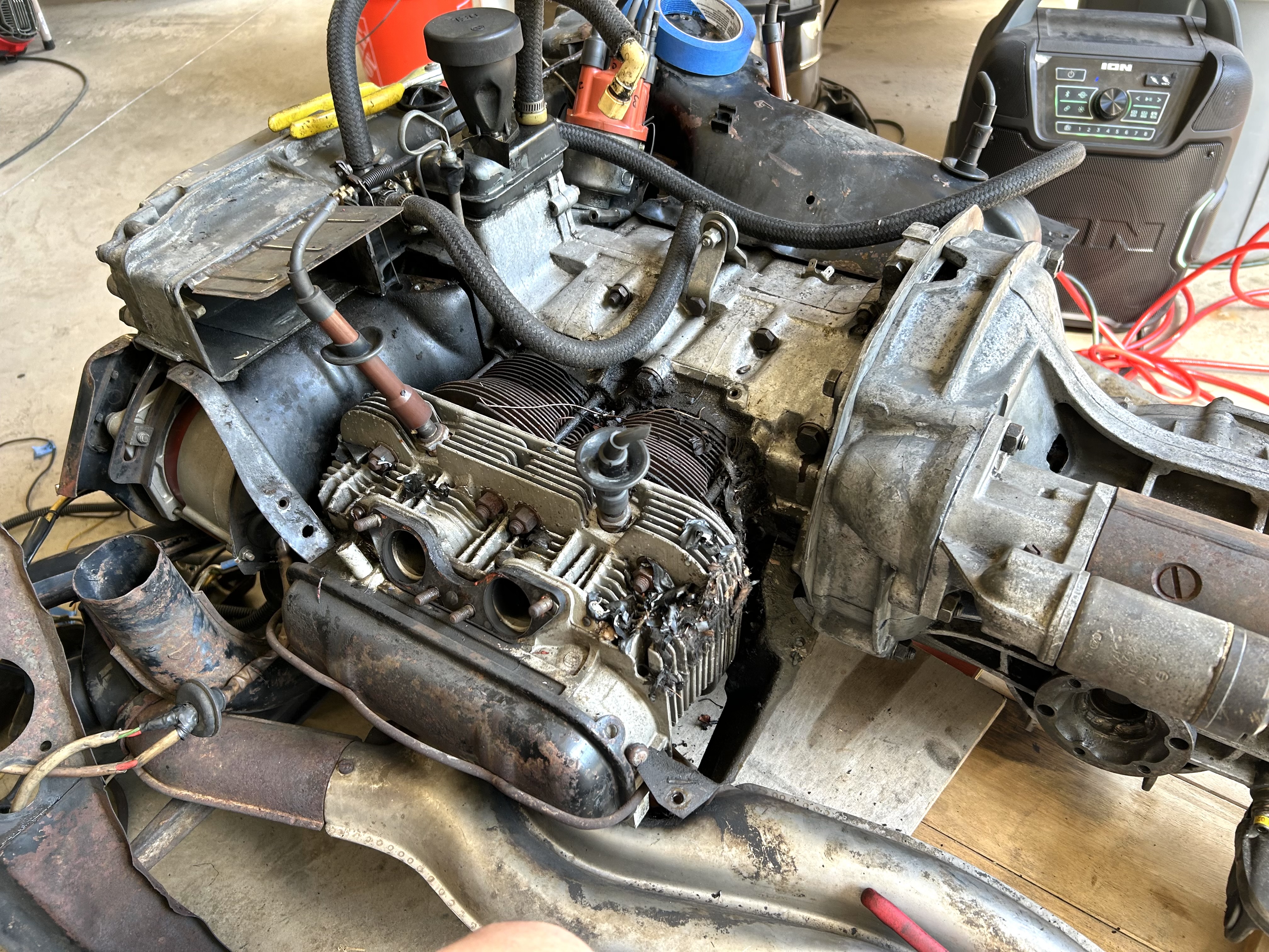

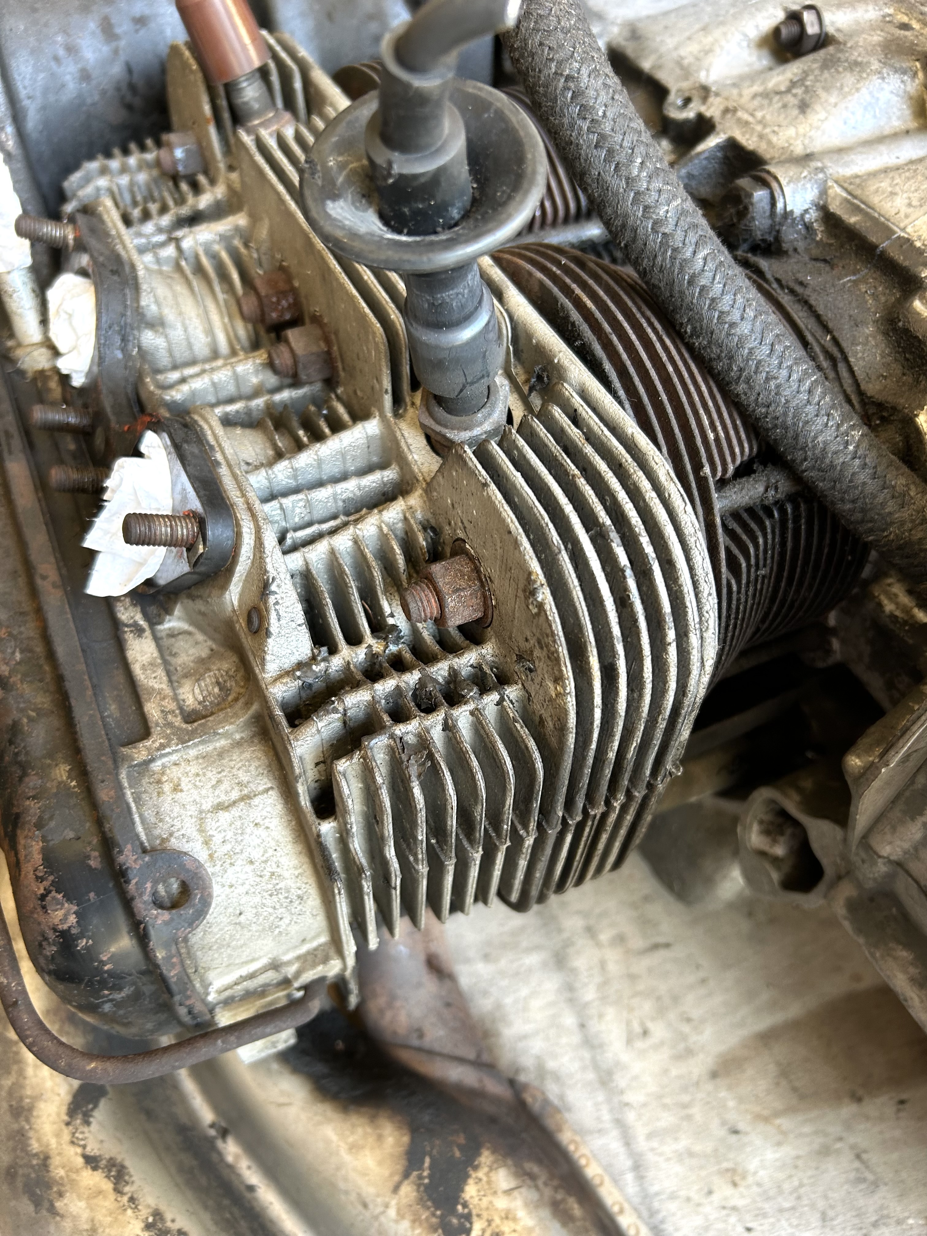

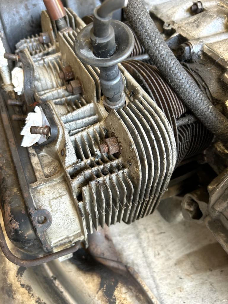

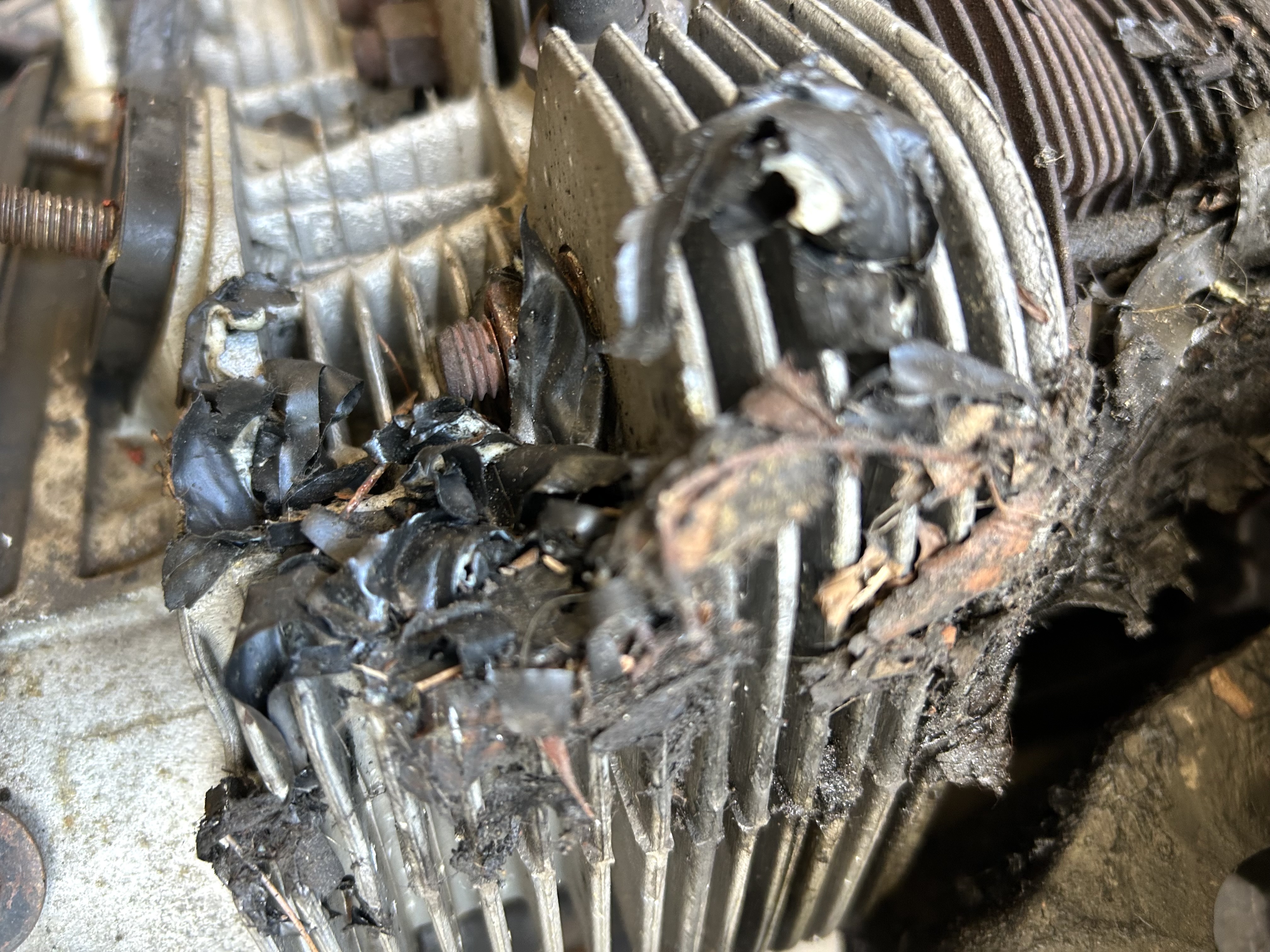

I ended up putting the transmission and engine back together with a starter so I can do a compression check. I took the engine tins off and was surprised at what I found. It was a combination of shredded electrical tape and very thin wire that had gotten hot and melted. I imagine the mice deposited it there and it could’ve been part of some blower hoses.Attached Image

Both cylinder heads had to be cleaned.
