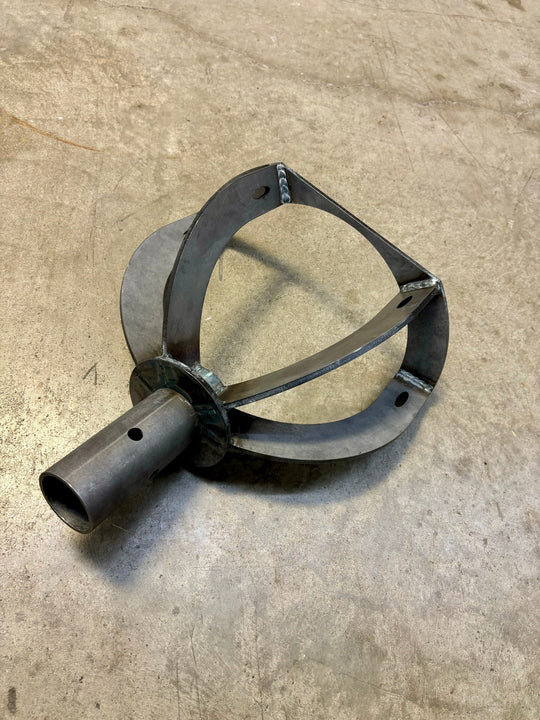

Engine and Transmission adapter for 911 912 914 and 356 for an engine stand.
This one looked like it was very well-made and you should be able to do pretty much anything including putting the engine tins on the motor while on the stand.Attached Image

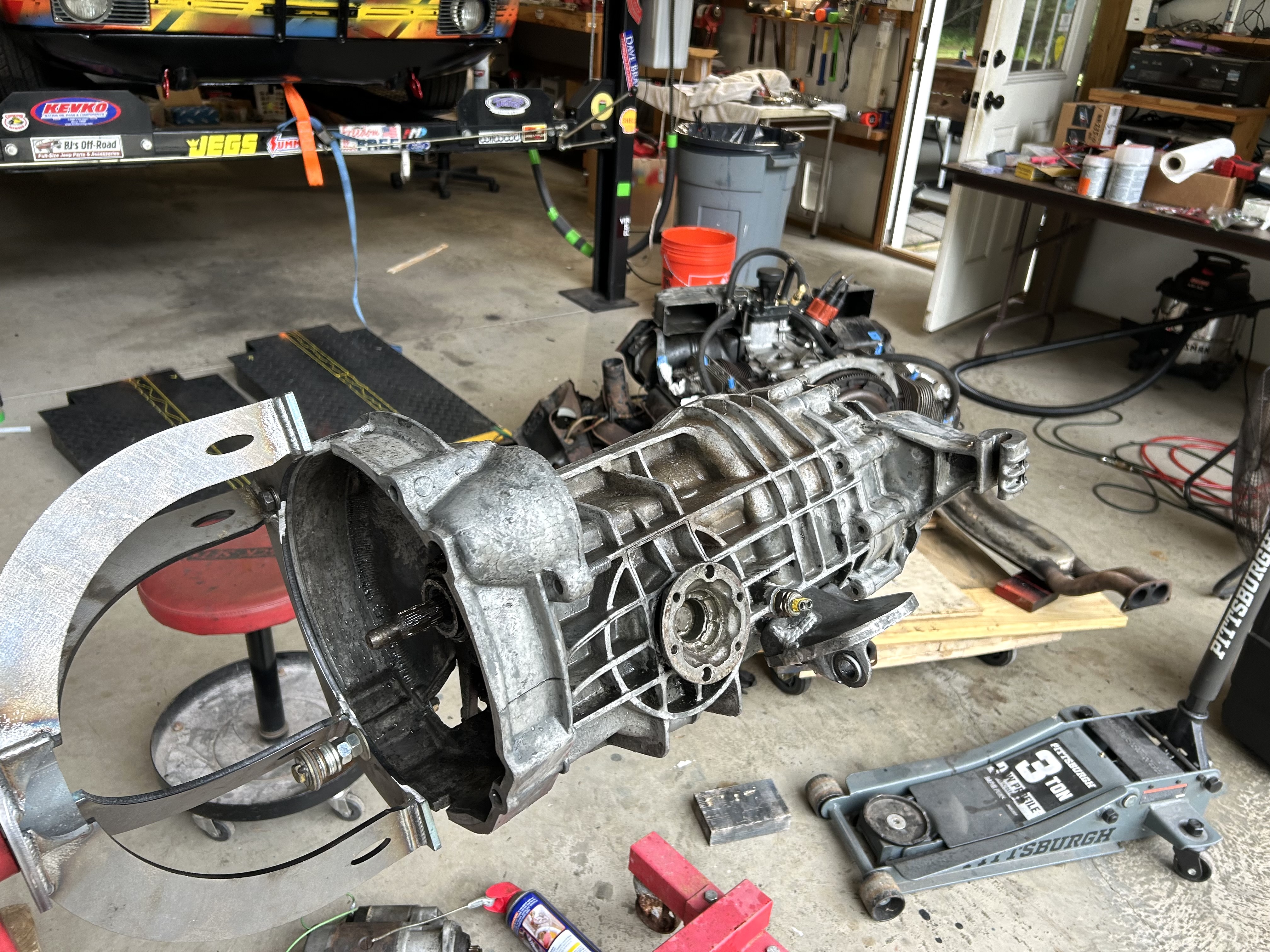

I don’t think the effort to clean this is going to show up in the pictures. Wire wheels on a drill. Brass wheels on a Dremel. Cans of brake cleaner and a very stiff, nylon brush.

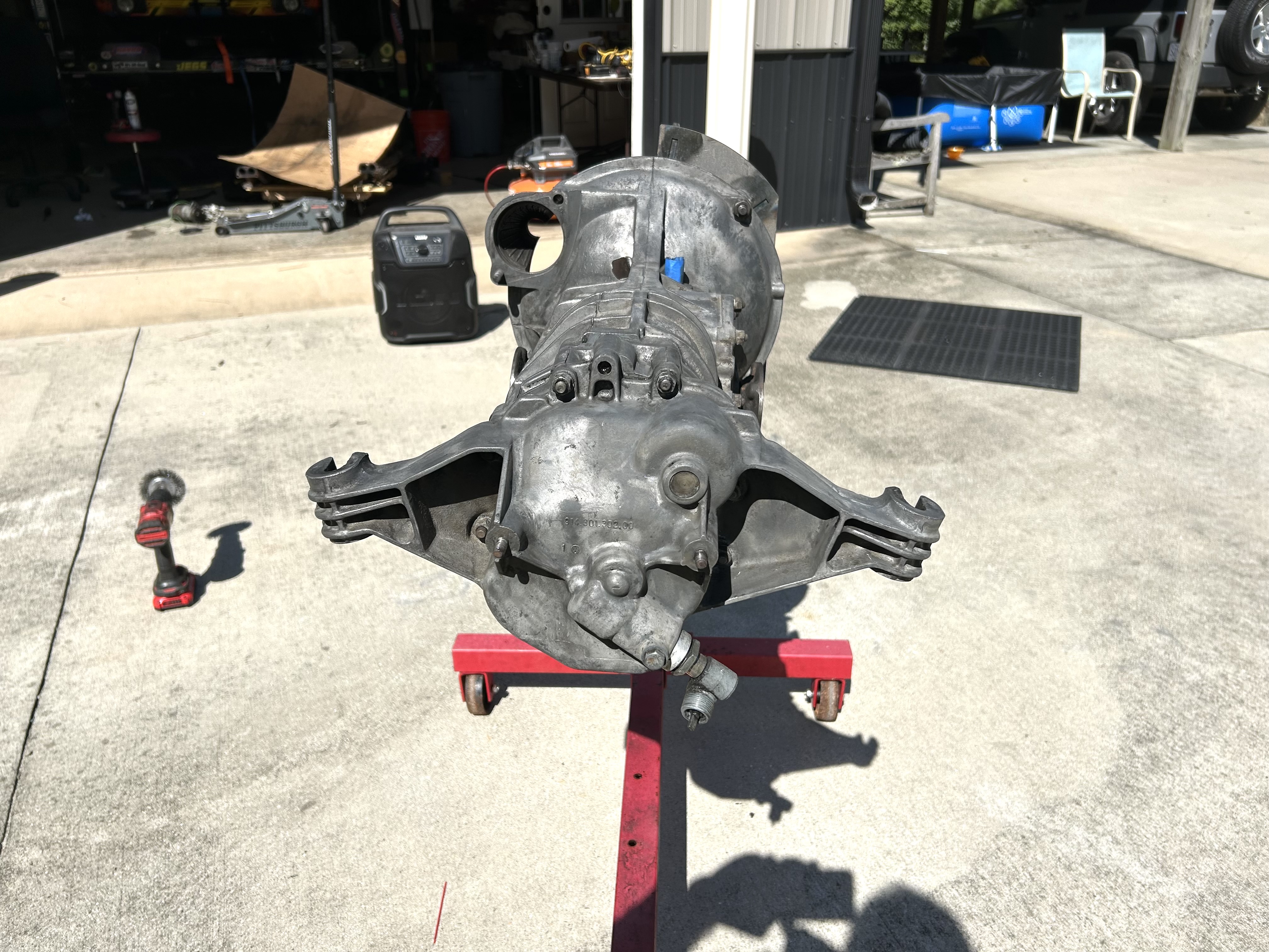

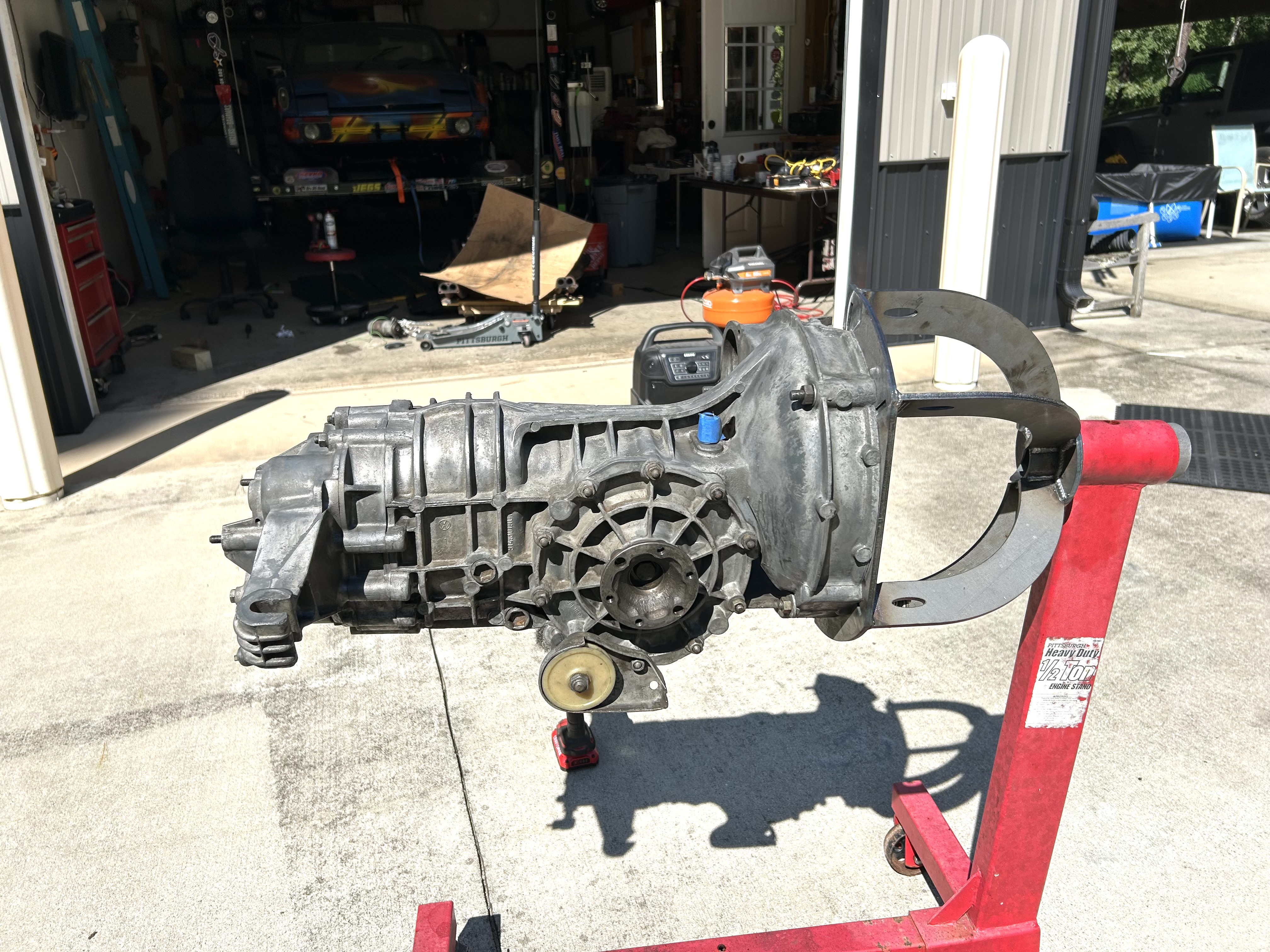

Put the motor on the yoke.Attached Image

Cylinders are cleaning up. Attached Image
