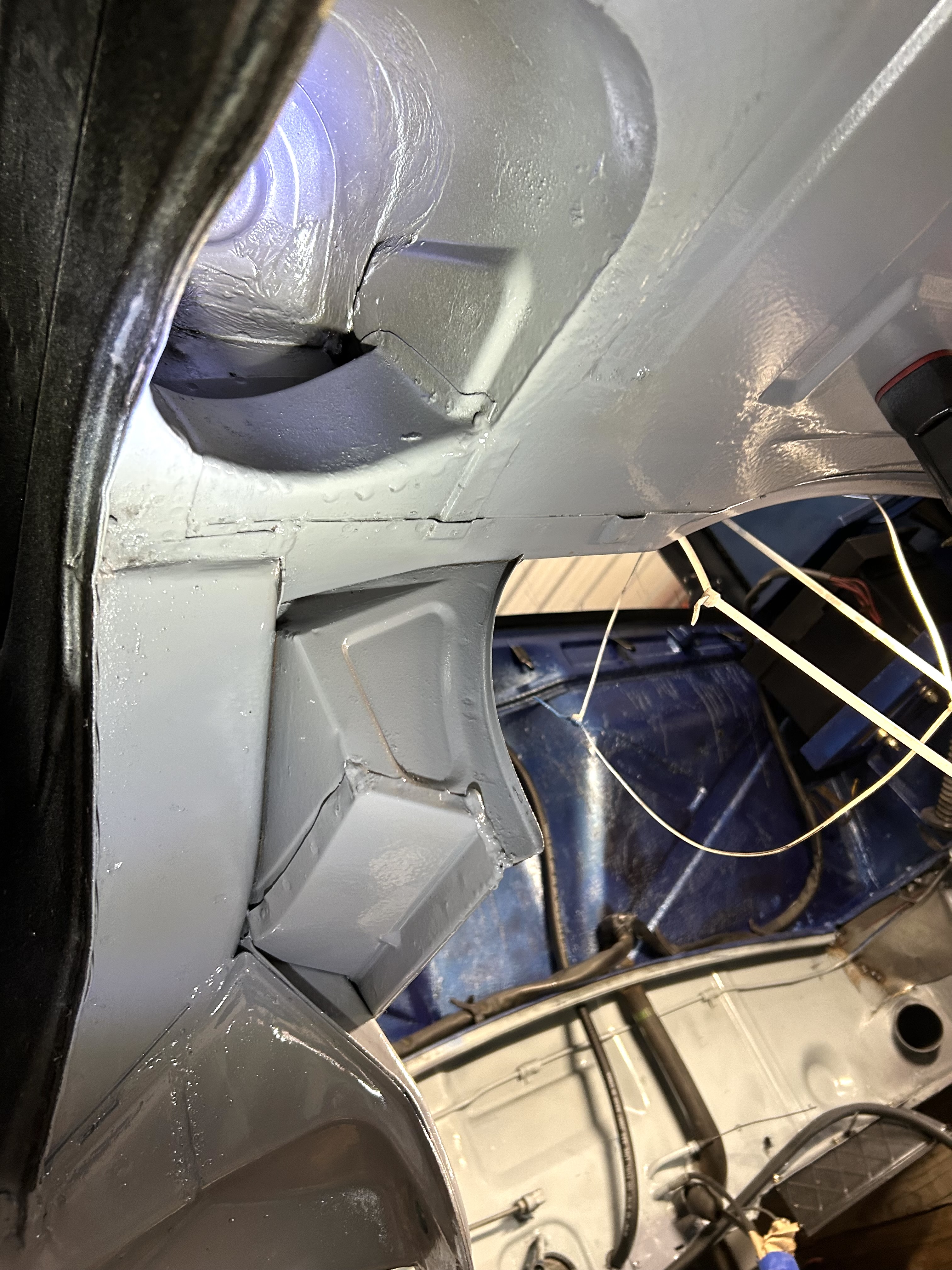

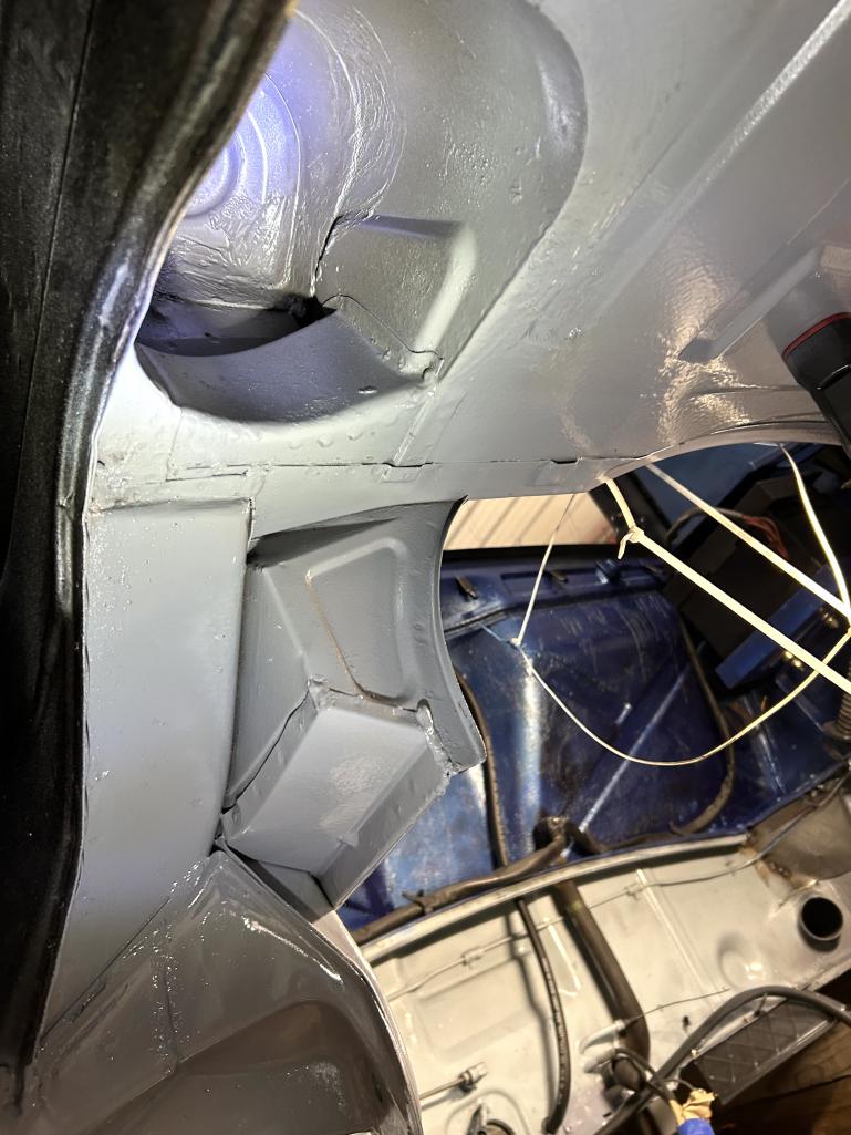

Strut towers and trailing arm attachment points.

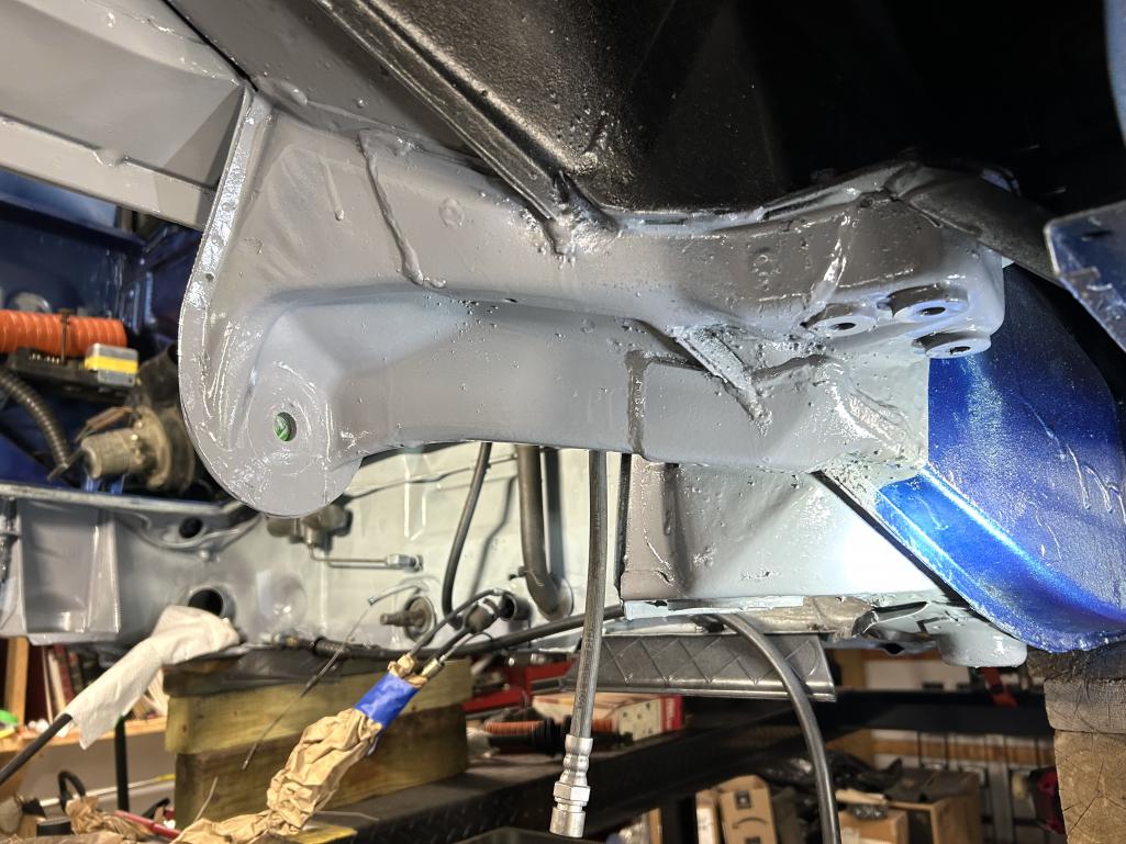

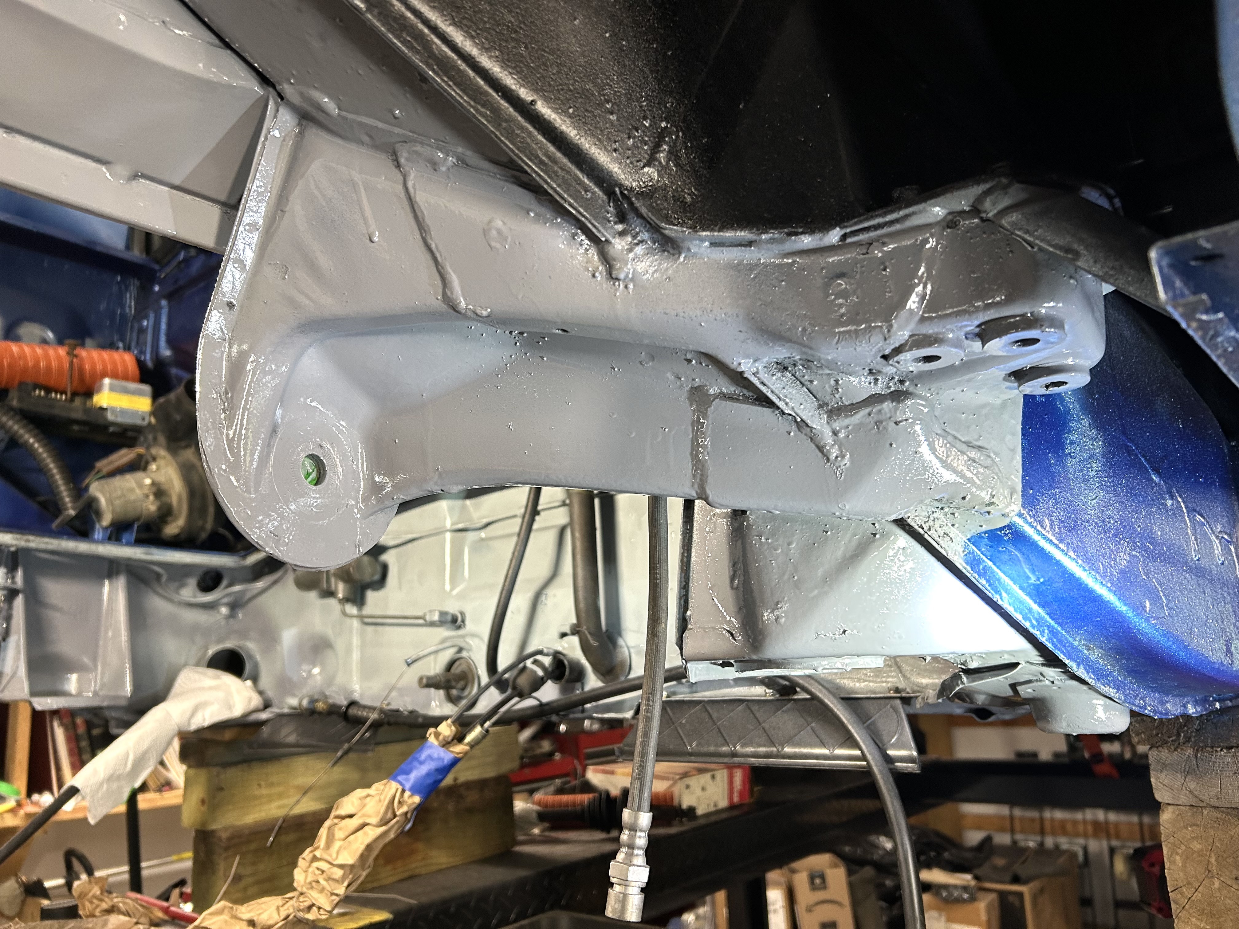

HFC3
post May 9 2026, 01:25 PM
Post #64
Posts: 156
Joined: 14-December 25
From: Virginia
Member No.: 29,151
Hopefully the trailing arms will come together quickly, and I can get the rear reinstalled.Attached Image

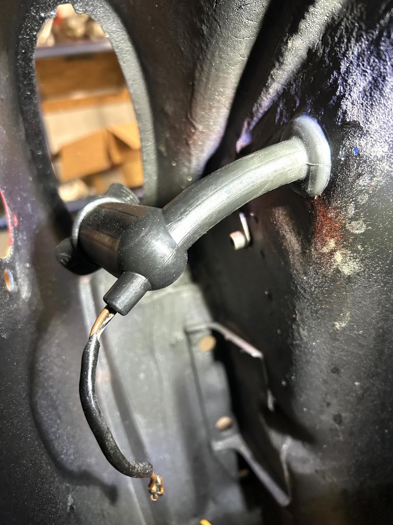

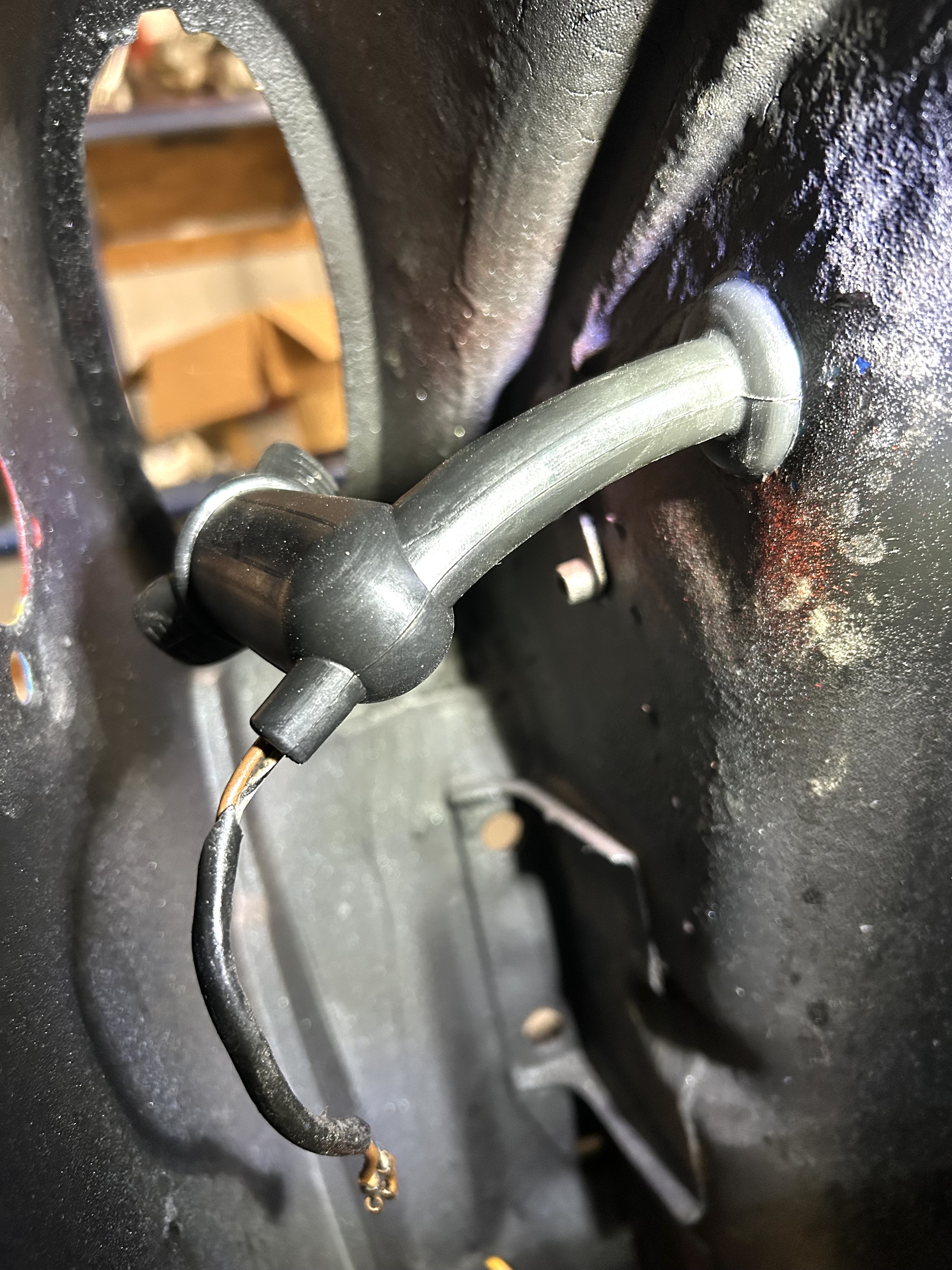

Fishing the wires into the rubber sleeve for the turn signals and headlights is not much fun.Attached Image
TRP
post May 14 2026, 08:11 AM
Post #68
Posts: 459
Joined: 2-September 23
From: Morgan Hill, CA
Member No.: 27,559
Oof. Still not the worst job Ive found on the 914. For me it was reattaching the torsion spring for the rear trunk. I can go the rest of my life and never do that again. However, now that I made the tool for it, Im less likely to hurt myself if I should have to.

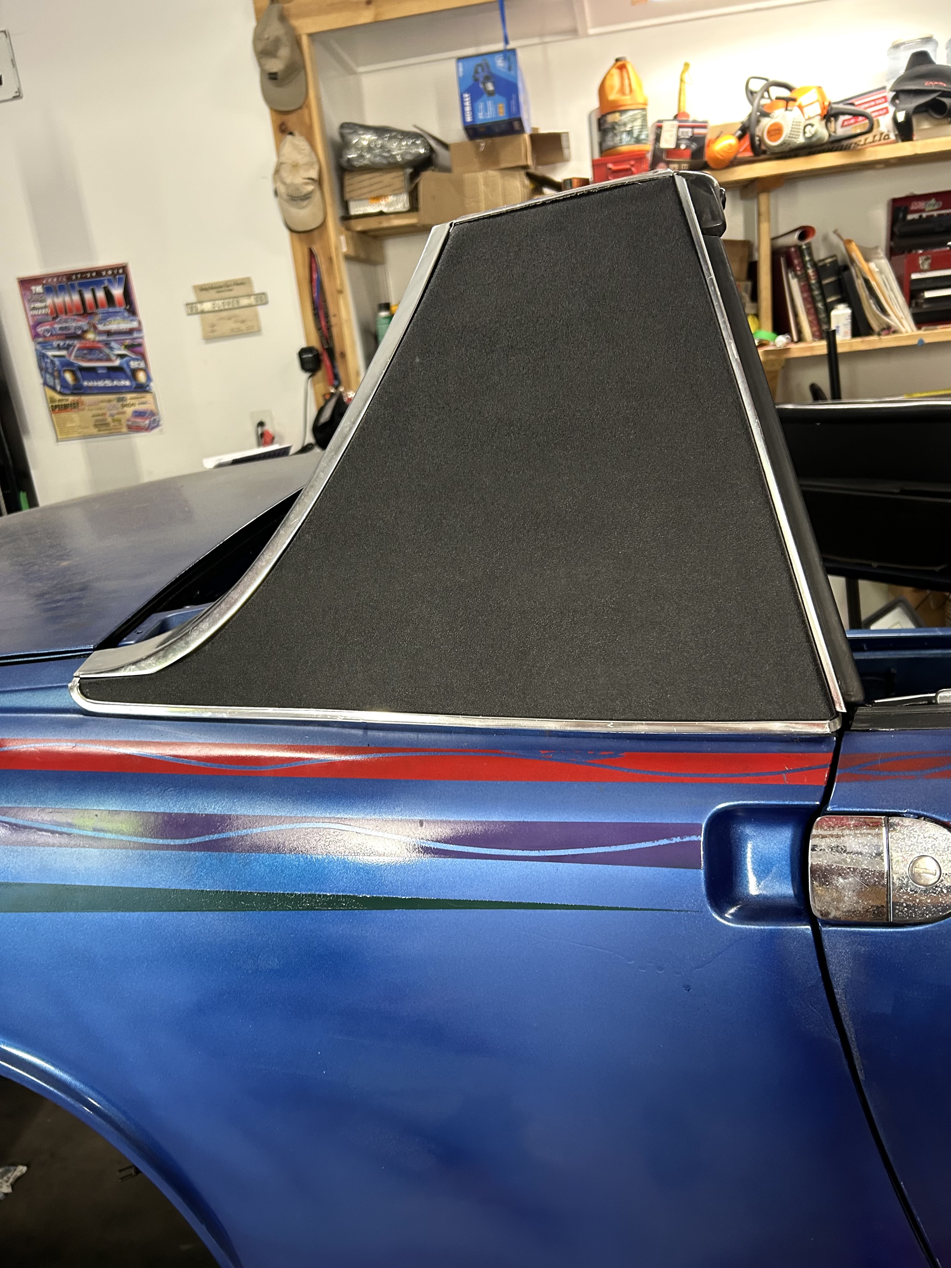

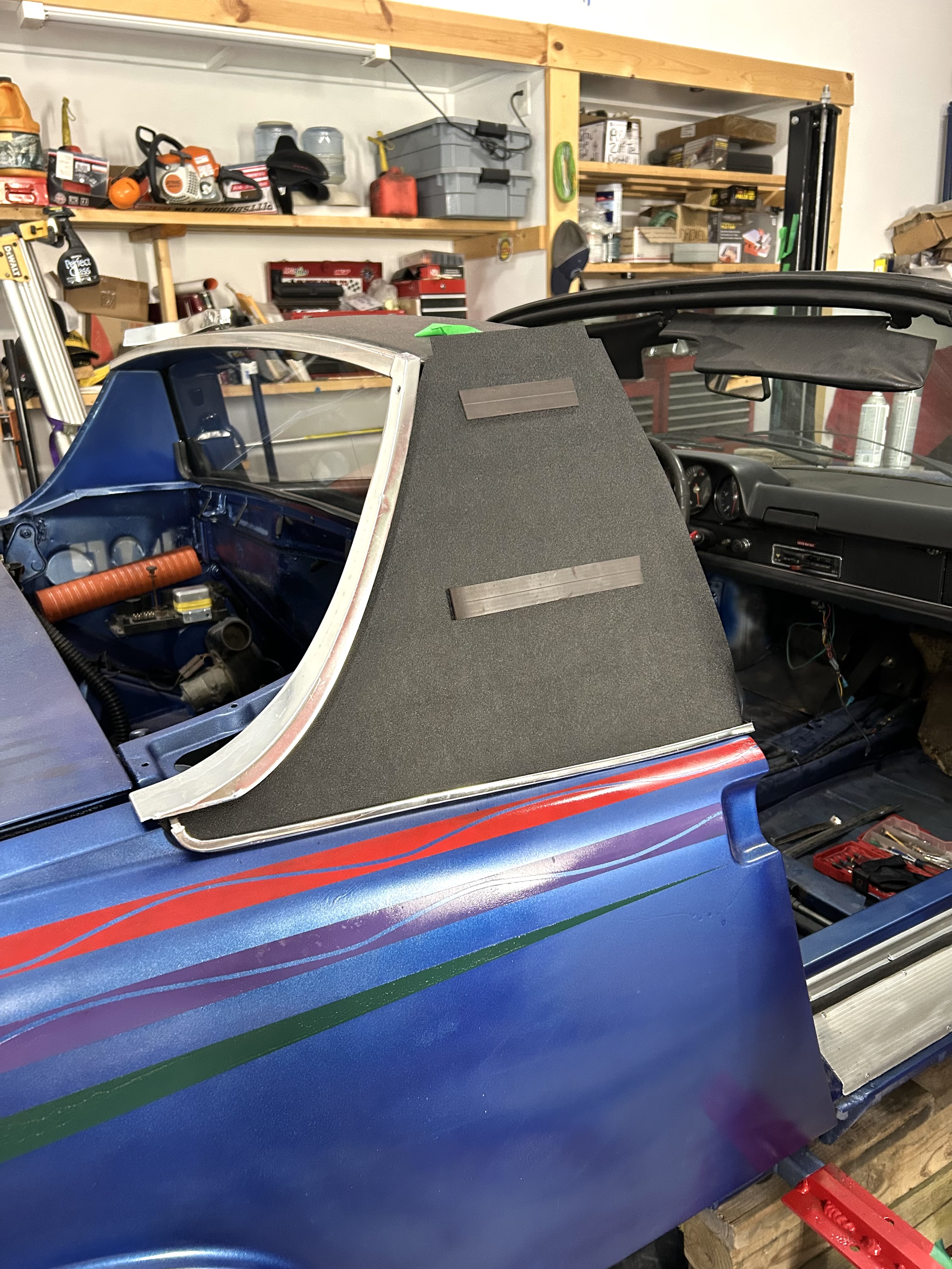

Started on the sails.Attached Image
Trim is just laying there. It does finish the look.
HFC3
post Jun 4 2026, 04:59 PM
Post #76
Posts: 156
From: Virginia
Member No.: 29,151

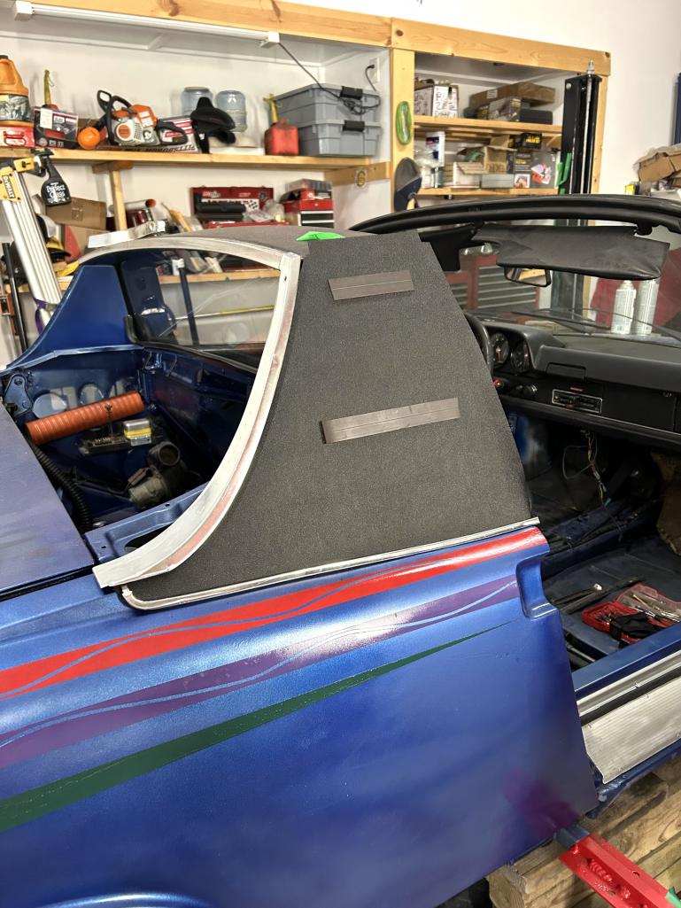

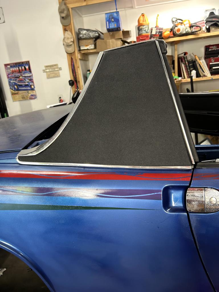

Sail panels and trim completed. Rear suspension is in process. Attached Image

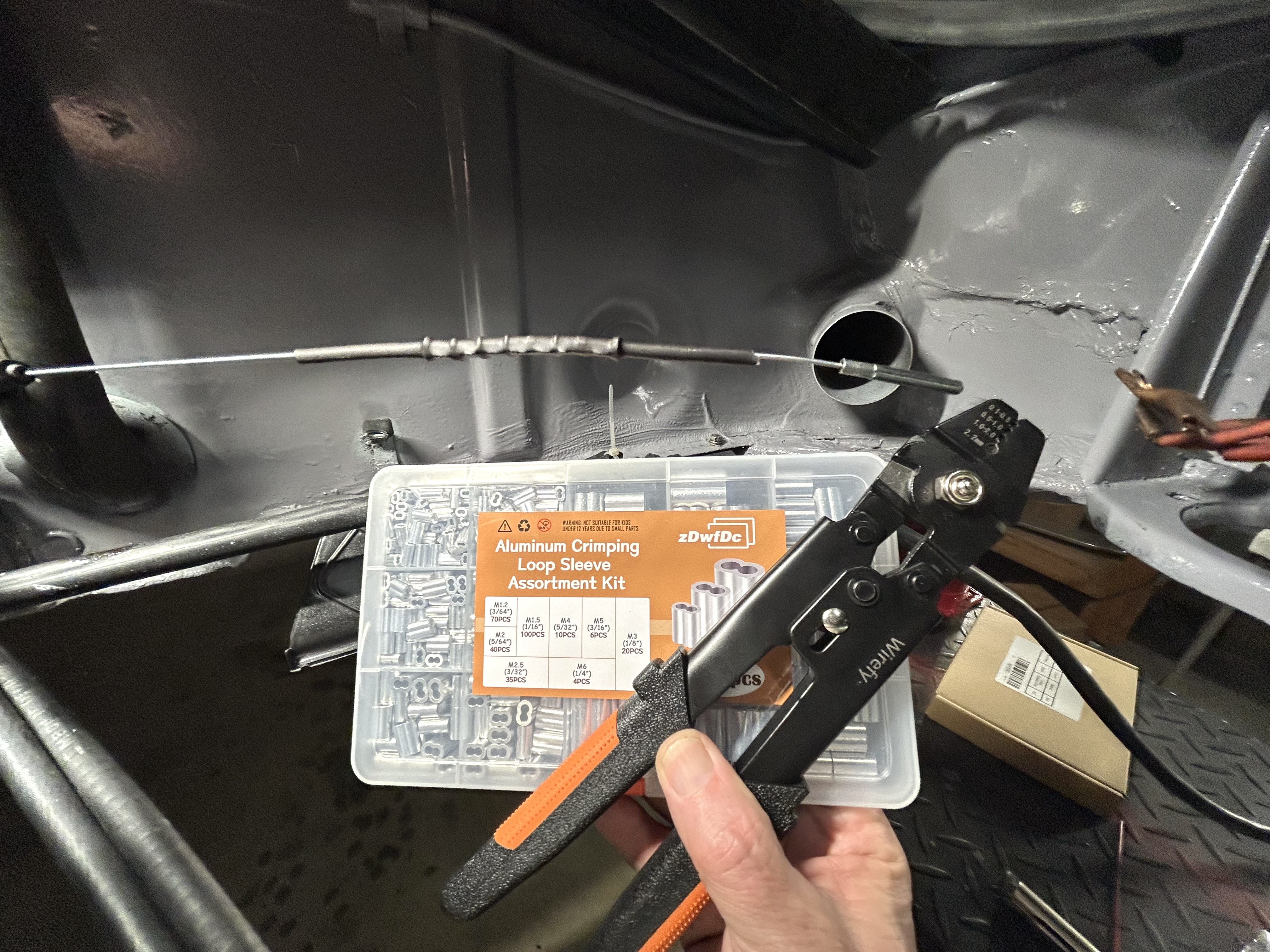

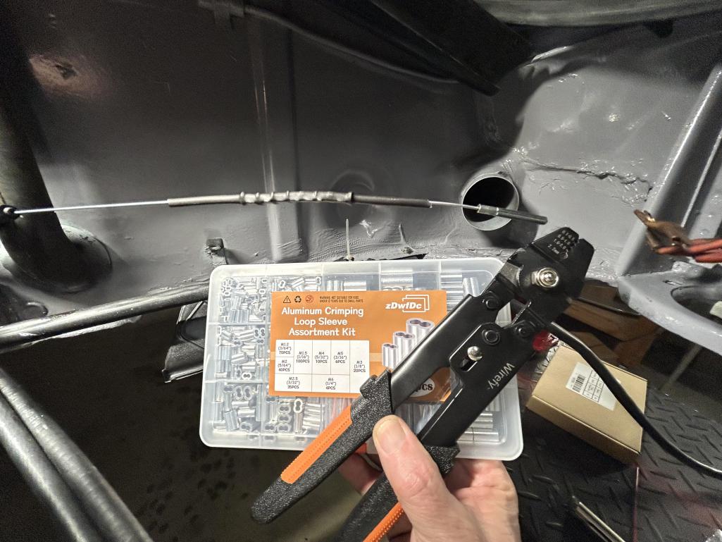

I finally gave up and cut the ends off of my new heater control cables as I tried four different ways to sneak them through and they would get in a bind. I’m not sure if the tubes were bent at some point.
Feeding the wires with the ends cut took about 30 seconds
Then I used Aluminum sleeves to reattach

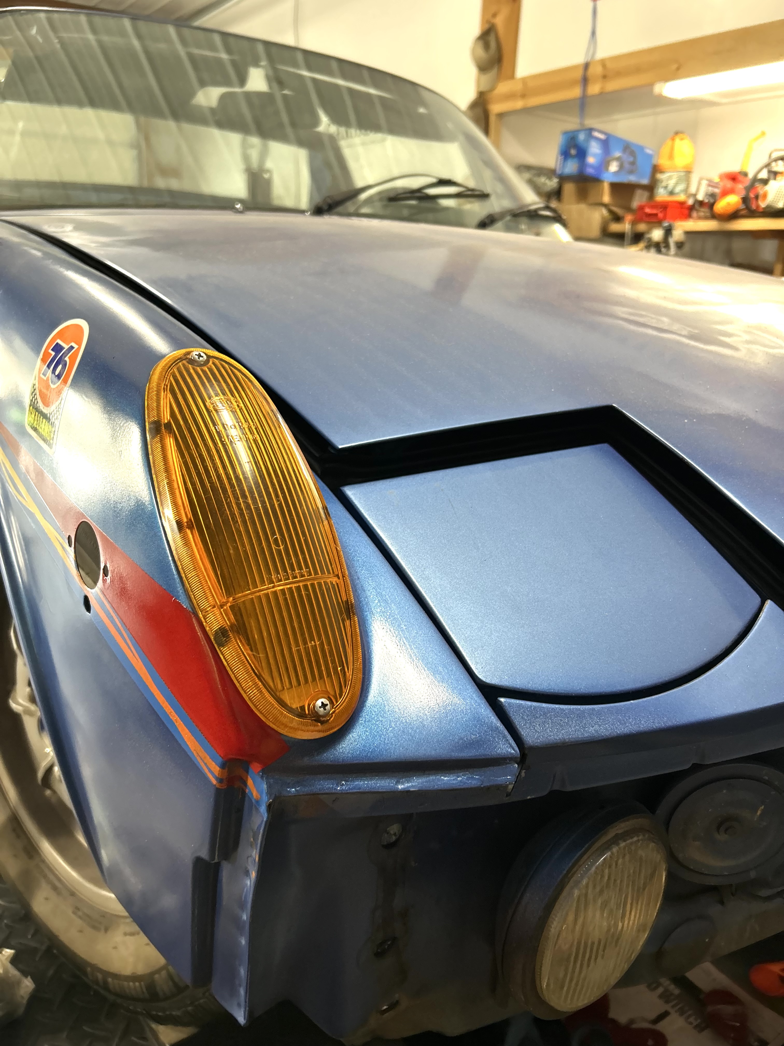

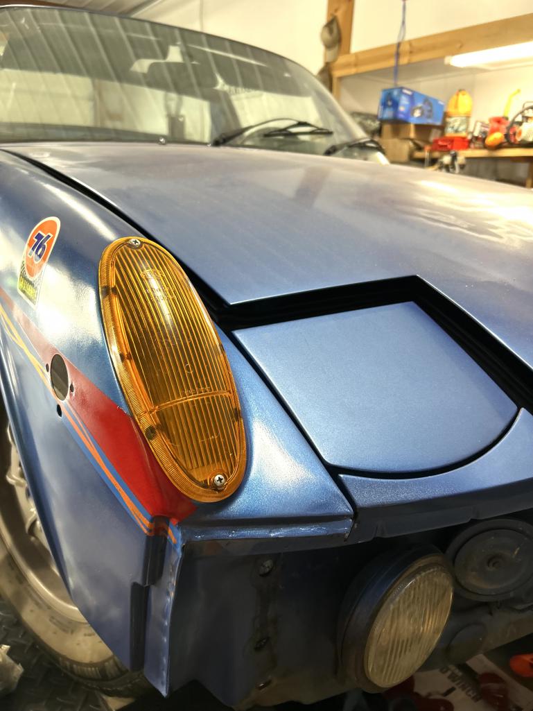

Member No.: 29,151

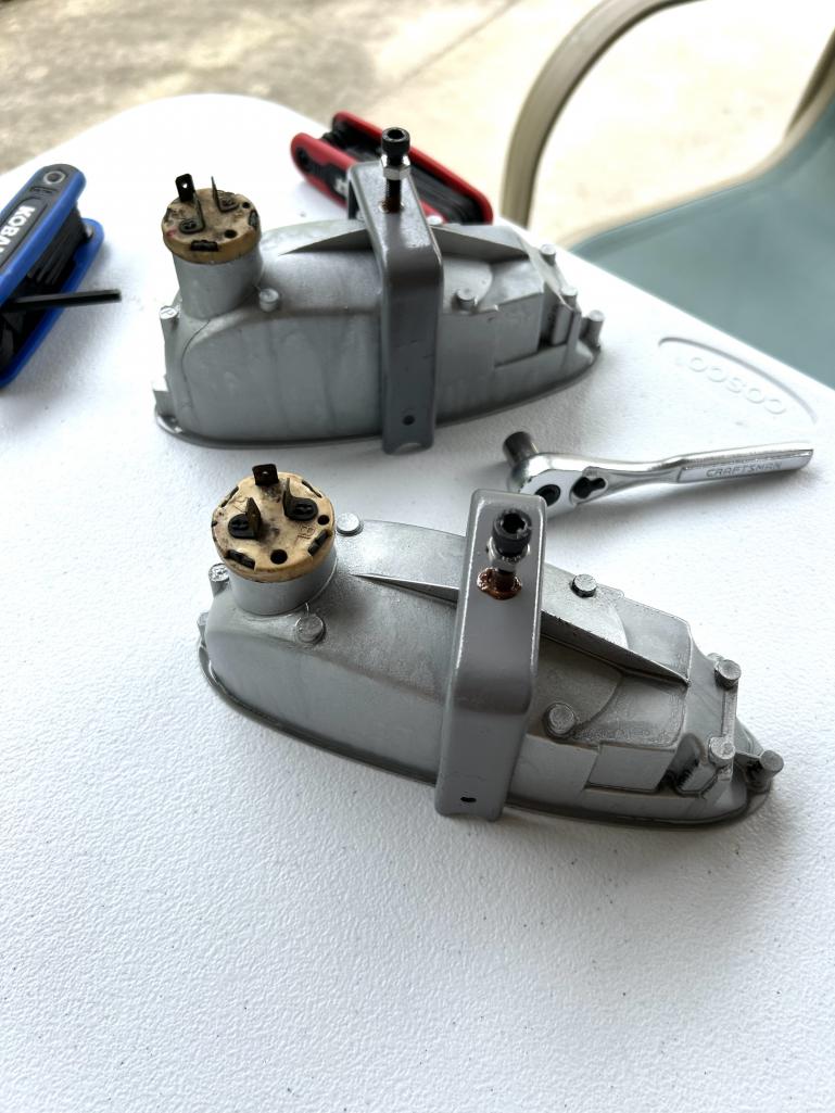

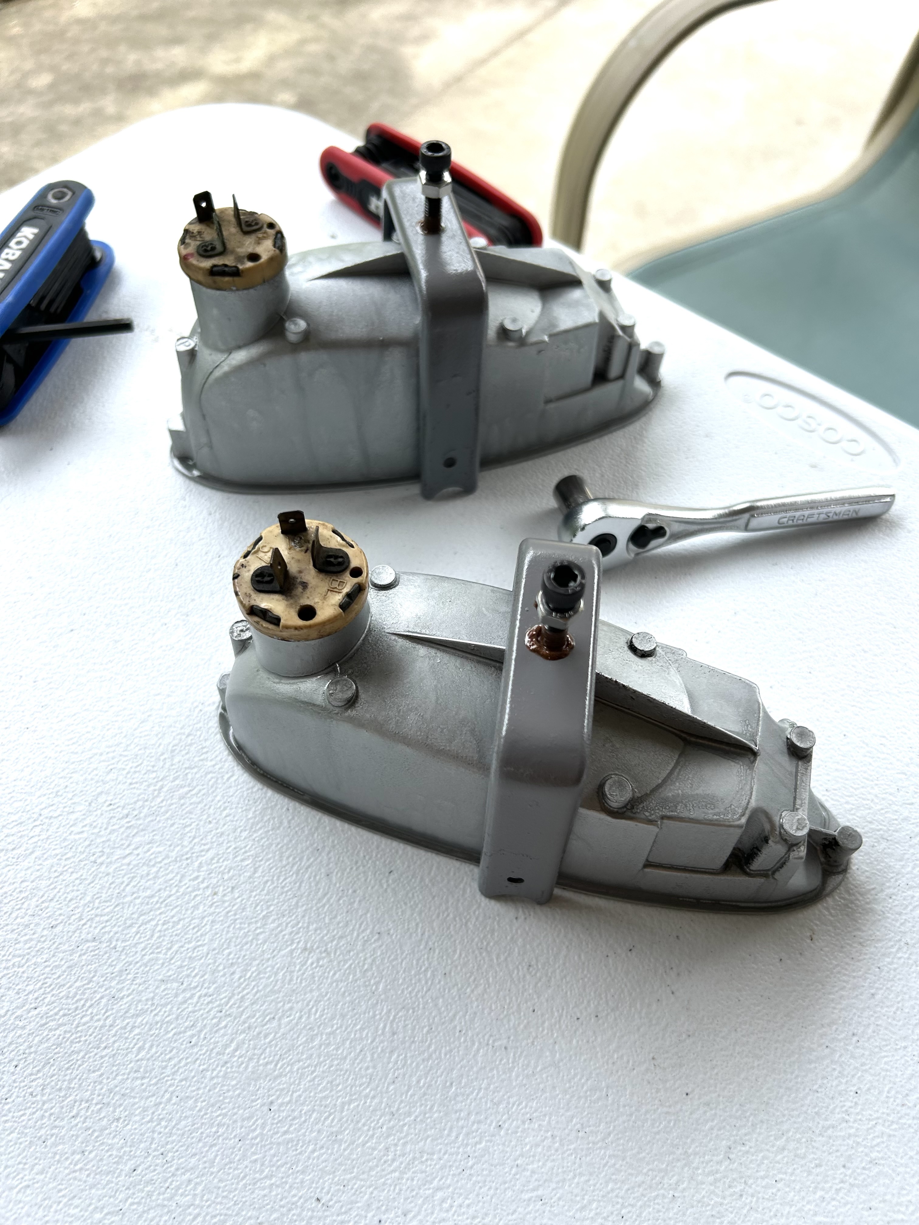

Refurbished parking light housings.
HFC3

HFC3

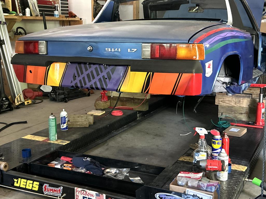

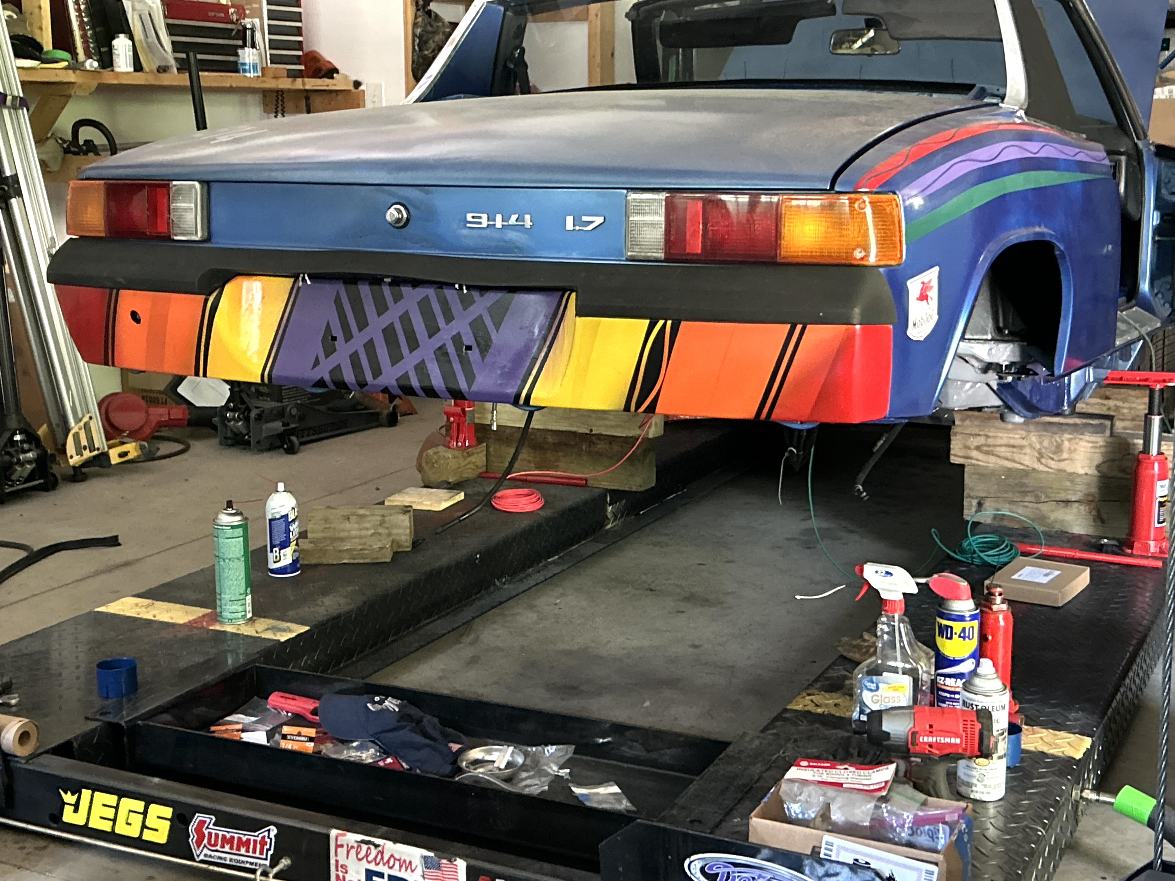

Member No.: 29,151
Finally a complete rear look with taillights.Attached Image
