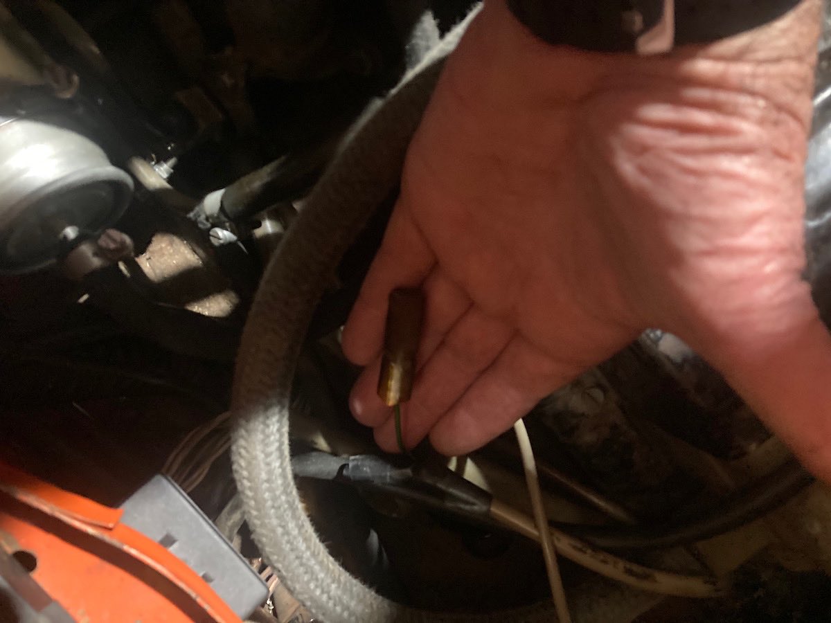

i believe this is the wire you are looking for @TonyA
black and green. has a plastic socket protection cap.
around the battery lying on the engine shelf.
