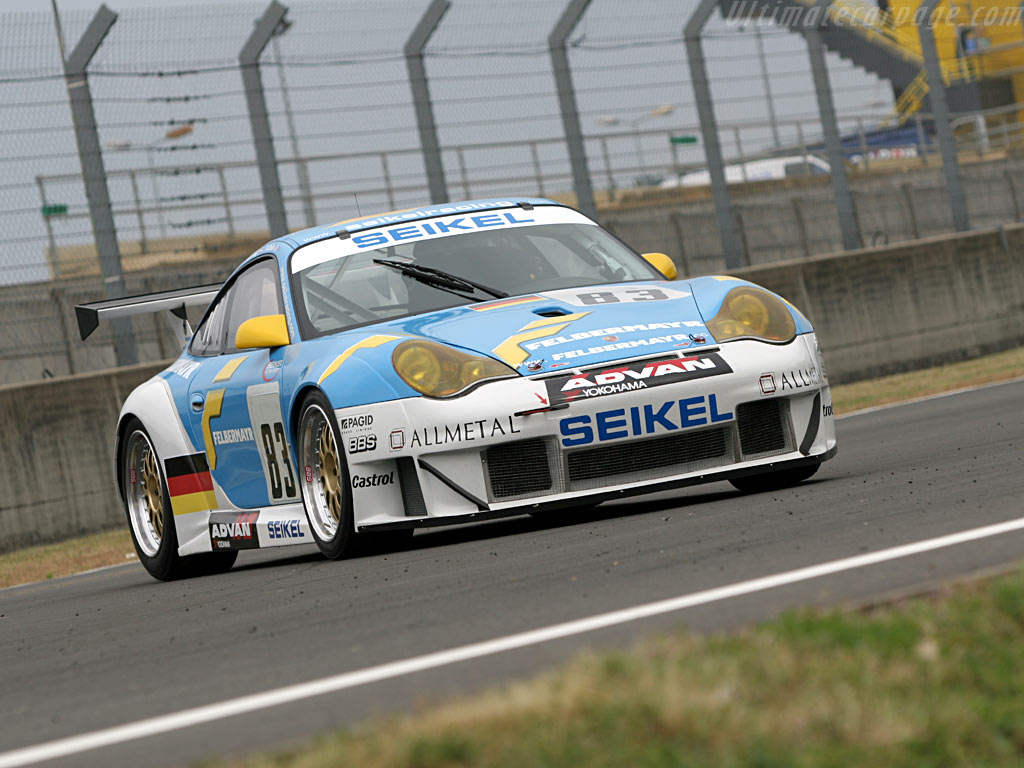

I was looking at some photos of the 996 GT3 car and had a question - shouldn't the flares also bolt up to a Boxster? The rears would have to be modified, but I have seen a ton of catags selling the GT3 bumper for the Boxster - I would think it would be an easy bolt on deal since the 996 and 986 have the same front end. Anyone know?
Here is a pic of the body kit

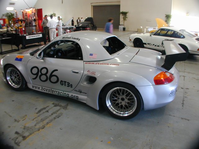

I'm not quite sure the flares are seperate parts
I think (at least the fronts) are complete fenders
the fronts would fit a boxster
rears would require modification (has been done)

Here is one of the Boxster versions that is for sale....

On our GT3RS we replaced both rear quarters
This is why, we have owned that very car for a few months now
the rear quarters are not factory 996 parts, they came from PMNA, and are wider than the stock 996 rears, then you bolt the carbon flares to them
I think the narrow body car maintains the same overall geometry of the fender though. So the GT3RS/RSR flares should match right up
