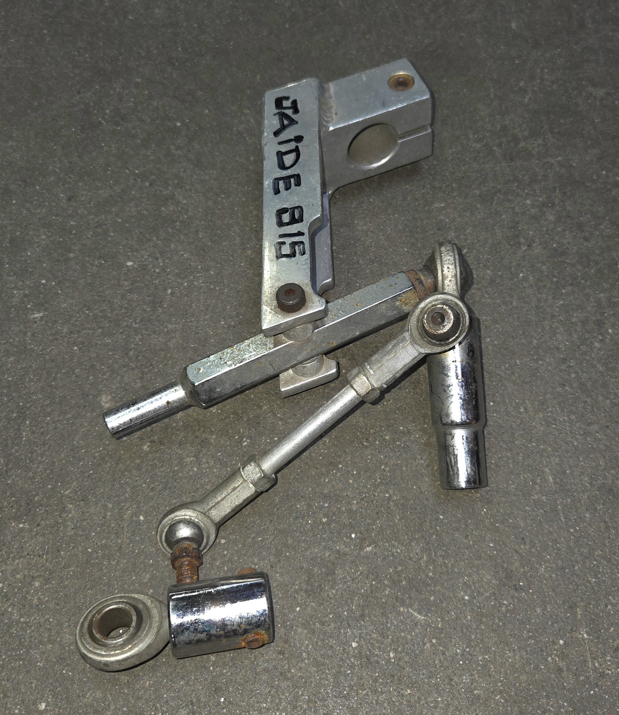

The 20th Century Jaide kit for 915 trans, into the 914.
'Mechanical shift linkage adapter for use with 911 SC/ or Carrera shift console. They also sold the rear 915 to 914 rear undercar bracket to hold 915 into position. I actually saw one on a working /driving 914 at an Aase Motors open house long ago.

QUOTE(Maltese Falcon @ Oct 25 2026, 04:05 PM) *
I can’t imagine that gave a satisfactory shifting experience. Cool that you still had it in your parts archives.

QUOTE(mepstein @ Oct 25 2026, 02:18 PM) *
I've know a few techs at different independent Air Cooled shops in those days: some of them wrestled with the Velios 915-to-914 shift kits...constantly adjust + re adjust. Adequate gear selection at best.

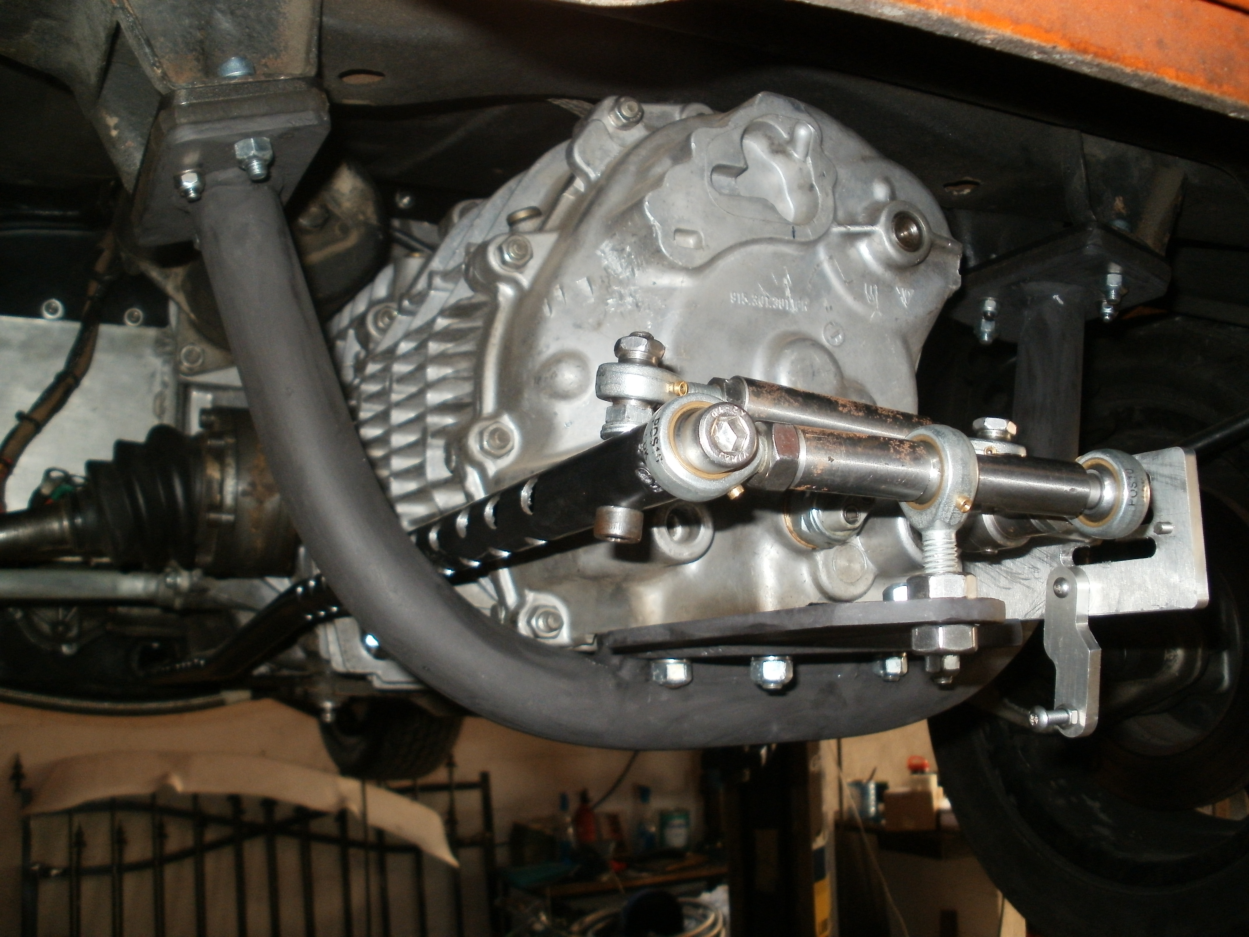

15 years ago, I put together this setup using the original gear lever from a Porsche 914 2.0.

QUOTE(erwan914 @ Oct 25 2026, 11:38 PM) *
That looks interesting!
I like that! Maybe with a better cable shifter?

Erwan. That looks really slick. Fully adjustable and tightly restrained.
How did it work?
Where there is a will there is a way! Elegant piece of engineering there!

QUOTE(gereed75 @ Oct 26 2026, 04:44 PM) *
How did it work?
I had spent a lot of time putting this assembly together, but the results were very successful.
