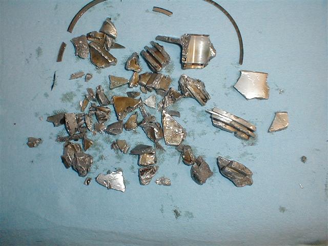

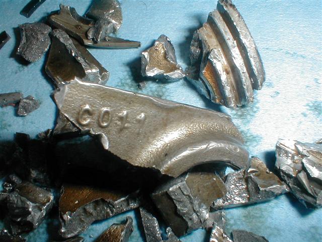

Look what I found when I finally got the courage to empty the sump on the 2.7 - 6 ...
Eddie914
post Sep 13 2005, 02:00 AM
Unregistered
I think it may need new rings!

BTW- Nice piston above.. looks like a dropped valve to me... I thought sixes didn't break, WTF??
