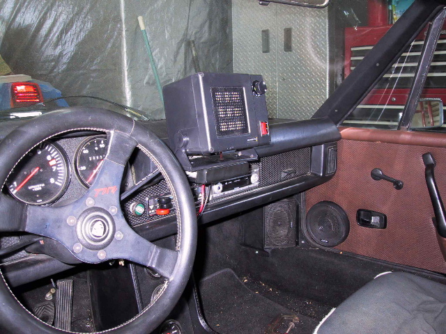

This one does a pretty good job at temps in the 20's you wont cook but your cabin will be warm. It needs to be hardwired to the battery. I mounted it to a spare ashtray.

That's not a resistance heater in the middle of the dash,
That sucka's a mini-microwave.....
Always have hot coffee and donuts with one of those, (IMG:http://www.914world.com/bbs2/html/emoticons/ohmy.gif)
Extra heat if you leave the door open while it's running..... (IMG:http://www.914world.com/bbs2/html/emoticons/blink.gif)
