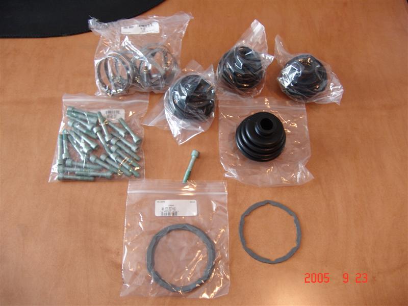

Grimstead
post Sep 23 2005, 06:11 PM
Cheaky Monkey
Posts: 835
Joined: 20-March 05
From: Corona, Ca
Member No.: 3,789
Thanks for the feedback everyone. In the beggining I was hesitant for the same reason Jeff had but hearing the rest of you (Paul) I gave it a shot.
So far I am really glad I did. I bought on the afternoon of the 19th and it showed up today, not bad in my book. Everything looks good. The one thing that really stands out about these guys (getcoolparts) was that they even left feedback for me right after I paid (seems most sellers nowadays, wait to see what kind of feedback you leave before they leave before they do, if they do). At this point, they have a new customer.
Aaron Cox
post Sep 23 2005, 06:12 PM
Professional Tinkerer
Posts: 24,548
Joined: 1-February 03
From: Corona, CA
Member No.: 219
you have a messy job ahead of you...
can you take a close up of the clamps (IMG:http://www.914world.com/bbs2/html/emoticons/smile.gif)

Grimstead
post Sep 23 2005, 06:19 PM
Cheaky Monkey
Posts: 835
Joined: 20-March 05
From: Corona, Ca
Member No.: 3,789
QUOTE (Aaron Cox @ Sep 23 2005, 05:12 PM)
A. "We" have a messy job ahead of us (Sucks to be my friend huh?).
B. Just put the stuff in the garage, I'll take some more tonight (or you can just come over).
ArtechnikA: Can I resuse my old washers or where can I get new?
Cap'n Krusty
post Sep 23 2005, 06:27 PM
Cap'n Krusty
Posts: 10,794
Joined: 24-June 04
From: Santa Maria, CA
Member No.: 2,246
Wrong clamps. They're gonna cause an imbalance, cut into the boots, and be awkward to install. The Cap'n
Aaron Cox
post Sep 23 2005, 07:15 PM
Posts: 24,548
From: Corona, CA
Member No.: 219
QUOTE (Cap'n Krusty @ Sep 23 2005, 05:27 PM)
thats what i was lookin at.... they lool like hose clamps....
Grimstead
post Sep 23 2005, 07:22 PM
Cheaky Monkey
Posts: 835
Joined: 20-March 05
From: Corona, Ca
Member No.: 3,789
Yeah, those are hose clamps, any pictures of the correct clamps?
ArtechnikA
post Sep 23 2005, 09:18 PM
rich herzog
Posts: 7,390
Joined: 4-April 03
From: Salted Roads, PA
Member No.: 513
QUOTE (Grimstead @ Sep 23 2005, 08:19 PM)
they perform a very important function. ask any of the guys who've had bolts back out at speed...
they're available here for example, or any of the usual suspects, or McMaster-Carr.
8mm Schnorr washers. the factory used about 6 kinds of lockwashersw throughout the car. with all those to choose from, they used Schnorr washers in only this application. they'd have used one of those others if they'd been up to the task.
as we've seen recently, it's a good idea to re-torque after some time (a week?) in service.
