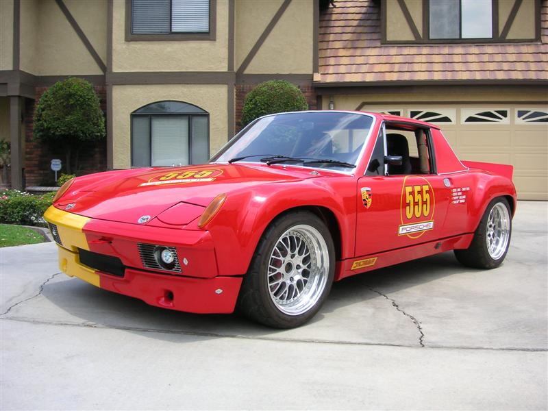

Decided to remove my dual coolers from the rear and locate new big cooler up front.
Production car rules will not allow cutting up front sheetmetal for GT style cooling.
Think we could fit a big cooler in this spoiler "without" cutting metal behind? Also worried about getting enought flow thru the cooler without ducted exit from cooler.
And if anyone know, is this spoiler legal in production class?

I thought SCCA rules allowed ducting for an oil cooler in front to be added? Cooling the oil used to be in the realm of "safety items"? When I checked with them years ago about my added dry sump/front oil cooler, I was okay'd since it was "not a downforce device". The ones that exit the top of the hood I was told were not legal as they added substantial front downforce. I think there are some vintage organizations that do not allow it but they usually don't let 914s in either??!!

yes, it will work and in fact it works surprisingly well as long as there's some place behind the cooler for the air to go,
like towards the bottom. might need to cut some of the FG ...

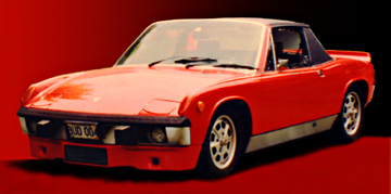

dunno if this spoiler is legal, but usually anything that doesn't extend passed the stock front of the car is OK.
that's why some guys run the '74 bumper-tits on their cars, to gain some more useble space in the front as it allows you to extend stuff (spoiler lips etc.) further out ...
like on scotts car, a '70 original /6, see pic below ...

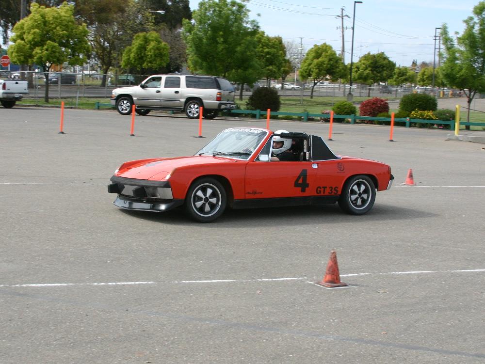

I had my guy make a mold incorporating the bumper and spoiler into one peice. Easy off and easy on!

Xit,
Can you furnish a close up?
Your front end appears to be two piece ? I can replicate for members if you have the mold...

I'll shoot a close up this weekend. It was made from 2 peices that were bonded together. We then made a mold from that peice before we painted it.

Dan, are you thinking of making/selling the bumper/spoiler combo through 555? Looks great!
