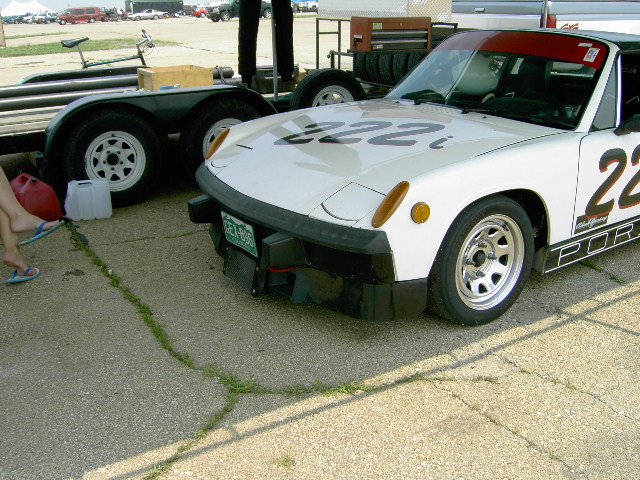

QUOTE (brant @ Sep 15 2005, 12:37 PM)
A colorado guy... Dale Tuety runs a cooler in his spoiler with no cutting.
Probably will see him tomorrow at a club race.
I'll try to get pictures of it if he is there.
His is a trailered race car, and man that cooler is down low... but it works and works well.
I wouldn't do it on a street car is such a volunerable low location, but on a race car like yours its very doable.
brant
Brant, I only have two pics of his car. This is the better of the two. That cooler is down lowwwww. Dale said he hadn't had any problems with it, and was very effective. helluva nice guy and driver.
machina

thanks kurt,
I was thinking about cutting the stock valence like that and fg in a cooler grille.
pic helps alot..
