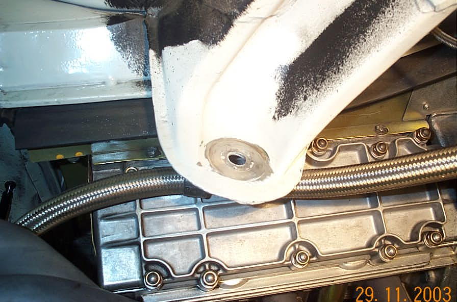

Modify the hard line that comes with the 2.7 . After it turns 90 around the front of the engine cut it off weld on a steel -12/-16 male fitting . Less braided line and nice steel hard line past the headers. 2.00 fitting verusus 25.00 fittng and easier to work with . engine R/R

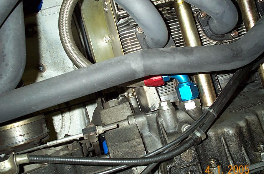

Turn the 90 to the rear, run it back past the end of the motor, them go forward. Only pic I've got.

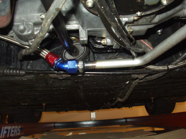

Continued...lots of room for everything. Makes one nut on the cam cover a bit testy, but nuthin serious.

Here is what Jeff (sixnotfour) is talking about. He did this for the 2.7 he built for me. When I first installed it was in line with the shift rod so I had to pull it down a bit. Would have preferred to go above the rod but the bulkhead mount I have would not allow it. I think it is the way to go.
