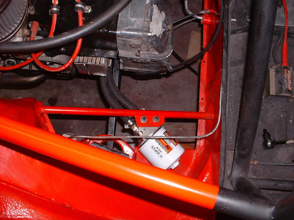

Due to the full flow pump, the oil filter needs to be relocated. So I wanted to keep it close to the engine but easy to get to. So after much thought and trail fits, I decided on this. (see pic) To get it on and off I unbolt aluminum mounting bracket from the angle that is welded to the tubing. I can than spin the filter on/off without spilling a drop of that very $$$ Royal Purple racing oil. BTW, the tube is supporting the inner suspension ear.

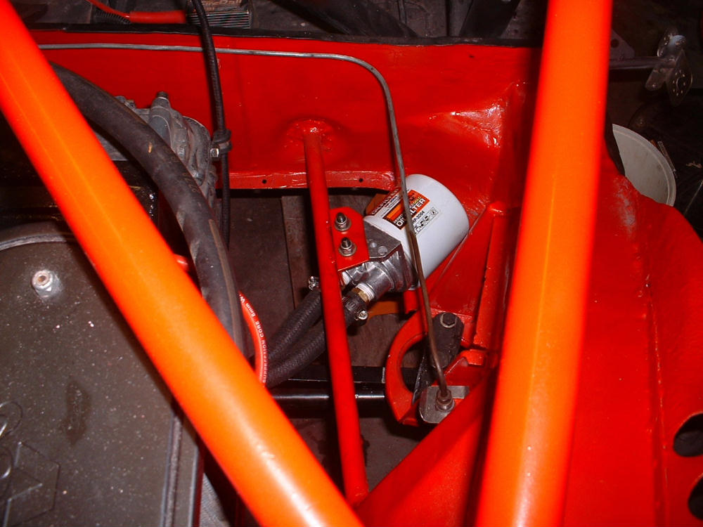

I built the lightest 914 in the history of mankind. ![]() ![]() ![]() ![]() ![]() ![]() ![]() ![]() ![]() ![]() ![]() ![]() ![]() ![]() ![]() ![]() ![]() ![]() ![]() ![]() ![]() ![]() ![]() ![]() ![]() ![]() ![]() ![]() ![]() ![]() ![]() ![]() ![]() ![]() ![]() ![]() ![]() ![]() ![]() ![]() ![]() ![]() ![]() ![]() ![]() ![]() ![]() ![]() ![]() ![]() ![]() ![]() ![]() ![]() ![]() ![]() ![]() ![]() ![]() ![]() ![]() ![]() ![]() ![]() ![]() ![]() ![]() ![]() ![]() ![]() ![]() ![]() ![]() ![]() ![]() ![]() ![]() ![]() ![]() ![]() ![]() ![]() ![]() ![]() ![]() ![]() ![]() ![]() ![]() ![]() ![]() ![]() ![]() ![]() ![]() ![]() ![]() ![]() ![]() ![]() Group: Members Posts: 132,350 Joined: 3-February 03 From: Jacksonville, FL Member No.: 222 Region Association: None |
'nutter pic...

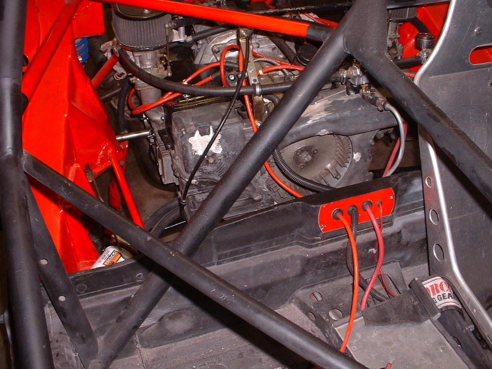

And another thing....
Everybody complains about how hard it is to work on thier engine. Well I've fixed that. (IMG:http://www.914world.com/bbs2/html/emoticons/biggrin.gif) (IMG:http://www.914world.com/bbs2/html/emoticons/ohmy.gif) Attached thumbnail(s)

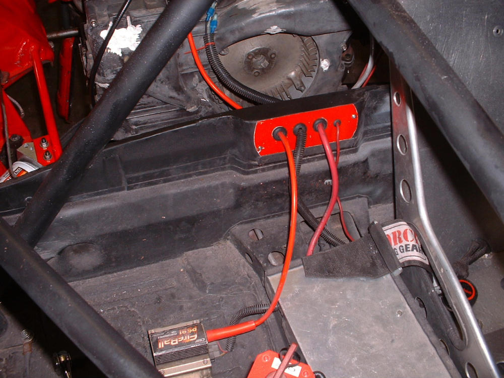

And people complain about all the damn wires in these cars. I fixed that too, I have six (6) running back to my engine (IMG:http://www.914world.com/bbs2/html/emoticons/laugh.gif)

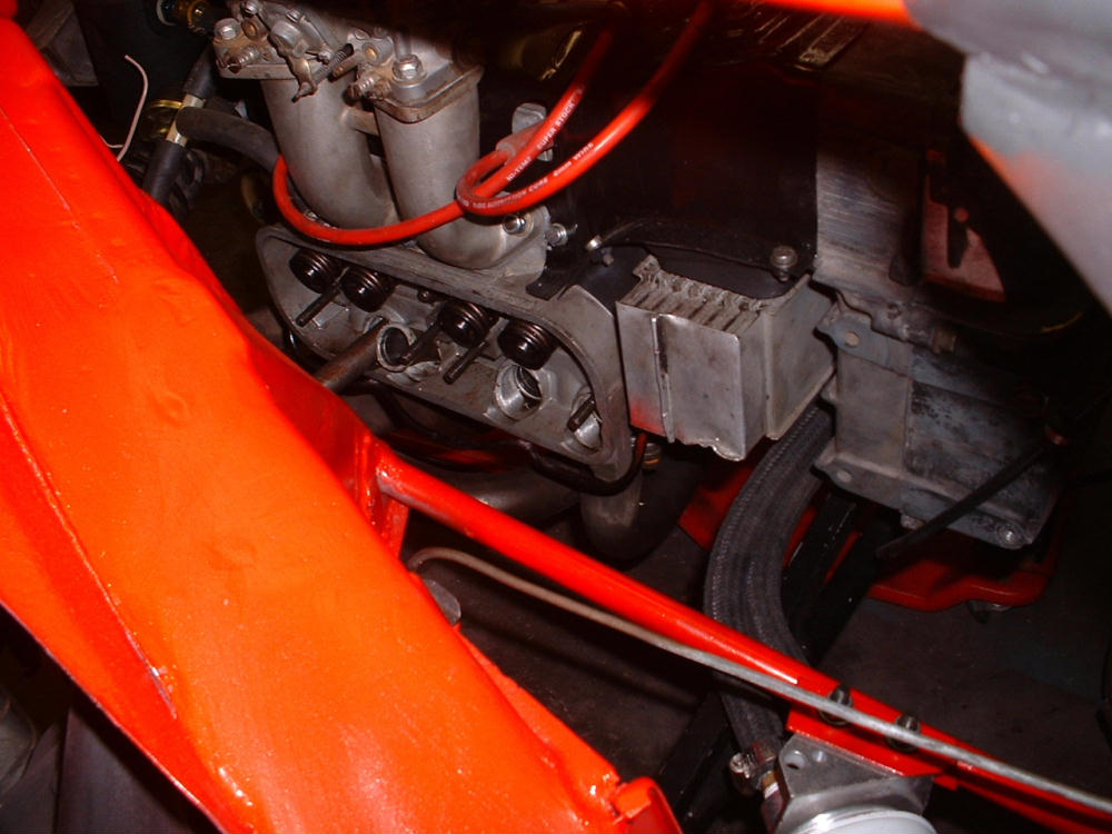

And how many times have you layed on your back to adjust the vales?
Not me, no mo! (IMG:http://www.914world.com/bbs2/html/emoticons/wink.gif) Attached thumbnail(s)

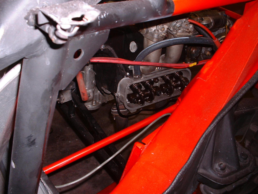

Left side a little closer.
