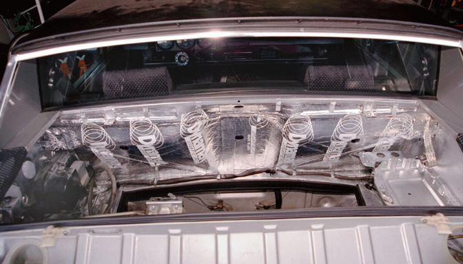

Take the engine pad out and throw it away. Use Dynamat or something like it. Deadens the noise and don't collect moisture. Use it on both sides of the firewall.

Dynamat Super works good. I did this to my car a few years back.

I was actually thinking dynamat might be a better choice. My pad is in good shape without rust, but it seems like inside the bulkhead would be a better place, particularly after I seal the back window with my butyl tape I got today.
