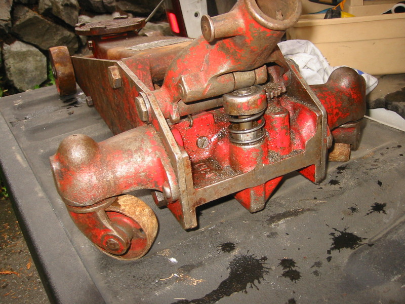

I was just given this floor jack. Mechanically it looks fine, but it does not jack. I closed the valve and pumped the handle. It moves an inch or so. When I release the handle it goes down. I am thinking hydraulic fluid? So where is the reservoir located? I tried the little screw, but the hole is too small. It this a bleeder hole? Next thought was to remove the nut above the ram. Unfortunately there is an E clip above the spring and I can't remove it. I am sure there is a special tool right? If it works it would be a nice score for the $3 bucks it cost for the hydraulic fluid. Thanks, Eddy

SLITS   stand jack upright, pull the screw plug in the pic...   Sep 30 2005, 04:45 PM
bondo   Make sure it's very clean around the plug befo...   Sep 30 2005, 04:54 PM
smooth_eddy   I did tip it up on end and pulled the little screw...   Sep 30 2005, 05:00 PM
bondo   Check the top for a plug, between the handle pivot...   Sep 30 2005, 05:22 PM

SLITS   Put the hydraulic oil in a ketchup squeeze bottle ...   Sep 30 2005, 05:54 PM
kwales   Mine has a large fill hole in the top side of the ...   Sep 30 2005, 06:08 PM
