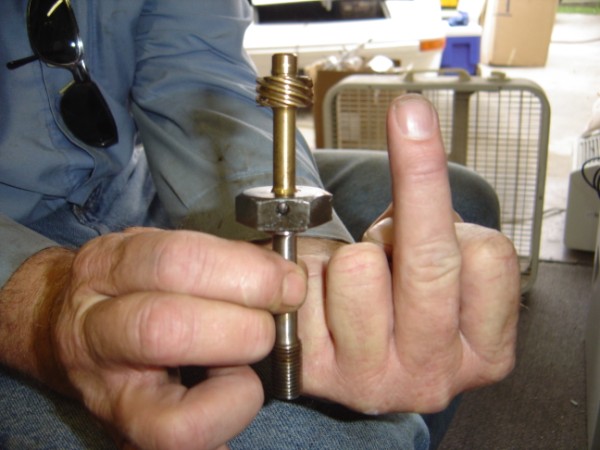

There's a pin that holds that gear to the stretch-bolt that holds the pinion shaft together. Typically you don't mess wit that when rebuilding a trans. A deep socket fits over it and you just keep it all together. Chances are something broke, either the brass shaft or that pin. If the right angle drive isn't installed just right it can bind, which may have caused the problem.

You must be talking about this one. Aaron, this picture was taken for you just now.

QUOTE (skline @ Sep 30 2005, 04:48 PM)
thats the one!

Is there a gear in the end of your angle drive that mates to the one next to your puny finger? If you turn it it should turn the out put blade on the angle drive. If not, then pull the internal gear out and look at it. Interesting.....

thats richards finger.... not scotts....
scotts nails are painted (IMG:http://www.914world.com/bbs2/html/emoticons/biggrin.gif)
