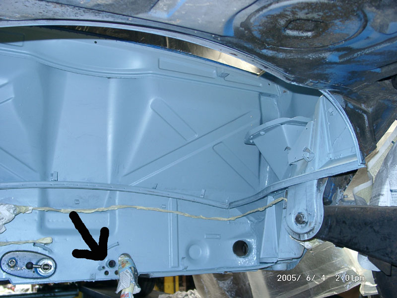

Maybe clutch tube broke through firewall?
Check this :
This can happen if the clutch cable isn“t adjusted properly
