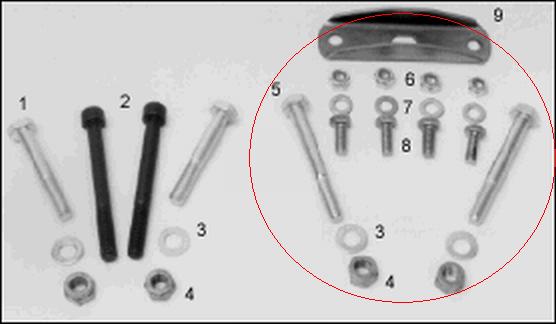

the outboard motor mounts that hold up the engine bar:

how did you destroy yours??
Call pelican... or find a parts car.... (IMG:http://www.914world.com/bbs2/html/emoticons/wink.gif)

Use a pair of these. Competetion motor mount on the Bird.
mount them with the boss pointed up, and the side shifter bar will bolt right up.

QUOTE (Aaron Cox @ Oct 3 2005, 01:38 PM)
both nuts & bolts holding the engine bar in place were heavy seized (IMG:http://www.914world.com/bbs2/html/emoticons/dry.gif) (IMG:http://www.914world.com/bbs2/html/emoticons/sad.gif)

Or make some. Buy some square steel tubing of the right size, saw one side off. Saw and file to shape. Drill holes.

won't that move the front end of the entire drivetrain upwards about .75" ?

I'm cheap and the hardware store is the cheapest (and quickest) source for parts! Just make sure you buy a new hacksaw blade. They're cheap too, and a new one will make a world of difference. Get 18 or 24 teeth per inch, no more.

sadly, ive only got a jigsaw. (IMG:http://www.914world.com/bbs2/html/emoticons/dry.gif) BUT a metal cutting blade on that thing works just fine. Does anyone know the size and length of the bolts that are required for this application?

Mister PET says:
N 010 472 4 BOLT HEX-HD.M 10 X 85 (that's the big bolt through the middle)
900 075 085 02 BOLT HEX-HD.M 8 X 20 (those are the little ones through the sides of the mount)

Get a hand hacksaw. They're cheap. And with a sharp blade, with a low tooth count, it's amazing how quickly you will saw through square tubing. I'm sure people don't use hand saws only because they've never used one with a good fresh blade.

now for sure im gonna make these mounts rather than spending $20+ on a set (IMG:http://www.914world.com/bbs2/html/emoticons/wink.gif)

could someone get the dimensions of piece #9? TIA! (IMG:http://www.914world.com/bbs2/html/emoticons/smilie_pokal.gif)

takle a piece of thick paper....
put it against theouter body mounts... and trace the 2 small holes.
then MEASURE the distance, center to cener of these holes.. and mark the middle. now drill your big hole

$20+ seems alot easier to me. i'm sure i have a box load of them. for the +, i'd even run them through the bead blaster, you pay shipping.

I PM'd you that I have the mounts minus the bolts but got no reply. Perhaps I should have mentioned that they would only cost you the actual postage. (IMG:http://www.914world.com/bbs2/html/emoticons/huh.gif)

I'm pretty sure that Priority Mail would be $3.85. They don't weight much. I can dig them out tonight box them and calulate shipping if you let me know your zip code.
