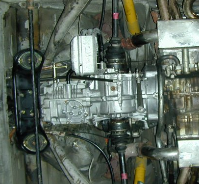

i have such a transmissionm a 915/67. not installed yet - it is intended for the 911. i can take whatever photographs or measurements you'd like.
the cooler loop is *very* soft, ribbed brass or aluminum; i think you could bend it pretty much any way you liked. it fits to the transmission with O-ring seals and i think it'd be "almost" trivial to use real fittings to run hose to a proper radiator-style cooler mounted anywhere.
here it is mounted in a 911 - it's over that duct/rockshield top center left.
