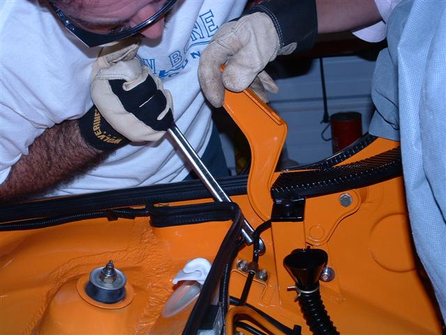

transitioning from the 1/4" extension to the notched adjustable wrench in my right hand. Susan was holding the hinge up out of the way for me.

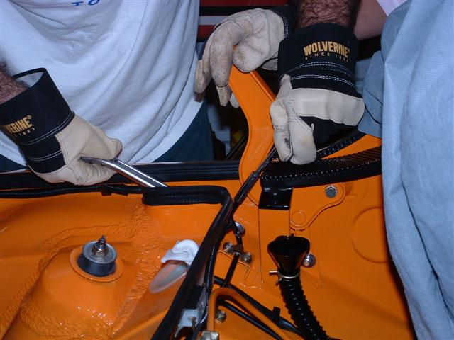

Using the notched wrench to push the torsion bar forward. Fair amount of effort required here. This wrench works really well for this task -provides good control.

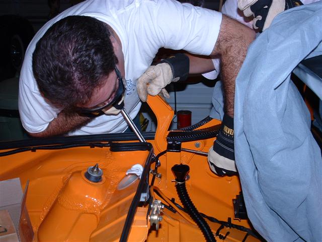

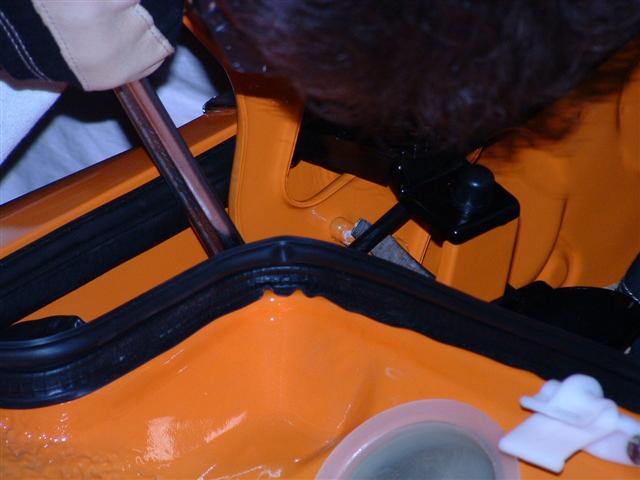

Reaching in from the engine bay with a large screwdriver to use to wedge the torsion bar around the roller pin.

Screwdriver used to pry the bar around the end of the roller pin. This is the trick that I was missing last night.

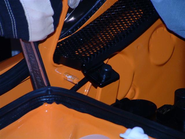

Torsion bar on the back side of the roller pin! (IMG:http://www.914world.com/bbs2/html/emoticons/biggrin.gif)

Slipped the roller on the pin, cautiously eased up on the tension applied by the notched wrench and success!!!

This is a nice picture representation of the procedure I described. The only difference in how I do it is I put the screwdriver in from the top, and hold it and the hinge with one hand.
(IMG:http://www.914world.com/bbs2/html/emoticons/idea.gif) How about a metal or nylon wedge that can be slipped over the pin. Then just pull the torsion bar up and it would pop into place by itself.
