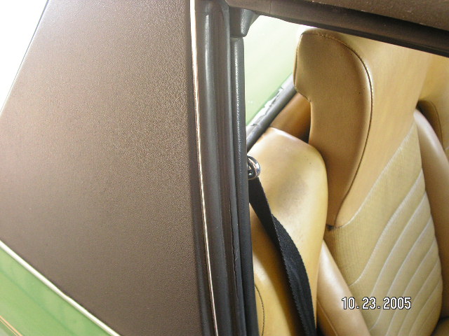

My stock rear window seals are glued, not screwed.

Looks like the channel is there to me (the bright metal piece). The rubber slides up and out, revealing the channel screws underneath.
