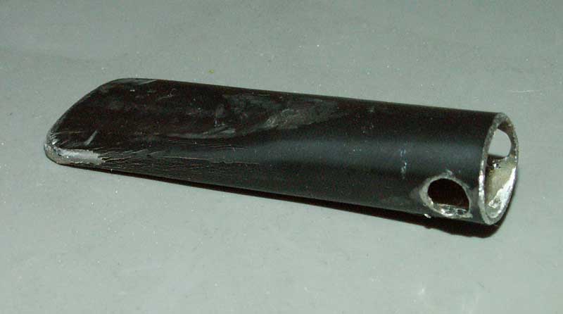

I made a lever out of a piece of tubing. Drilled a hole through one end that fits over a pin that I welded to the door. Flattened the other end and smoothed it out.

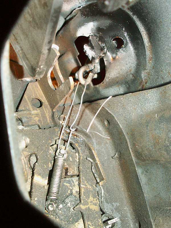

Welded a hook to the lever that goes inward. A wire loop runs between the hook and the release latch inside...

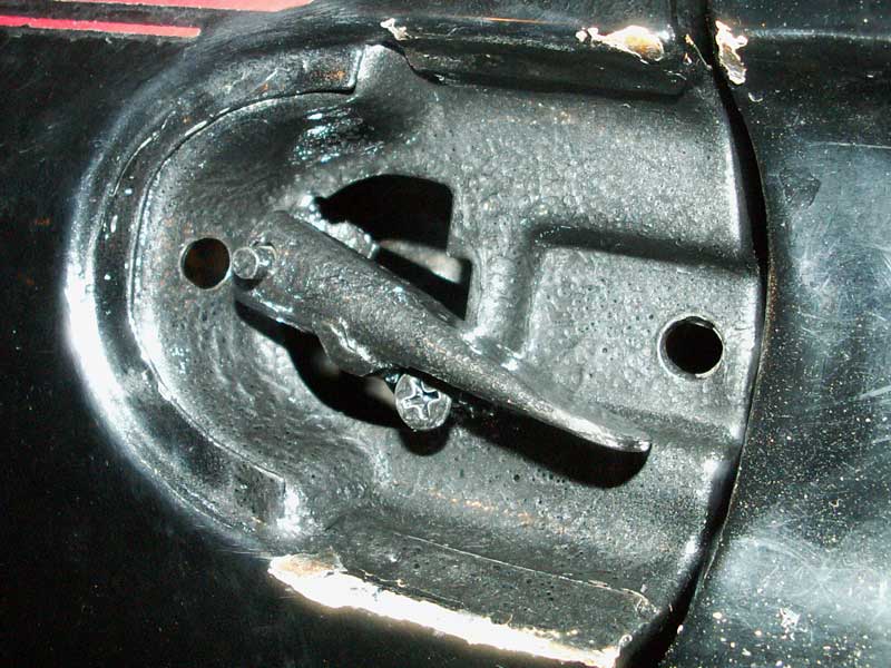

Lift up on the lever to open, the spring returns it to the bottom stop...

Weld a piece of sheet metal across the surface to shave the door handle, and the crude design is hidden for a clean look. Keeping the recess behind the door makes it convenient to reach a finger behind and lift the latch. It releases easier than ever and won't break.

I like it....the wire looks a little on the thin side.....

Yeah, the wire in the photo seems a bit hoaky. I was planning on making a nicer piece there... maybe washers welded to the ends of a piece of small rod. But it lifts so easily that my temporary wire isn't stressing at all. Maybe I'll get around to upgrading that piece later. (IMG:http://www.914world.com/bbs2/html/emoticons/smile.gif)
