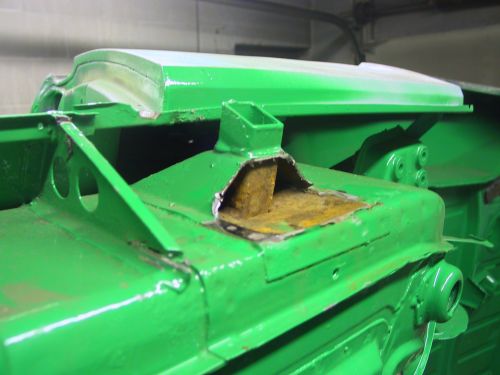

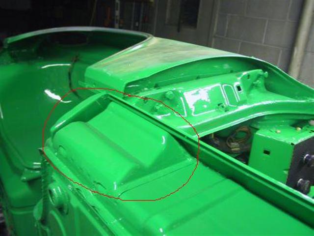

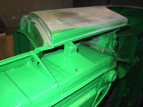

Today I figured that the most important thing I need to do, at this stage is to get the tub fixed. I'm not doing the remaining flares myself, but the other stuff I want to get done before the tub goes to final paint.
That includes:
1) making holes for the front swaybar
2) a hole in the firewall (I know this is controversial, but a number of GTs had this)
3) organizing the driver-side long to allow oil lines forward.
4) getting the muffler heatshield ready.
I started with No 3.
First a couple of pictures of the long, before I molested it:
michel richard
post Nov 1 2005, 09:12 PM
Posts: 1,291
Joined: 22-July 03
From: Longueuil, Québec
Member No.: 936
The forward part:
michel richard
post Nov 1 2005, 09:14 PM
Posts: 1,291
Joined: 22-July 03
Member No.: 936
And the jack point after I cut it.
I now want to POR-15 it, so that I cleaned and etched it. POR 15 will go on tomorrow.
That's it for this evening.

why did you cut out the jack post?
didn't the oil lines have a kink at that point?

On the 4 cylinder cars, the tubes that go down the driver side longitudinal are fuel breather lines, or fume recirculating lines, or something. The brass oil lines for oil cooler equiped cars are much larger diameter.
Jeroen,
Yes the lines have a kink, but the jacking post support still has to be modified to let the lines by.
db:
The front of the longitudinal is stock, it's always shapped like that.
Michel
