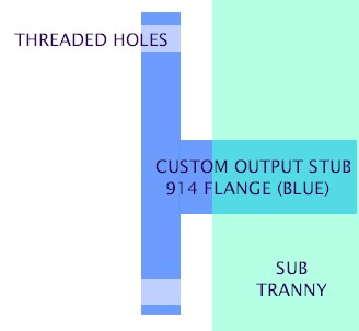

here is a rough drawing of a custom output stub with flange

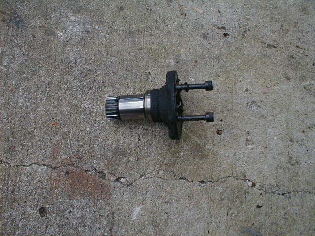

914 output flange

QUOTE (jimkelly @ Jan 23 2006, 06:19 AM)
As I understand it the stubs are removeable. How much room the there between the 914 axle flange and the tranny? Maybe all we need is a custom output stub that has a flange?
How far does the output stub protrude from the sub tranny?
Jim
My trans isn't missing the stubs - the whole thing is one piece. Stub-CV-Axle all of this is one piece. I have seen the stubs for sale with an aftermaret diff do I don't think it really matters how the solution is made it should still fit all of the transmissions.

nsyr
post Jan 23 2006, 03:22 PM
Post #126
Because I Can
Posts: 314
Joined: 16-May 04
From: Tampa, FL
Member No.: 2,073

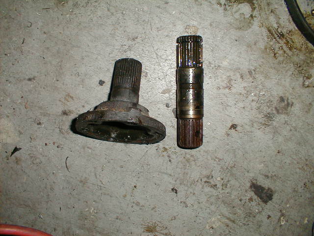

another idea: drill out a hole in the this flange and hammer in and weld the suby output stub on it. do you think it could handle the stress? (IMG:http://www.914world.com/bbs2/html/emoticons/unsure.gif)

forgot pic

I think I know what was going on with my lack of stubs in my trans. The flunky that removed the axles just yanked them out with the stubs still attached and the axles I got were so rusty that I did'nt notice the stubs were a separtate part.

Cool - we all have output stubs (IMG:http://www.914world.com/bbs2/html/emoticons/aktion035.gif)
nysr - nice to see a pic of an actual output stub removed (IMG:http://www.914world.com/bbs2/html/emoticons/wink.gif)
With output stub removed - how much space is there between sub tranny and end of 914 axle/cv ?? Sounds like you think there is enough room for a solution here.

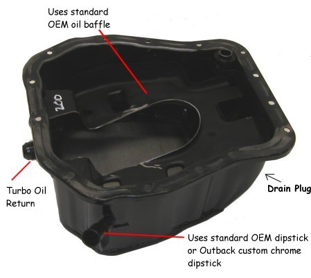

Shortened pans - looks like it is requred to be done - so either we do it ourselves, have it done locally - or buy from sharpbuilt or from other aussy dudes? How much does sharpbuilt want for their shortened oil pan and sump pump? It is nice because it holds full amount of oil!! Jim

outback with shorten pick up and an fitting for turbo $250 ish

The outback pan is nice, and they say that they can do knock-outs to expand the capacity. I'm doing my own expansion and taking it to a shop to have it welded. I'll post pictures in my progress thread once I get some more done on it.

Reply from Sharpbuilt ... whose oil pan is widen to hold full quantity of oil!!!
Hi Jim
> What is the cost for your SUPA SUMP oil pan and sump pump?
Supa Sumps are $320 US exchange and $30 to shorten the oil pickup (total $350)
> Do you have a discount for multiple orders?
On 3- 5% on 5-10%
> Is the same pan used on ej22 and ej25 normally aspirated engines?
Yes the same
Regards Mike Sharp
http://www.sharpbuilt.com.au
The option is http://www.outbackmotors.com/oil_pan.htm
Who charge $250 and they even advertise they sell the kit if you want to cut and weld yourself. quote "Kit's for this area available too if you want to do the work of chopping and welding yourself."
