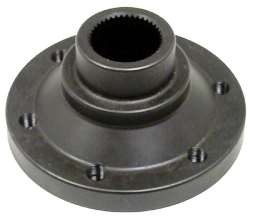

I think the 944 CV setup that Clay posted awhile ago is the way to go for this swap. Cheap, stronger and you can actually buy new CV's. Look here at andy's thread -
944 axles
Using this combination allows you to go 5 lug if you use the 944 parts on the axle end or leave the axle end alone and just use the 944 inners and the "magic part" that adapts the 944 CV to the Suby trans.
Here is the "magic" part
BTW I just bought a 94 FWD Legacy trans for $200 - it's in Oregon but my parents are driving down to see the baby tomarrow so they are picking it up for me on the way! This is what the stealer wanted for just the rear case and I had to order it from Japan and wait 6 weeks. According to the junkyard search program there are no FWD Legacy transmissions in California, I guess most people that wanted FWD bought autos.

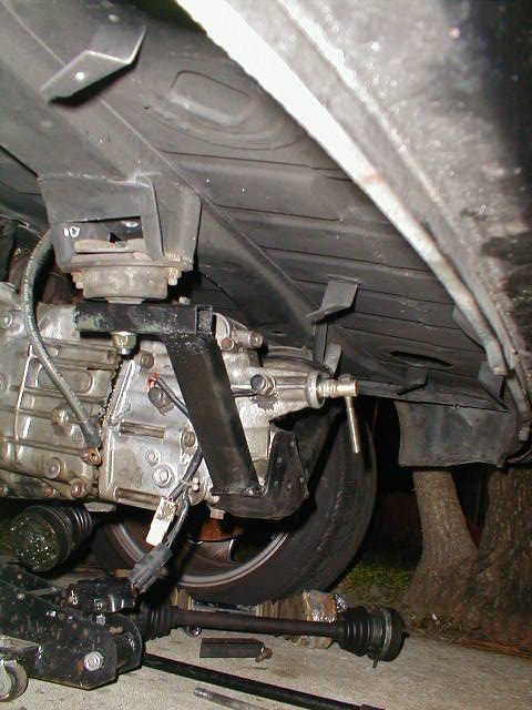

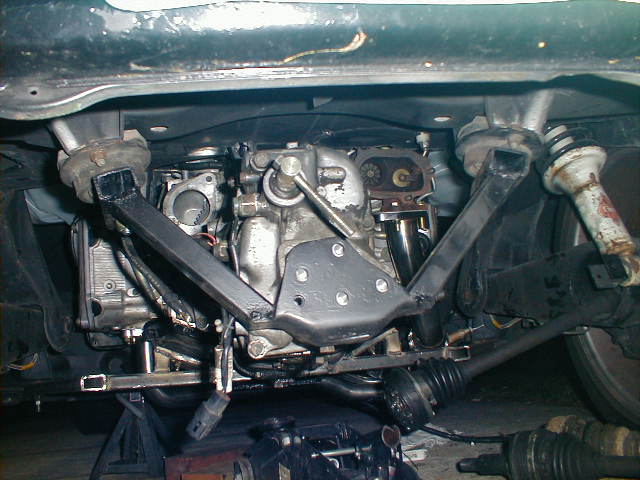

Here is my rear tranny mount for the fwd version

i used part of the original tranny mount

So - what is the "magic part" - it's a VW bus cv adaptor flange that the off road guys use, just need to have someone make it with the correct Subaru spline and drill a hole for the roll pin and were done.
Of course you can always weld up something like we were discussing before.
welded CV adaptor flange
These are for Z-cars and seem to hold up well to lots of power. I have already emailed them for details.

You are definately going to need shorter axles. the 914 axles are just to long to use with a suby transmission. i have a set of early 924 axles that i will be using for the welded flange deal.

QUOTE (nsyr @ Feb 8 2006, 04:45 PM)
That's what I am looking at doing. I want something like that in the rear and also run tubes forward to the engine to form a 4 point cradle that will hold the engine up when the transmission is removed.
