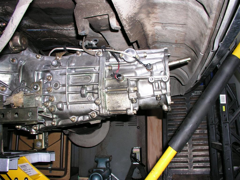

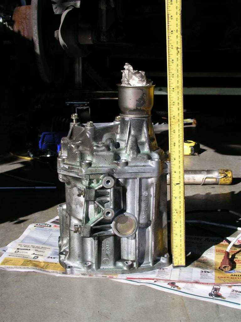

Not done yet, look at the difference between the FWD and the AWD transmissions in the car.
FWD from Andrew
Porcharu
post Feb 8 2006, 07:20 PM
Post #222
Posts: 1,314
Joined: 27-January 05
From: Campbell, CA
Member No.: 3,518
AWD from my car

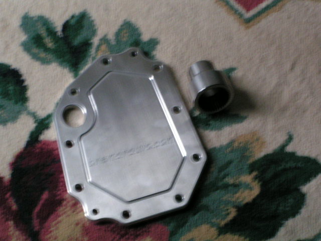

parts are here!@!! Parts are here... looking good!!! (IMG:http://www.914world.com/bbs2/html/emoticons/smilie_pokal.gif)

fuzzy pics of the tranny pieces, didn't have my galsses

If Steve ultimately uses a fwd rear housing on his awd tranny with the two most rearward awd sections removed - I'd guess he would not need the plate - but would only need the sleeve??
d914
post Feb 10 2006, 02:39 PM
Post #236
Posts: 2,350
Joined: 12-July 03
From: Atlanta, ga
Member No.: 904
you remove the awd sections, thats why you need the rear plate. Otherwise there is a big whole going out the back for a drive shaft/universal....The two pieces needed are shown, plus it will shorten the tranny for a better fit...
I believe (IMG:http://www.914world.com/bbs2/html/emoticons/biggrin.gif)

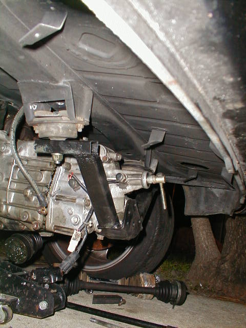

The way I see it from the pics in Steve's blog and his writtings is that he plans to remove both sections and us a fwd rear housing which would negate the need for the plate. The plate would be needed if only the last one section were removed?
Personally I think using the plate and removing only the last section would save sourcing out fwd rear housing and the space gained still may not allow a single muffler to be used. Probably best to run dual exhaust with short mufflers on either side of the tranny?
