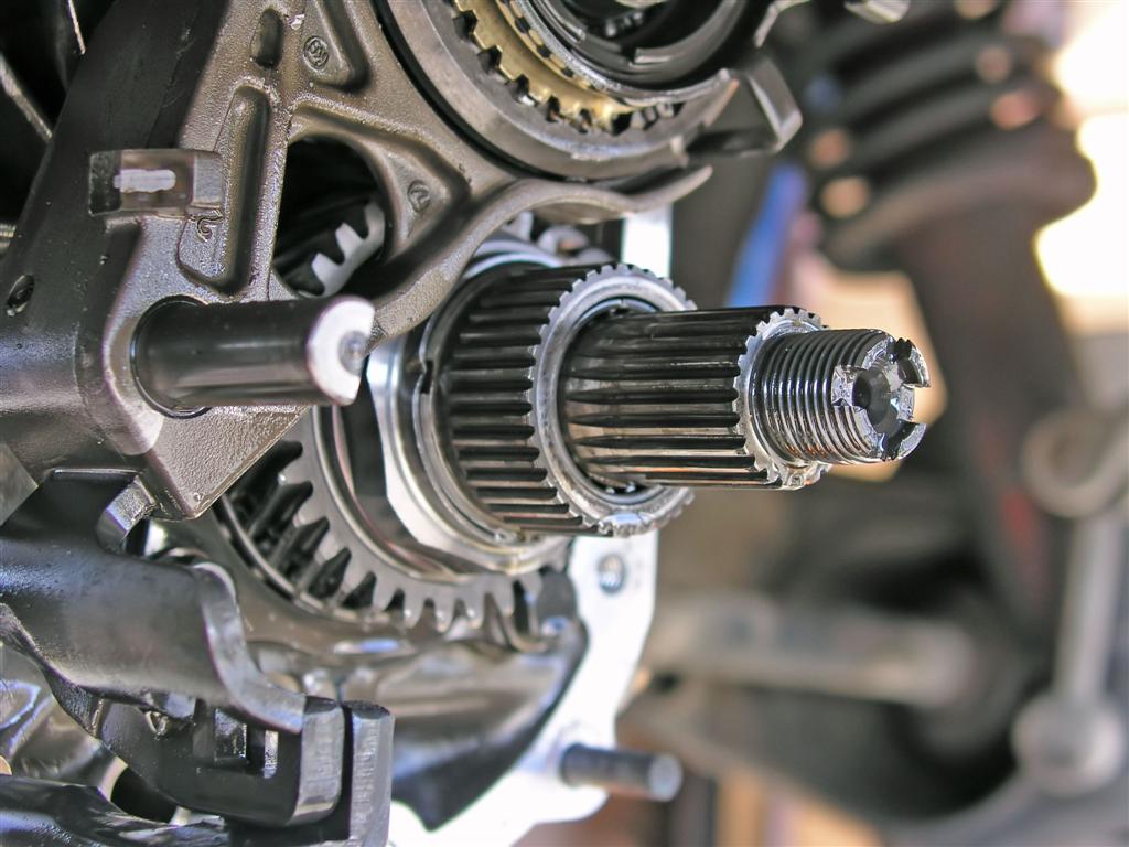

I've been reading back through this thread, and I've got an idea...
In this picture, the rod on the left is the one that controls the shifting (in/out, cw/ccw), right ? It looks like it is rather short, so that an extension of some sort is what actually protrudes from the rear of the Saker plate. (In fact, some of the other photos of the Saker plate installed didn't have a rod protruding, so I've pretty much convinced myself that this is the case.)
What I'm thinking about is cable shifters. A week or so ago somebody (I'm sure you guys saw it) posted a really sweet cable shifter design using a splined section from a (Suzuki Samurai ?) drive shaft. The biggest downside to that (or any other) cable shifter mechanism I've seen is the vulnerability to dirt and grime, and/or the need for a really good prophylactic. (IMG:http://www.914world.com/bbs2/html/emoticons/mueba.gif) So what I'm pondering is the possibility of putting the crucial bits of the cable shifter inside the transmission housing. That way the male/female spline section would not only be protected, it would be nicely lubricated as well. I'm kind of picturing a sleeve that goes over that control shaft (I don't know what it's called) and is fixed to it. This sleeve has the male splines on its outer surface. Then a female splined section fits over this, and has an arm that is actuated by a cable to provide the cw/ccw motion. A ball joint on the end of the male spline section can couple to a second cable for the in/out motion. So rather than having the control shaft extending through the rear plate, there would be two cables.
Sound crazy ? Maybe just crazy enough to work ?

Cool idea but (damb buts always ruin things) it's not that simple. Those do-dads on the bottom of the picture are also part of the shift linkage. There is sort of a rocker arm at the end of the shift extension rod. I think getting the cables inside of the transmission case is do-able and is a good idea..

Okay, gotcha.
I'll probably need to wait until (much) later when I've got a tranny to mess with to see all the issues, but in general it looks like there's room for putting the guts of a cable shifter in there.
One thing I'm wondering is wherther the cable itself can enter the case. It seems inevitable that tranny fluid would wick back along the cable and enter the jacket. We'd have to figure out if that's a problem or a feature (IMG:http://www.914world.com/bbs2/html/emoticons/biggrin.gif)
BTW, how does the standard control shaft pass through the Saker plate ? Is there a plastic bushing ? a lip seal ?

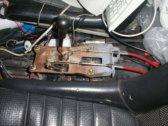

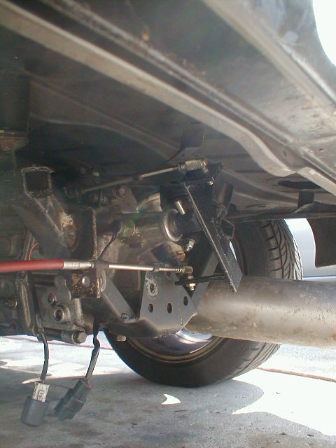

Here is my set up for the cable shifter

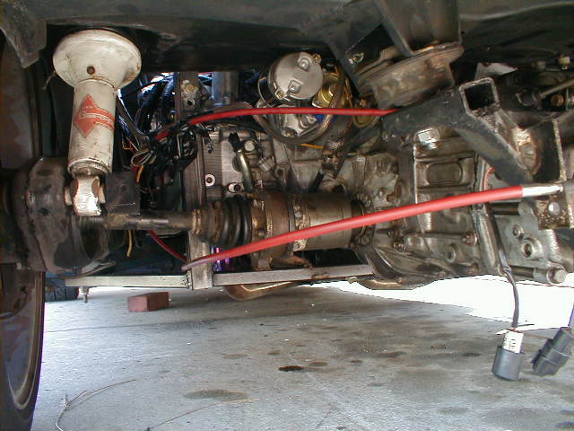

And my setup for the drive shafts. 924 shafts with 914 cv on outside and 924 cv on inside with 100 mm flange welded to subaru output.

Cool. I looked up 924 axles on car-part.com, and they look reasonable. Somehow just saying that the driveshafts come from a Porsche sounds cooler than from a VW bus -- does that make me a snob ? Anyway, I'm assuming you got the ones from the 924 Manual, not the Auto, right ? On the Auto the left and right are different.
Also, there was some question earlier in this thread about whether this setup would allow you drop the engine/tranny without removing the trailing arms. And the verdict is ..... ?
Unless I'm missing something, it looks like the 924 CV is bolted to the custom 100 mm flange w/ the same kind of bolts as we have on our teeners. I'm not sure why the procedure wouldn't be the same.

There is lots of room inside for a shifting mechanism.
The cables I am looking at have seals on them so trans oil leaking into them should not be a problem.
It's just a hole in the plate. The seal is in the center diff case.

I was asked a couple of questions on shifting. I am using a early mr2 shifter (see pic) and I have been driving it for about a week now. The shifter coming out of the transmission has very little travel but this setup is working good so far. I still have some adjusting to do and alot of tuning with msII. The gear ratios seem to be about the same as the 901.
