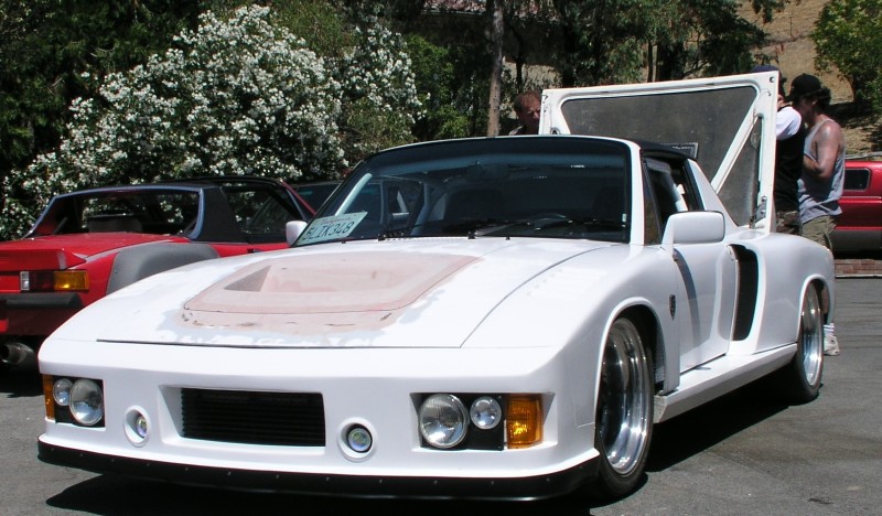

Like this one? He is in the bay area somewhere. I saw this at Mikes BBQ during the heat wave two summers ago. I remember when I left at 3 P.M. my trucks temp gauge said 114 degrees outside temp and it hit 117 on the way home!
Steve

hey guys, the white 914 with the body kit in the above picture is my car, i bought it a couple months back as a roller, the prevous owner had a SBC in her but after reading the info on the subaru engine and trans setup this just looks to cool to pass up, im a pretty good mechanic but having some kind of kit with all the bits and pieces already put together would be the ticket, looking forword to further progress, thanks

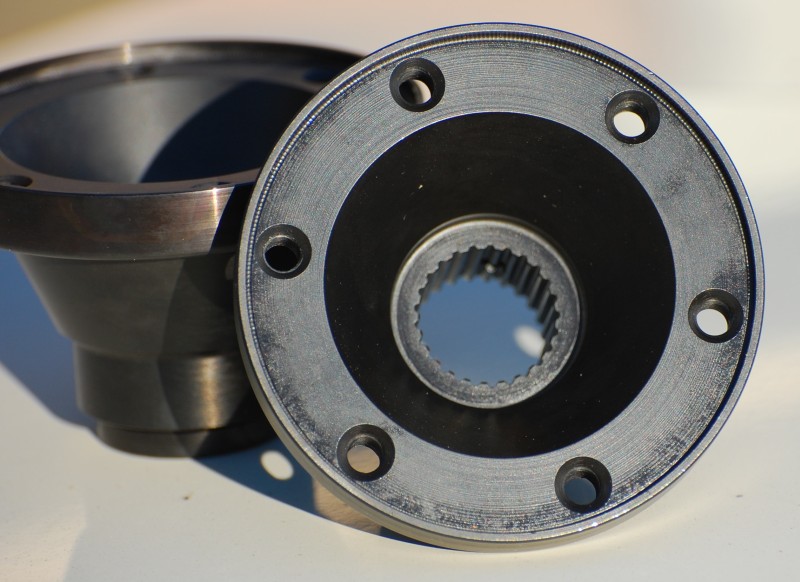

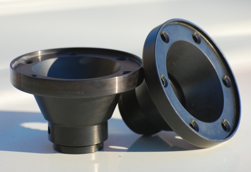

We came home from our vacation today and I found a nice little box with a pair of flanges in it. The parts look great. I will post pictures in the morning.
Steve

post Dec 31 2007, 05:16 PM
Post #458
Posts: 1,314
Joined: 27-January 05
From: Campbell, CA
Member No.: 3,518
Here are the pictures!
Porcharu
post Dec 31 2007, 05:17 PM
Post #459
Posts: 1,314
From: Campbell, CA
Member No.: 3,518
Another.

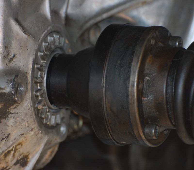

post Dec 31 2007, 05:19 PM
Post #460
Posts: 1,314
From: Campbell, CA
Member No.: 3,518
And the money shot. I have 5 people that have PM'ed me with orders so far. I will be ordering very soon. If you want in on the deal PM me.
Steve
Before anyone asks - that is a junkyard Bus cv and I realize it is nasty and the trans is dirty.
