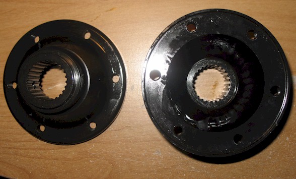

Got my "magic flanges" from ups today, really, really nice thanks for the group buy (IMG:style_emoticons/default/biggrin.gif)

Wooohoooo!!! My "magic flanges" came today!!! (IMG:style_emoticons/default/piratenanner.gif) (IMG:style_emoticons/default/aktion035.gif) (IMG:style_emoticons/default/beerchug.gif)

So - what do you think of them???? Worth the wait and $$$?
EMRoadster
post Sep 1 2009, 06:33 PM
Post #634
Autocrosser
Posts: 65
Joined: 20-August 05
From: Tucson, AZ
Member No.: 4,620
QUOTE(Porcharu @ Sep 1 2009, 10:22 AM) *
QUOTE(EMRoadster @ Aug 31 2009, 06:05 PM) *
Well, I haven't seen any of the first batch other than pictures.
But, YES, these things are a work of art!!! (IMG:style_emoticons/default/agree.gif)

I'm assuming since you're referencing SVXs and Autos that these are 25-spline adapters?
FYI in '93 and '94, the 1.8l FWD 5MT imprezas have 23 splines. if you try to put one of these flanges on one of those trannys, you're going to be very sad. I think '95 FWD imprezas still had a 1.8l, but I know they used 25 spline axles, so it's not specific to engine size.

QUOTE(Numbchux @ Sep 6 2009, 12:38 AM) *
Wow!!! Just read through this, and am extremely encouraged.
If I end up building a 914, I'll definitely be getting a pair of these!! Any news on the cable-shifter setup? That would be my next hurtle.....although I've got this FWD Auto trans from a '92 legacy, and have been in touch with a guy who reflashed the ROM in the TCU so he could have full-manual control over it with paddles.....
question, as I'm fairly new to VW/porsches. would this speed sensor ring bolt up to these flanges?
You can just use a stock Subaru speed sensor for the trans. No need to make anyting new. The speed sensor just replaces the speedo cable, easy cheap and it works.
Steve
