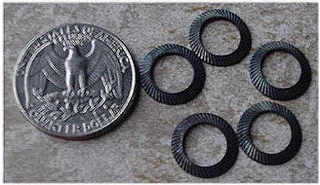

You should replace the washers under the CV bolts. They are a special type. New bolts will not hurt either. I've seen too much damage from loose drive shafts beating everything within reach. Cheap insurance.

the washers are crush wavey washers.

schnorr washers

The CV washers look like this

how many washers do i need per side?
would bap have these things?
what do the cv gaskets look like and do you think bap would have those?

QUOTE (shaggy @ Nov 6 2005, 10:18 AM)
how may do i need?
one per bolt. ill let you figure out how many bolts are on each CV.
go to pelican parts . com and click on CV gasket. im sure they have a picture. hell, google canbe your friend too (IMG:http://www.914world.com/bbs2/html/emoticons/smile.gif)
