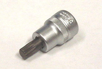

this doesnt look like a 6mm hex...it's an 8mm 12-point star bit:
Mueller
post Nov 6 2005, 01:32 PM
Post #30
914 Freak!
Posts: 17,157
Joined: 4-January 03
From: Antioch, CA
Member No.: 87
QUOTE (dlo914 @ Nov 6 2005, 11:56 AM)
mine are hex as well, new factory replacements (well, new as in from the dealer)
