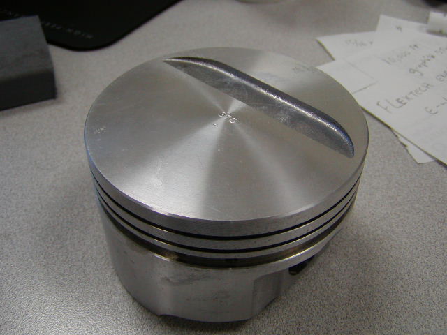

Does anyone have a set of 2.0 Euro pistons out of the box and could give me a measurement.
I am looking for top of piston to top of ring #1.
A pic would help too...
Thanx

post Nov 10 2005, 06:53 PM
914 Freak!
Posts: 17,155
Joined: 4-January 03
From: Antioch, CA
Member No.: 87
I measure 6mm on this one......
r_towle
post Nov 10 2005, 06:56 PM
Custom Member
Posts: 24,705
Joined: 9-January 03
From: Taxachusetts
Member No.: 124
thanx,
While your there...
Top to center of pin please....
Rich
Mueller
post Nov 10 2005, 06:57 PM
914 Freak!
Posts: 17,155
From: Antioch, CA
Member No.: 87
35mm
hopefully someone else will confirm these numbers....
r_towle
post Nov 10 2005, 07:08 PM
Custom Member
Posts: 24,705
From: Taxachusetts
Member No.: 124
its ok...I was just measuring the dished top ones.
The top to pin seems to be the same, top to ring is a little bit over 7mm
So, I could take a bit off the top of the dished pistons to flatten them out and still stay away from the ring a safe distance...
Now, on a stock engine, I heard there is a head gasket, that if removed, I could get the CR into the same range as the Euro pistons...maybe not exactly the same, but closer than stock....
