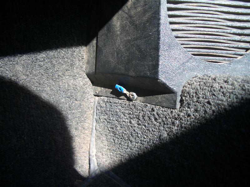

This is the passenger speaker.
Is the blue thing in the bottom of the picture a ground?
What was originally hooked up to it?
Thanks,
Bryce

not stock. someone tried to use it as a ground it appears

QUOTE (Aaron Cox @ Nov 10 2005, 06:25 PM)
Yup.. bad choice too. (IMG:http://www.914world.com/bbs2/html/emoticons/blink.gif)

Some DPO used the speaker box screw as a ground for some unknown electrical device. Poor choice of a ground point, el cheapo amateur connector, poorly crimped; a good sign that there may be more problems under the dash. The Cap'n

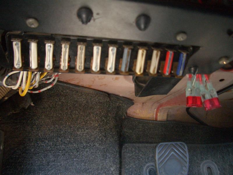

Apparently there was some re-wiring done. (Note the new bus fuses in this picture.) (Also, the stupid SO% didn't have the sense to replace the fuse cover.... I spend 5 mins picking up fuses every morning...)

Check resources, parts and products for some great after-market fuse blocks.
