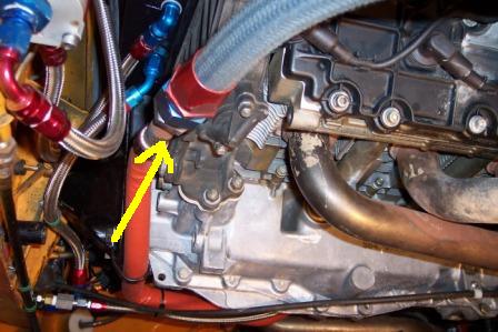

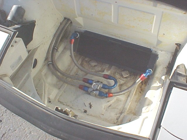

Trekkor,
Could you post (repost?) pics of your various lines and connections? Tank to motor etc. What make and size cooler did you use?

Setrab approx 23wx2dx5t (IMG:http://www.914world.com/bbs2/html/emoticons/ohmy.gif)
Earl's line and fitting
mocal t-stat
Tank is a thick walled large capacty Vellios in the stock location
KT
Trekkor
post Nov 10 2005, 11:26 PM
I do things...
Posts: 7,809
Joined: 2-December 03
From: Napa, Ca
Member No.: 1,413
how it all started for me at least!
Dan, I bet you're getting excited, huh?
KT
