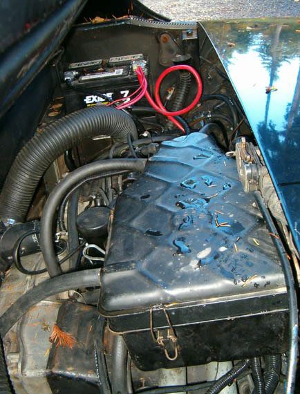

After many years of being apart from a 914, the bug is hitting me again..hitting hard...
I've come across a 72 914 that appears to be a 1.7, but the current owner has almost no history on the car, and told me that he recently replaced the starter with a 911 starter because a 914 starter wouldn't turn it over. The engine doesn't currently run, but the body is in excellent condition, so I'm thinking it might be worth a few bucks to get it running again.
Any clues on how to tell for sure which engine is installed? My bet is a 1.7, but the 911 starter story has me wondering...
I suppose I could ask the guy to count cylinders and make sure it's a four, but that still leaves the possibility of a 2.0 sitting in there...
Thoughts and advice?
Attached are a couple of pics if you want to look for clues...
Thanks,
Mark

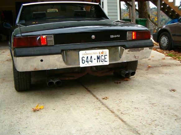

mlanders
post Nov 11 2005, 09:10 AM
Posts: 6
Joined: 6-November 05
From: Winston-Salem, NC
Member No.: 5,076
Rear view..
ClayPerrine
Posts: 16,542
Joined: 11-September 03
From: Hurst, TX.
Member No.: 1,143
The Fuel Injection is a 2.0 setup. The 1.7 uses a different air cleaner assembly.
It should be a 2.0, but check the case numbers.

Hard to tell...it has a 2.0 aircleaner (it is a /4) but that doesn't mean it is a 914 2.0.
Look at the intake manifold if it has 3 bolts to the head it's a 914 2.0...4 bolts means it's a 1.7/1.8 or a bus engine.

thanks...I'll see if the guy can count bolts for me, or maybe find a case number. I've asked for pics on rust areas...car looks amazingly clean. He said it was a strong runner until a week ago when it just wouldn't start.

It's definitely a 2.0! The guy wants $1500 for it, and no rust in sight anywhere.

from the little part i see, the battery tray looks good too.
