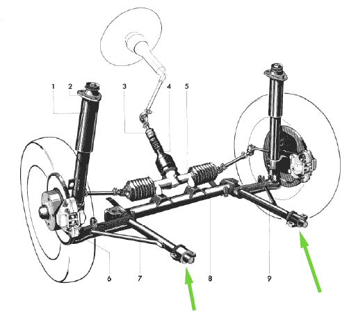

McMark
post Nov 12 2005, 07:50 PM
914 Freak!
Posts: 20,180
Joined: 13-March 03
From: Grand Rapids, MI
Member No.: 419
The front of the A-Arm, about 6 inches back from the very front of the car. One on either side.

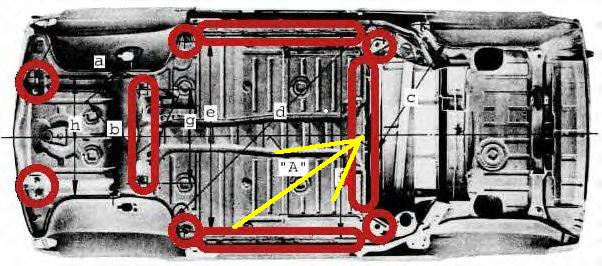

qa1142
post Nov 12 2005, 08:36 PM
Whiplash
Posts: 1,514
Joined: 1-June 04
From: Lake Zurich, Illinois
Member No.: 2,140
I have this picture sealed in plastic in the garage
lift points or support points in red
Allan
post Nov 12 2005, 08:55 PM
Teenerless Weenie
Posts: 8,373
Joined: 5-July 04
From: Western Mesopotamia
Member No.: 2,304
QUOTE (McMark @ Nov 12 2005, 05:50 PM)
That's what I do. If I need to get at the suspension I use the donuts.

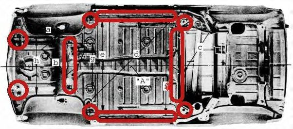

post Nov 12 2005, 08:58 PM
Teenerless Weenie
Posts: 8,373
Joined: 5-July 04
Member No.: 2,304
This part is iffy..
jd74914
post Nov 12 2005, 09:07 PM
Its alive
Posts: 4,852
Joined: 16-February 04
From: CT
Member No.: 1,659
why is the engine mount bar iffy? If you trust it to hold an engine in why wouldn't you trust it to jack with?
Hammy
post Nov 12 2005, 09:15 PM
mr. Wonderful
Posts: 1,827
Joined: 20-October 04
From: Columbia, CA./ Tuolumne
Member No.: 2,978
QUOTE (jd74914 @ Nov 12 2005, 08:07 PM)
it's skinny...
sgomes
Electric Member
Posts: 815
Joined: 6-May 04
From: Campbell, CA
Member No.: 2,029
That's not the engine mount bar! (IMG:http://www.914world.com/bbs2/html/emoticons/laugh.gif)
Aaron Cox
post Nov 12 2005, 09:19 PM
Professional Lawn Dart
Posts: 24,542
Joined: 1-February 03
From: Corona, CA
Member No.: 219
QUOTE (sgomes @ Nov 12 2005, 08:15 PM)
yep. your a foot forward at the firewall kiddo

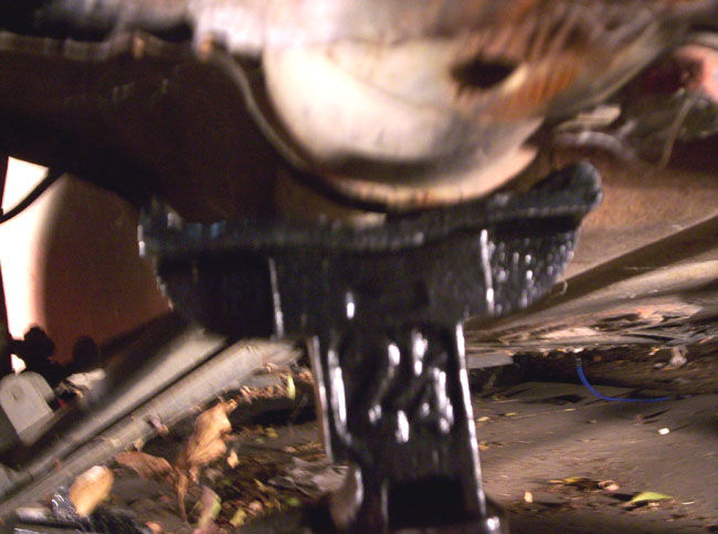

Hammy
post Nov 12 2005, 09:52 PM
mr. Wonderful
Posts: 1,827
Member No.: 2,978
So..... like this?
McMark
post Nov 12 2005, 11:27 PM
914 Freak!
Posts: 20,180
Joined: 13-March 03
Member No.: 419
That'll do.
I'll agree with the iffy part in the picture above. Mount bar is okay on late cars, not such a good idea on early cars. The iffy part circled above is a double walled section that would give more support so it might be okay, but I'd still use one of the other options.
I regularly hold the rear up by putting a jackstand on the tube portion of the rear control arm.
