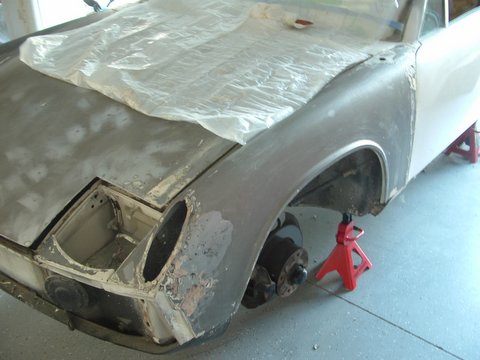

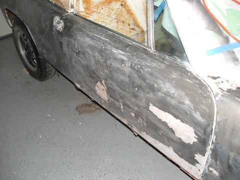

It's been a serious pain in the A double S but in the long run, it will be worth it...
Just thought I would share a few pictures. I must have removed 50 lbs of bondo... I think the PO had stock in the stuff..
Still not quite sure why it was used? The doors look straight... Anyone have any thoughts? Other then an accident, I can't think of any other reason.

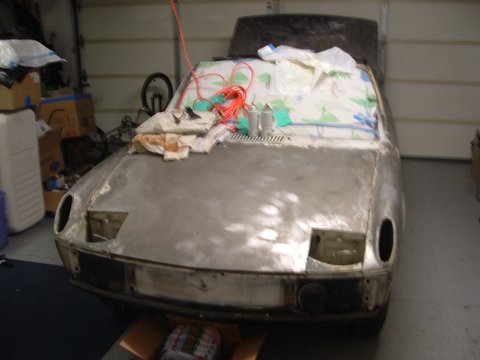

Another

One more.
Thanks to MattR and Twystd1 for the great advice.. (IMG:http://www.914world.com/bbs2/html/emoticons/pray.gif) (IMG:http://www.914world.com/bbs2/html/emoticons/pray.gif) (IMG:http://www.914world.com/bbs2/html/emoticons/pray.gif)
If it wasn't for you both, I would still be stipping the paint on the hood!!!

Easy...Since the car is outside, it will work even better with the weather being warmer. Put a nice layer down and drape a plastic drop cloth over it. Let it sit for a few hours. According to Matt the longer the better. My car had about 18 layers of paint, so after about an hour, I put another coat on. Putty knife and elbow grease...

Aircraft stripper, Disc sander and the hard spots and edges.. It's easy, just time consuming,,

On the bondo, the left front corner looks like it had some accident repair done on it. However, the factory applied a fair amount of bondo to these cars, too. Karmann really was something of a hand-built kind of shop, and most of the cars that left there had some bondo under the paint to clean them up.

I would bet that when you shoot a light coat of primer on those doors you will find out why there was bondo all over it. I am thinking your doors are not quite as straight as you think they are. Many shops in the 70's and 80's and even still today use body filler to make the doors perfectly straight.

At first I thought that since there seems to be paint coat on top of paint cost. Perhaps they used the bondo to fill the cracked layers between each coat. The bondo dhow is about 1/2 of what there was.I was coming off in sheets, when I soaked it with stripper and then took the putty knife to it...
Scott... Here is a stuoid question: I am thinking I might be able to paint it in the next month or so, but with X-mas coming I might need to wait. Should I be concerned with moisture? I know I'm not talking aobut 6 months on the East coast, but after the work I have put in, it does worry me. If so should it be primered?
I don't have a spray gun, so the quality of the paint job would be poor at best. Second if I should primer it, what type of primer should I use?
