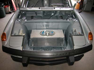

installing fuel cel in forward compartment, was thinking about installing vent in the right forward parking light cutout.
where do other 914's and 911's with cel up front usually put the vent?
thanks,
dr

scotty   vent to the passenger compartment :evilgrin: ?   Aug 16 2003, 09:20 PM
ChrisReale   Or vent it to your helmet :o What about using the...   Aug 16 2003, 10:59 PM
synthesisdv   so if we go thru the firewall, can it vent down un...   Aug 18 2003, 05:37 AM
john rogers   If I remember correctly, the SCCA GCR's call f...   Aug 18 2003, 10:40 AM
synthesisdv   the cel is fuel safe's top of the line pro cel...   Aug 18 2003, 11:07 AM
Brad Roberts   Too much effort. Run the line from the tank thru t...   Aug 18 2003, 12:51 PM
synthesisdv   thanks brad, sounds good accept that the SCCA rul...   Aug 18 2003, 01:14 PM
