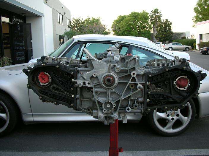

Last friday 2/24 cleaned 3.6 long block, looks purty good in front of a 993 huh? (IMG:http://www.914world.com/bbs2/html/emoticons/biggrin.gif)

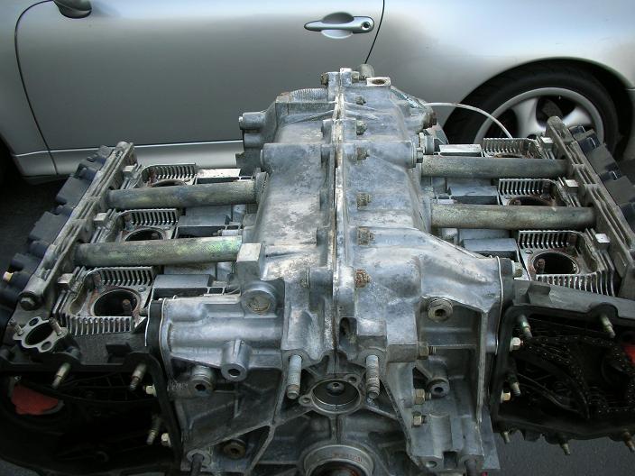

Member No.: 3,165
02/24/06 Under side of engine, gone is 60k km of cosmoline mixed with canadian dirt and gunk, she's clean as a whistle. (IMG:http://www.914world.com/bbs2/html/emoticons/clap56.gif)

Eric Taylor
post Mar 1 2006, 11:29 AM
Post #133
Posts: 909
Joined: 1-June 03
From: Bend, Oregon
Member No.: 770
(IMG:http://www.914world.com/bbs2/html/emoticons/agree.gif) One of my favoriate threads !. Are you changing the cams out? Looks like your at least replacing them? How much power is this sucker gona have? (IMG:http://www.914world.com/bbs2/html/emoticons/biggrin.gif)
Eric
drewvw
post Mar 1 2006, 11:45 AM
Post #134
new england car guy
Posts: 1,632
Joined: 24-February 06
From: Boston, MA
Member No.: 5,630
that is one sweet looking power plant....the 993 behind ain't too shabby either.
Yes, I have Web Cam RS cam for 993 w/ hydralic lifters,........ how much power? I don't have a clue, I have talked to Steve Wong (911chips.com) and my ECU is one of the Euro versions he can program. The plan is to dyno this baby to tune the chip (IMG:http://www.914world.com/bbs2/html/emoticons/biggrin.gif) .............Other engine mods are light flywheel, match flowed injectors, 1 3/4" headers, B&B 2 in, with 2- 3" out muff.

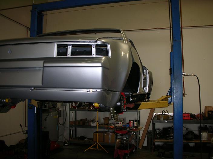

I will post some pics soon on the work we did last night, we installed some of the body panels: front & rear CF hoods, rear bumper & custom steel valence with flare to match GT flare, the rear looks just plain sick!!!!!!!! kinda looks like a 930 a$s end. (IMG:http://www.914world.com/bbs2/html/emoticons/rolleyes.gif)

02/28/06 front & rear CF decklids installed. Rear bumper & lower valence installed. Rear end shot, do these flares make my butt look big? (IMG:http://www.914world.com/bbs2/html/emoticons/huh.gif)

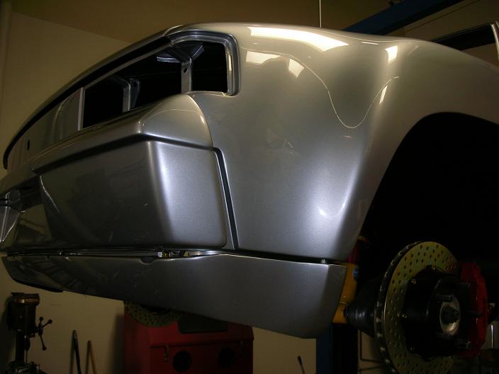

02/28/06 right rear quarter panel shot of new flared wide a$s steel valence install (IMG:http://www.914world.com/bbs2/html/emoticons/biggrin.gif)

Close up of GT flare to lower valence metal work, it turned out great (IMG:http://www.914world.com/bbs2/html/emoticons/biggrin.gif) Just wait til U see the rocker panels installed (IMG:http://www.914world.com/bbs2/html/emoticons/ohmy.gif) (IMG:http://www.914world.com/bbs2/html/emoticons/ohmy.gif) (IMG:http://www.914world.com/bbs2/html/emoticons/ohmy.gif) It really looks like a 930 and 914 mated.
