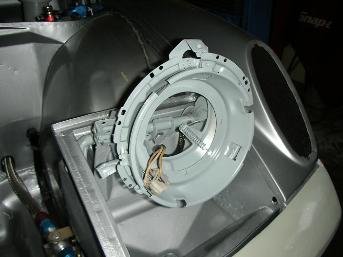

04/13/06 got some little things done, bead blasted and painted & installed headlight buckets.

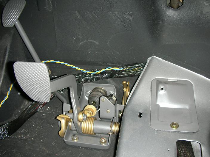

04/13/06 Finish install of brake/clutch pedal assembly. Had to wait for a special plunger for the 23mm MC.

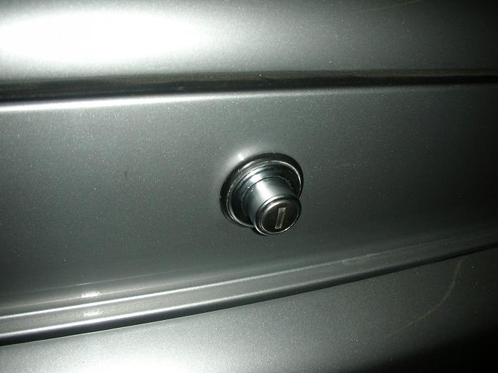

04/13/06 Installed rear trunk latch assembly. Actually keyed it to match the ignition key!

Perfect timing, thanks for posting the picture of your headlights, I was trying to figure out how to put mine back together. (IMG:style_emoticons/default/smile.gif)
That pedal assembly is awesome, was that done by Eric? your car sure looks good, your're doing a great job on it. (IMG:style_emoticons/default/smilie_pokal.gif)

That pedel cluster turned out exactly like mine...sweet!

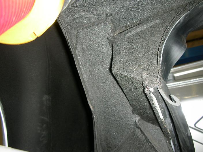

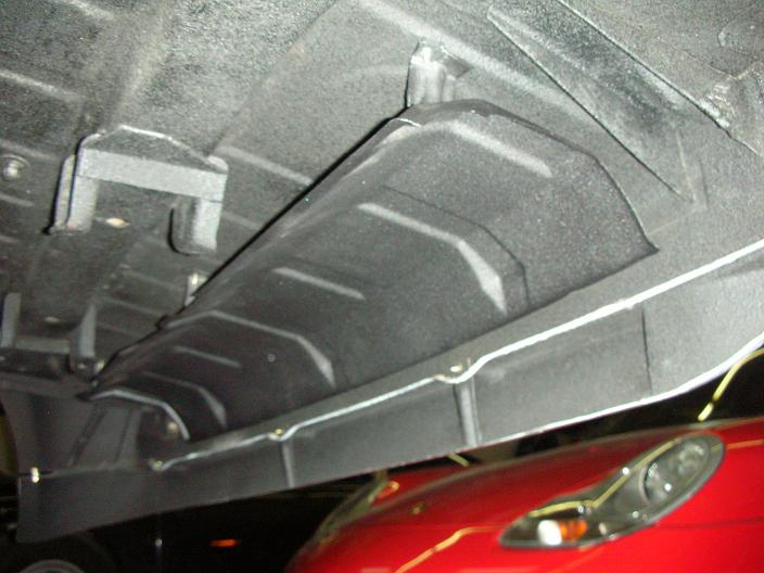

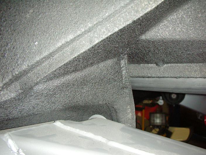

914forme: rear toe plate stiffener, some details of this better pictures etc...
pic 1 Inside shot of toe bracing, 3/16" steel
pic 2 Upper plate bracket, 1/8" steel
pic 3 Outside bracketing, 1/8" steel

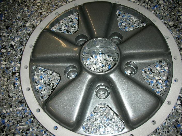

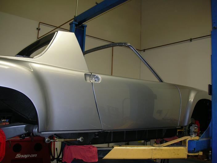

08/02/2006 Finally some new progress, have not worked on car since April (been very busy at work) just rec'd HRE311 wheel centers that have been powder coated a luscious "cosmic grey metallic" pics don't begin to show how good they look. (IMG:style_emoticons/default/biggrin.gif)

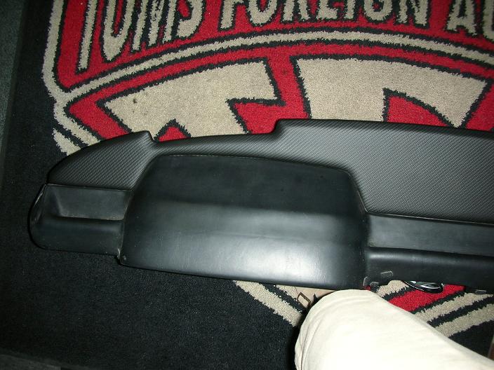

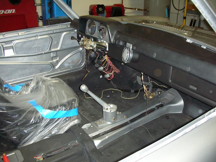

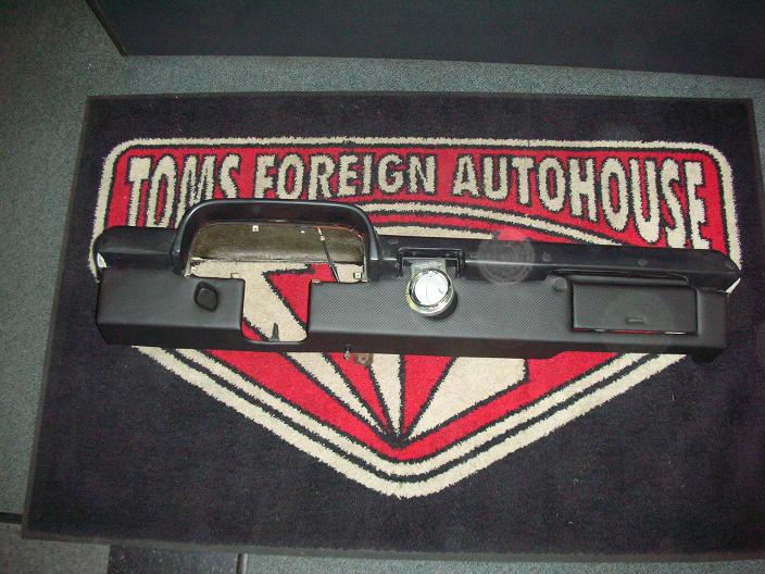

08/02/2006 Dash has been reworked, radio & vent controls removed. Have new vent where the ash tray was made from a 03 ford f150 truck vent angled toward the driver. This will be powered by a 12v boat bilge blower that will be mounted under the dash.
The dash vinyl has a carbon fiber weave effect. (IMG:style_emoticons/default/blink.gif)

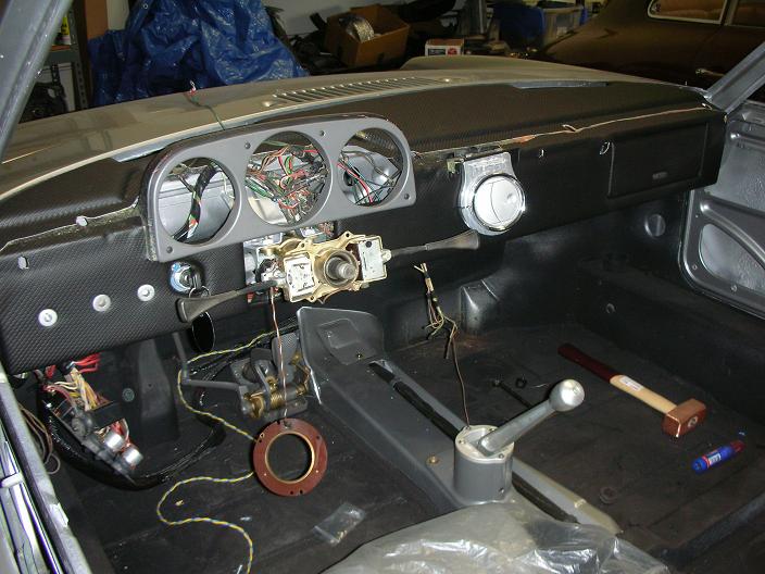

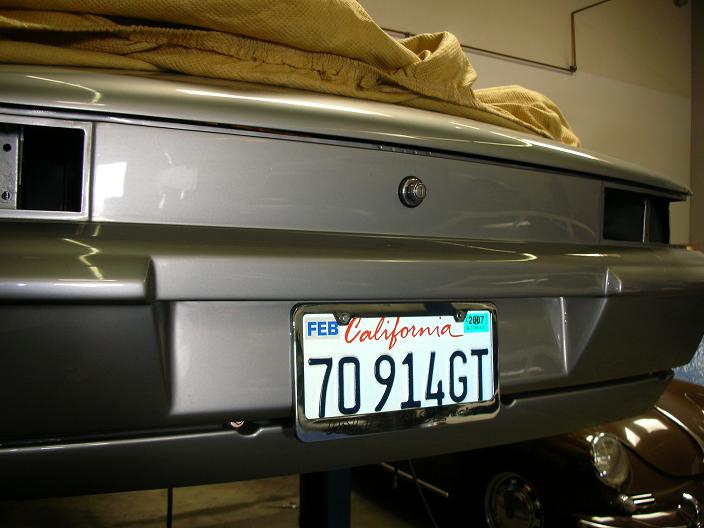

pic 1 Me in the cockpit, taken 9/14/6. (IMG:style_emoticons/default/biggrin.gif) (with harness on for broken collarbone) (IMG:style_emoticons/default/mad.gif)
pic 2 New lic plate.
pic 3 dash installed.

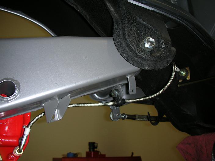

pic 1 brake line installed
pic 2 dash complete
pic 3 doors installed, major bummer here door gaps are shiite. the car seems to have moved while installing engman inner long kit. both doors will have to reworked and repainted to get gaps right. (IMG:style_emoticons/default/mad.gif)
