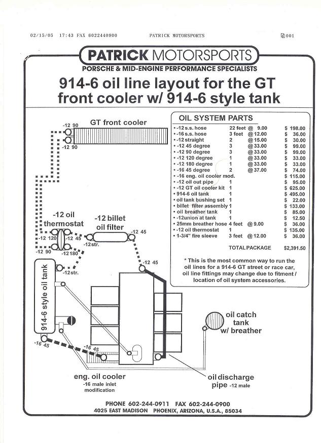

post Oct 1 2006, 12:38 PM
Post #196
Posts: 20
Joined: 5-December 05
From: san diego
Member No.: 5,239
QUOTE(Marv's3.6six @ Jan 8 2006, 07:47 AM) *
1/7/06 Time to make a big hole.
Hey sorry to bother, but did the guys from Patrick Motorsports send u a patter or any instructions to install the GT oil cooler??? Cuz i bought one and got nothing and i dont want to try and do it without any instructions.
Could you give me some feedback on how to install this thing or scan the instructions for me??? i have been trying to get this guys from PM to send me some instructions and some bolts for my flywheel but no luck....
Its just not good cuz i cannot put my engine and tranny together and i cannot do any progress on my car, thats sh...ty
Anyways, any help would be greatly appreciated!!
Fernando
Maltese Falcon
post Oct 1 2006, 04:25 PM
Post #197
Posts: 5,473
Joined: 14-September 04
From: Mulholland SoCal
Member No.: 2,755
Fernando...stop stuttering (DBL post).
When I received the last 3 fr coolers from them there were NO instructions in the boxes. I install the coolers with the in/ out ends on the right (pass side) for T4 eng...and the left (driver) for a six. Then cover it up with a GT (aftermarket) shroud- or fab one.
I need to put up some more pics on my 2.0 build, but Trekkor should have this jpeg on his build history--check archives .
EZ job !
Marty
Marv's3.6six
post Oct 2 2006, 08:27 PM
Post #198
Actual member 7"
Posts: 695
Joined: 22-November 04
From: Huntington Beach, Ca.
Member No.: 3,165
Here ya go, I knew I had this at work. It is self explanatary. (IMG:style_emoticons/default/idea.gif)
PRS914-6
post Oct 2 2006, 08:44 PM
Post #199
Excellence Magazine Project 914 3.6
Group: Retired Members
Posts: 1,278
Joined: 20-May 06
From: Central California
Member No.: 6,031
The diagram may or may not be accurate for his installation. For instance, why add another filter? On a 95 3.6, that would give you 3 filters. I ran my lines down the right, not the left and installed the thermostat very close to the scavenge side of the pump on the right side of the motor mount. Very clean that way
Marv's3.6six
post Oct 2 2006, 11:38 PM
Post #200
Actual member 7"
Posts: 695
Member No.: 3,165
QUOTE(PRS914-6 @ Oct 2 2006, 07:44 PM) *
IMO the billet filter is optional, Jim Patrick builds his race cars with this filter so if you blow an engine you won't send all the particulate matter throughout your oil cooling system. To each his own on which side to run the lines, seems to me if the oil tank is in the factory location then why cross the car to the opposite side and use more -12 line than neccessary? I chose left side, like the factory cars and put the T stat up by the oil cooler just cuz I saw race cars setup that way and it looks good there. The diagram shows the basic layout of the lines and connectors needed to install in a similar fashion to the factory GT's.
