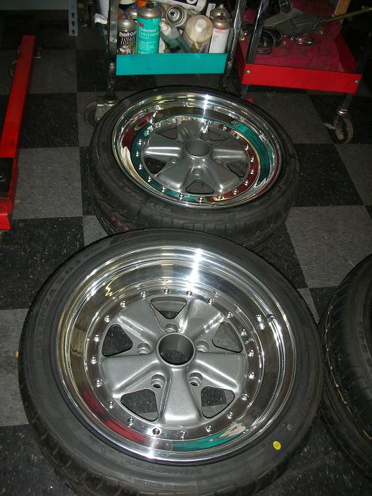

Buh-ling Bling! Wheels are done, Thanks Al Reed. HRE311's centers powdercoated cosmic grey & lips polished! (IMG:style_emoticons/default/biggrin.gif) Looks wicked!

OOOOOHHHHH, Those are beautiful (IMG:style_emoticons/default/drooley.gif) (IMG:style_emoticons/default/drooley.gif) (IMG:style_emoticons/default/drooley.gif)

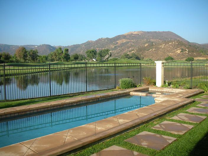

Hey check this out, I woke up to find my neighbor, a 3' tall Heron, standing on my back fence! (IMG:style_emoticons/default/biggrin.gif)

Lucky you. Every once in a while I look out my window to see a heron standing on the edge of my pond...watching my koi. (IMG:style_emoticons/default/mad.gif)
Haven't seen it in a while though. I think something may have happened to him (IMG:style_emoticons/default/ar15.gif) (IMG:style_emoticons/default/confused24.gif)

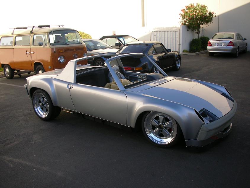

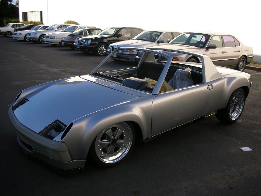

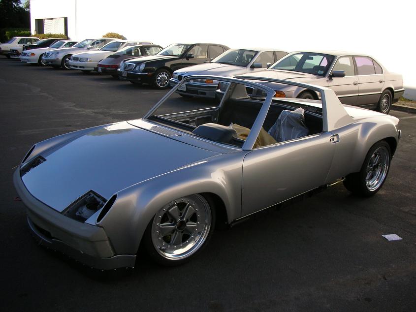

(IMG:style_emoticons/default/rolleyes.gif) She's a roller, kindof.......what you guys think? Still a long way 2 go.

From: Granger, IN
Member No.: 1,536
way cool!

That is looking great Marv!

It's going to sit sooo nice. Really coming out great.
OK, OK... we all officially hate you (IMG:style_emoticons/default/biggrin.gif)
Your car sucks and so does your view. I'll bet you married a troll as well (IMG:style_emoticons/default/lol3.gif)
Marv, all in jest of course. Looking great. (IMG:style_emoticons/default/smilie_pokal.gif)

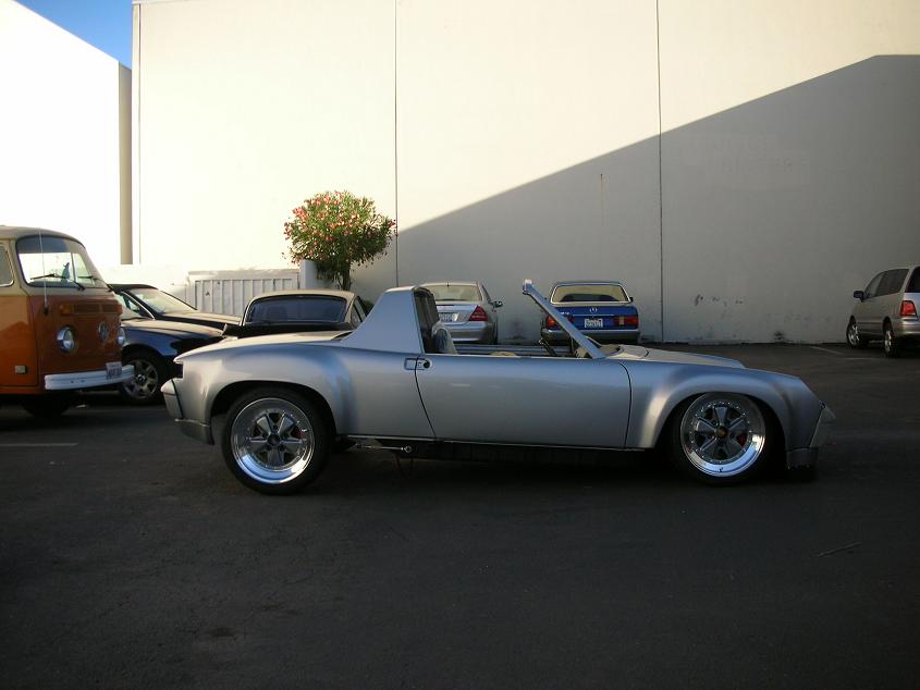

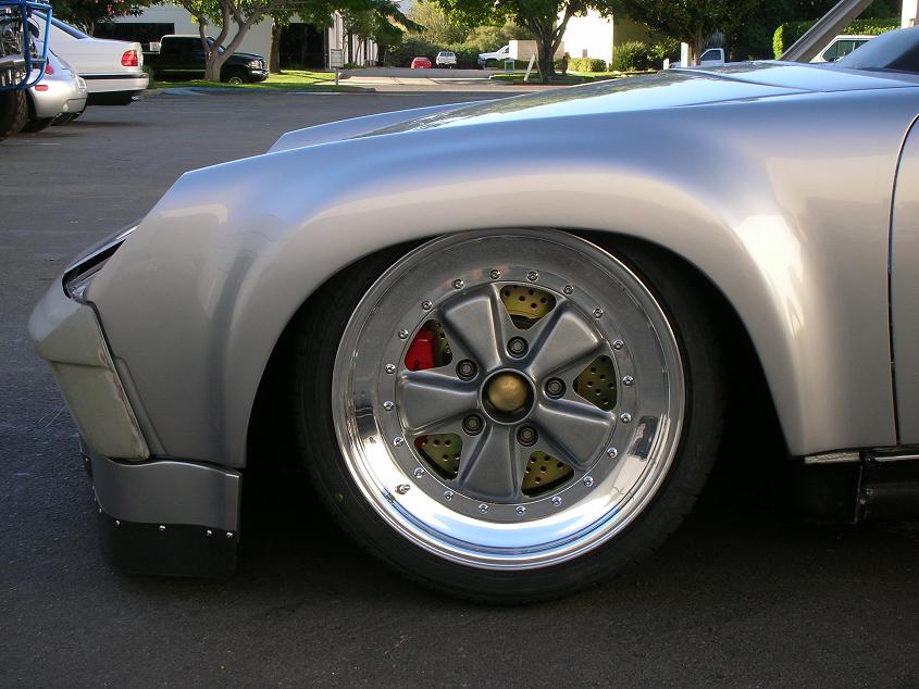

The photo above of the front wheel reminds me of a funny car front end, the body is so low over the tire. (IMG:style_emoticons/default/idea.gif)
I think your car looks great. This thread has been really enjoyable. More photos, please. (IMG:style_emoticons/default/laugh.gif)

Really cool....just add some wheelie bars!!! & The photo above of the front wheel reminds me of a funny car front end, the body is so low over the tire.
Yeah, it looks wicked in person, (IMG:style_emoticons/default/drooley.gif) but really there are no torsen bars in the front suspension right now. I am probably gonna run it pretty low.

Hey what size of brakes do you have?? i was looking to upgrade mine with some nice brembos but i dont know what size will fit, i have 15 inch fuchs, what size are yours and how big are the discs??
Data from Rennsportsystems: Brembo GTP Lightweight - 2 Piece Brembo Racing vented and cross-drilled or slotted 12.3" (313mmx28mm) rotor with Brembo Racing lightweight billet aluminum hats. These rotors are true "floating" rotors using Brembo’s Racing derived technology that allows extreme performance with very low weight and reduced rotating mass. Will work with 16" Fuchs.
