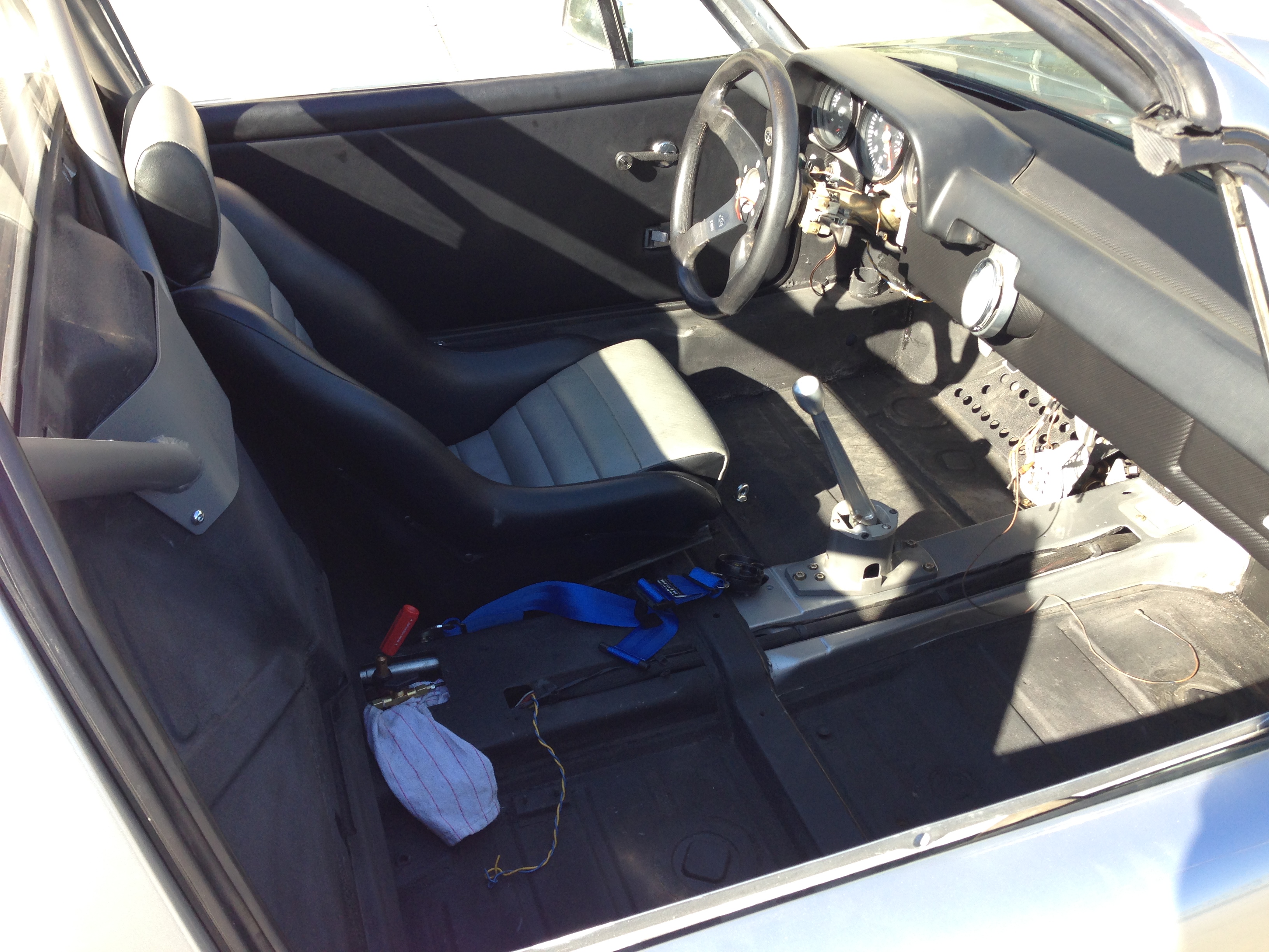

Interior shot. Love the Recaro seat. Still a bunch of work to do but a significant milestone to drive her. I will be back next Saturday to put more miles on, maybe some twisty roads.

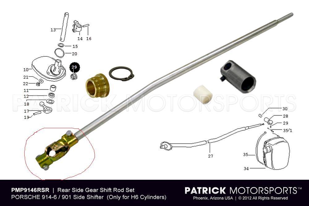

Saturday 1/4/2014 Drove another 30 or so miles shakedown. Results are 1 sore neck from cornering forces. 2 ran out of gas. 3 the linkage for the 915 gear box needs work. After many many shifts to brake in the tranny, rowing thru the gears over and over it became difficult to find gears, sometimes first gear was hard to find sometimes it would not go into third, after an hour or so most gear were sloppy to find and fourth gear would not work at all and it would pop out of first.
I think the issue is the shift rods are rotating slightly in the "universal apex joint" I believe the solution will be to drill and pin the clamps.
Don at PMP has said this will be the best solution. Next week more shakedown runs. I hope to have the linkage issue fixed and so far none of the gauges are working. I have no idea how many revs I have been pulling. I can't wait to wing her out to red line.

i cant beleive i just found this thread. omg marv that car is beautiful. i had the same shifting problem in a baja i built. i pinned my linkage also. and i took a cut off wheel and grinded two slots 90 degrees of the pin holes. it helped to pinch the coupling to the shaft.

The Patrick linkage is unmitigated garbage - with a high price. Well, atleast a few years back it was. You have a velios as I recall, and I have a wevo 915, but the kits share parts. Here's how I fixed it:
wevo shift linkage
This was a fairly challenging job for a diy'er due to the exacting dimensions. Shifting in the neutral plane from 1-2 to 5-R amounts to 5mm of rotation as measured on ther input shaft to the box. And you need to allow for slop. So, if off by 1mm the 1-2 plane may become unreachable. At the same time you need to enter the 5-R lockout properly. I had to cut and reweld the shaft a couple times before I got it spot on.

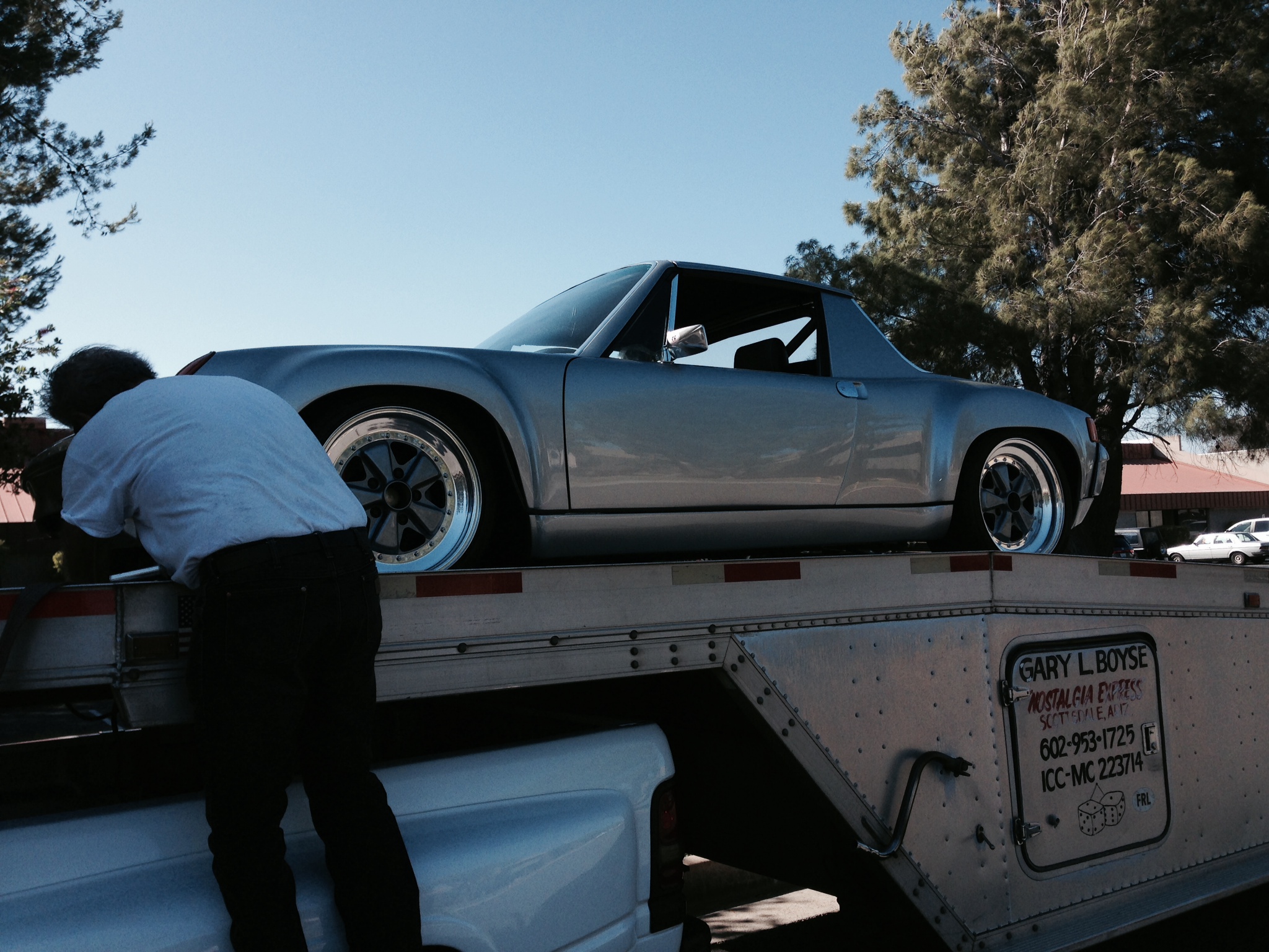

On July 4 the car was delivered to me, yay I was a happy boy. I now had the time to look at the car and admire her for her fineness. All was good in my world....except, as I had time to enjoy a few brews and look closely....almost everywhere I looked there was something not quite right. The list of strange work is long. There are issues with electrical, brakes, trans, steering and worst of all the suspension is totally wack.
Well guys what you see here is the car being loaded up for a trip to Phoenix. I am biting the bullet here and sending her to Jim Patrick @ Patrick Motorsports because I simply do not trust how the car runs drives and brakes. Jim has offered to go thru the car and make it right. Who knows what else Jim he will find that is screwy....I know this will co$t but WTF I am in too deep anyway.

Too nice a car not to have at 100%
How did you ever fix the door gaps?

QUOTE(mepstein @ Jul 15 2014, 06:27 PM) *
The door hinge mount area on the body was given some healthy lovin with a blunt object. (IMG:style_emoticons/default/smash.gif)

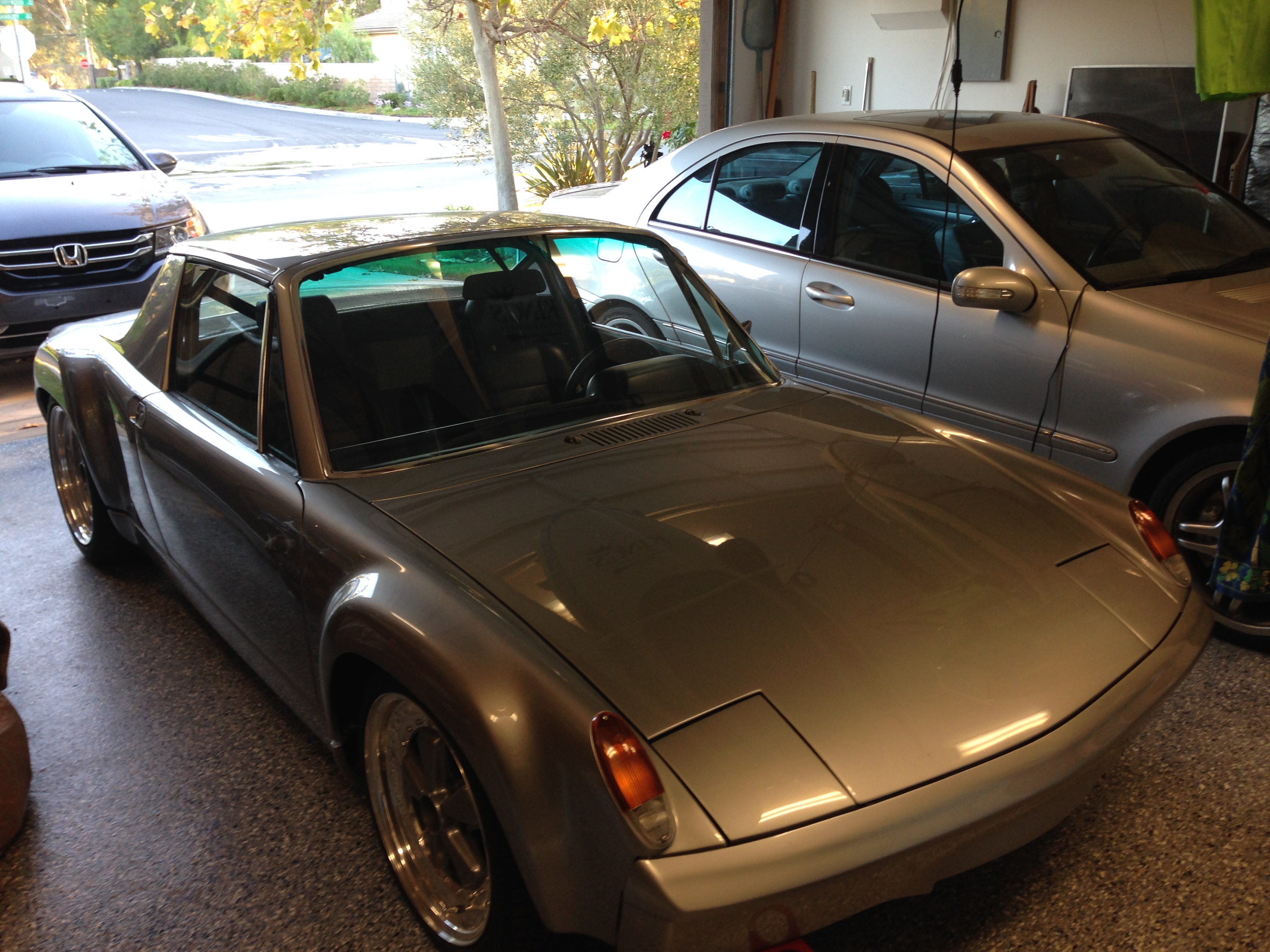

Back in my garage after a stay at Patrick Motorsports. JP sorted out many issues with the car. Now need to get new tires as the Bridgestones are 10 years old, have maybe 200 miles on them and hard as a rock. Thinking Toyo Proxes R888.
