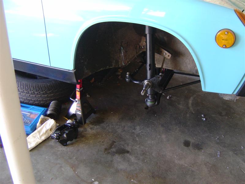

So I won these parts at the WWC05'. I didn't even know at first what they were, but it didn't take long for the flock to move in and start making offers. Well I decided to do some research and I started collecting parts.
The front end has all been removed including the steering assembly. Turbo tierods will be part of the rebuild. The current swaybar is a 22mm adjustable upfront and will remain. I am keeping the stock 18mm torsion bars and a-arms. Everything else is being refreshed or replaced. When the front is done the rear will be converted to 5 lug and a rear swaybar will be installed. Also if they can be obtained a set of Mueller bearings. So here is the first set of pictures and questions fo Mike. Attached image(s)

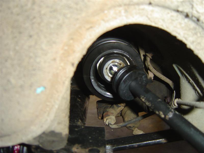

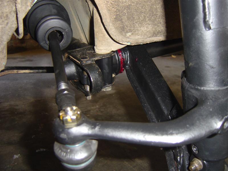

Leo Imperial I got lazy withposting, so here is an update of pi... Dec 31 2005, 08:25 PM
Leo Imperial With correct boots Dec 31 2005, 08:26 PM
Leo Imperial Full assembly Dec 31 2005, 08:27 PM
Leo Imperial Front completed and the rear now in progress. Dec 31 2005, 08:29 PM
Travis Neff Looking good Leo. The all black cookies and stanc... Dec 31 2005, 09:09 PM![]() ![]() |
