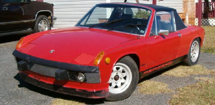

Yes the number in the windsheild and the passenger side wheel well match..
4742905917
Here are the photo's, was gonna clean it up first, but that could be a while.
I didnt know how to put the photos onto this message, so I linked them to my homepage..
http://webpages.charter.net/hatchersplace/.../new_page_1.htm
My Webpage
thx steve

QUOTE (ventilator01 @ Dec 1 2005, 11:32 AM)
[QUOTE]
like this
