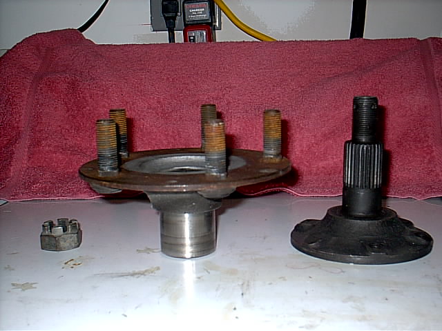

1969 hubs and stub axles will do the trick.
No spacer needed.
Mar7ck
Mar7ck
post Dec 3 2005, 07:39 PM
Posts: 44
Joined: 24-April 03
From: San Jose, CA
Member No.: 609
oh yeah that's a 1969 911.
Mar7ck
post Dec 3 2005, 07:44 PM
Posts: 44
Joined: 24-April 03
From: San Jose, CA
Member No.: 609
This is what it looks like!!!
Try it on your car first (IMG:http://www.914world.com/bbs2/html/emoticons/laugh.gif)
Film at 11:00 (IMG:http://www.914world.com/bbs2/html/emoticons/popcorn[1].gif)
